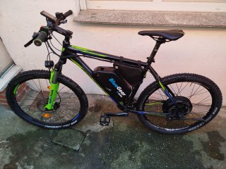

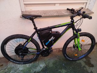

This was my previous bike, which was stolen. Here, almost everyone are using the same setup, mtb with cheapest chinese rear dd hub advertised as 1000w, that S830 display and the biggest battery they can afford or frame can take. We are all using throttle only, I don't want pedal assist sensor. And there is no legal issues yet, you can make whatever you want. Some guys are using 2-3 kw but they swap batteries every two hours...
I would like like to have a little bit more power and top speed than my previous bike, I linked some 1500-2000w kits from aliexpress at my first post, but the guy who makes batteries says 1500w motor will have less range than 1000w motor, even at my usual 15-20 mph riding speed.
For higher speed you better choose a battery with higher voltage.
That's nonsense. The efficiency of the motors will be quite the same. Of course, if you are riding faster, you will need more power, so the consumption will increase, the range will decrease. But this has nothing to do with the motor power. Riding 20 mph with a 1000W motor will need the same power from the battery as riding 20 mph with a 1500W motor.
