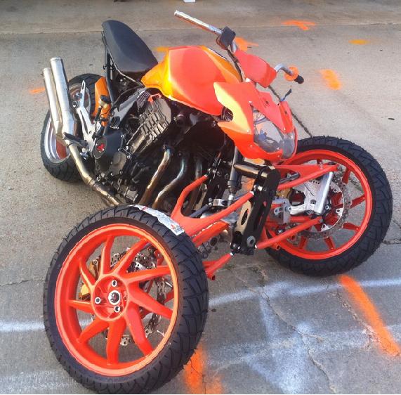

spotted on Pikes Peak !!
Tremoto 3Z1
http://www.tremoto3z1.blogspot.com/
http://tiltingvehicles.blogspot.com/2010/05/tremoto-monstrosity.html
