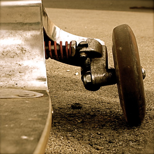

:?: Eric,
now would this K2 scooter be considered FTC ?
no direct steer, lean to steer.
both wheels are linked together with a centering spring.
http://2.bp.blogspot.com/_Q1dyW07vBRo/St1kLS-pnYI/AAAAAAAABaI/FFOU4dpx7fw/s1600-h/k2+kickboard.gif

sk8norcal said:
:?: Eric,
Hard to tell from the picture. Can the wheels steer independently of the tilt? If not, then it's a skateboard, not FTC. Traditional Skateboards aren't FTC - the wheels on a skateboard have a fixed steer/tilt ratio. FTC requires the steering wheels be allowed to adjust steering for both speed and tilt.
Eric
Eric
this steering system is pretty unique,
(in real test, it doesn't ride that good)
it was originally invented by Ciro
http://wackyboards.blogspot.com/2009/07/ciro.html
(i guess its not a real FTC)
