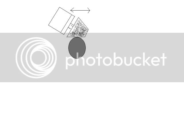

A single sided cone roller with the motor mounted to a sliding mount on a rack, CVT?
Any opinions weather or not a oneway bearing would work as a roller by itself on a skinny 700c wheel? I have never touched a oneway bearing so I don't know how tall or wide they are.
I am wondering how hard it would be to shift the motor under power?
It is not easy to shift a nuvinvci under power and under high power it will hardly move.
The motor would need to move on two planes in a similar way to a dérailleur? Up and over.
