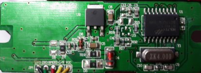

Whilst I am an eBike noob I am reasonably competent at electronics but could do with some help with this.
I just bought this bike 2nd hand, advertised for spares or repair as the battery wasn't charging, the seller stated the charger flashes red momentarily and then nothing. However upon getting it home the battery (26cv9ah) was reading 28v and when I connected the charger the red light came on as expected. (It just occurred to me that it might behave differently if charged on the bike?)
Anyway the long and short if it is that nothing happens when pressing the on/off button on the display. I am thinking it can only be the controller, wiring or display. The controller has 28v at the connector from the battery.
After chipping away at the silicone it now looks like this...
Back side...
I have managed to reverse engineer the display...
The display lights up when powered from my bench supply and the mode button changes the mode as expected, but no battery level lights are lit.
If anyone is familiar with these bikes can give me some pointers of where to look, I would very much appreciate it.

I forgot to say there is no voltage going to the display, which looks like it is driven by Q10 on the controller. (near or, yel, red, gr, bk wires)I have not traced it any further yet.

I can answer my own question about the torque sensor voltage as I can trace it back to the 5v line.
Unfortunately I think the controller is fried as there is 26v on the 5v line now. o_O

The sensor is something like this and is not cheap! The motor phases are marked on the controller as A, (brown) B (white) & C (grey) and hall sensor wires are the same colors, but as I know nothing about brushless motors I am not sure if it helps for testing purposes.

Having decided to replace the controller, display and torque sensor, I finally have all the parts...
BMS S06S Controller.
KT LCD4
KT-V12L
I hooked it all up, using the bench supply and it appears to be working, I just have one thing to sort out. The Giant speed sensor is just a reed switch/sensor (2 wire) can this be used with the controller? Is it just expecting a positive pulse, if so can I just connect the red/white wires?
