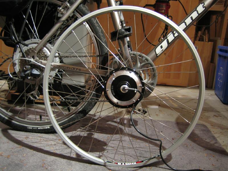

I only just posted a picture of my newly laced-up GM "Mini Motor" in another forum. Something else I'm trying out right now. The bike behind it is the bike I ride the most. See something wrong with this picture? :)

I have a total of 4 Golden Motors (including the pictured Mini, which I have yet to ride). In my quest to be able to maintain 40km/h, I switch between the Crystalyte 406 at 40V and a Golden at 60V. The latter is actually more efficient, but the Crystalyte is quieter (though heavier and produces less low end torque). The GM shrieks as certain speeds are crossed through on the way to top speed, though, which is attention-getting.

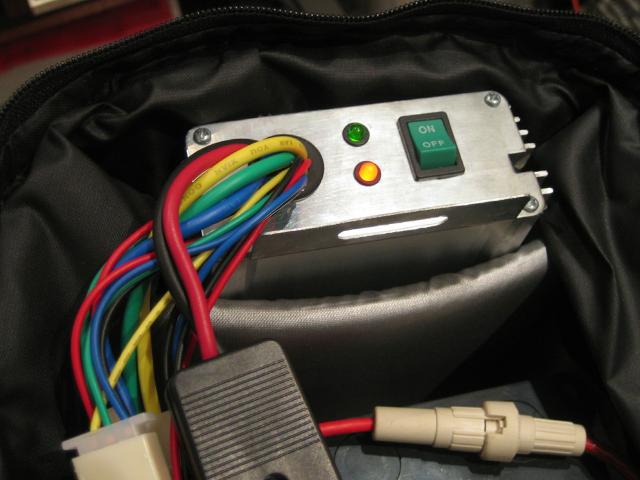

The controllers I got with my original GM kits last year (and the spare I ordered) are all virtually identical to the original e-crazyman that preceded the infineon. I haven't got one open and in front of me, but the 75V FETS sound right, and the resistors identified as controllering LVC are, I recall, the very same that fechter describes in the thread he started on this puppy: http://www.endless-sphere.com/forums/viewtopic.php?f=2&t=4282&hilit=crazyman
The LEDs are described in that thread as well, and were useful enough to warrant bringing them outside the case where they could be seen. The blink codes are one thing I really miss when running the infineon. If the Shenzhen was unhappy, it'd blink out a code to tell you how come.
(Picture from the early days, during my VERY short stint using SLAs and keeping with the "AC Outlet" wiring that came with the kits, though I did upgrade the plug/receptacles before ultimately tossing them and moving to Andersons).
