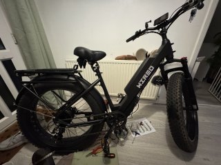

What's this frame/bike look like?

Currently working on phase/hall combos as we speak as you can see lol.
Excuse the fake Wired decal, I hate the company I bought my bike from after they gave me hell and I love Wired bikes but can’t get them in the UK, so, sprayed over the original logo and put a decal on lol

Brakes are pretty damn perfect in all honesty. Hydraulic. Not mushy at all. 180mm up front and 160mm in the back, experimented with different brands of rotors too incase any of the resonance scraping/grinding sound could’ve been that.
