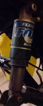

Hi Greg,
I wonder - how long is your rear shock?
asking because got 165mm from ebay and tryed to fit in my next e-bike (first version of i-drive btw) and discovered that rear suspension will accept even 180mm while the stock one was 165(the reason i got the same length from e-bay)
and i`m thinkin now if i could put there like 175 or 180mm and will it help in expanding the rear suspension travel?
just went to look but it doesn't say. here's a pic in case that helps:
i'd be happy to measure, but from where to where?
how's Fas7r? you're his buddy, right?
measure it from between the centers of the holes (or center of bolts)
but it looks like it`s 165mm - the same as mine size. but try to unscrew one of the sides and i bet you`ll se that the travel could be even more!
btw - what is your feeling - do you have enough rear weel travel to ride over bumps?
Does anybody tryed to put longer shock to extend the travel?
yes - Fas_r7 is a friend of mine, I still had no time to post some funny stuff about his Ligerad (hope i`ll do that soon)

Andrey,
You're right - there's a longer shock for the older i-drives that increase the travel from 4.6" to 5.4"
I've got one ;)
I'd have to double check, but pretty sure that the standard shock is 6.5" (165mm) eye to eye with 1.5" stroke and the extended one is 6.75" (175mm) / 1.75" stroke

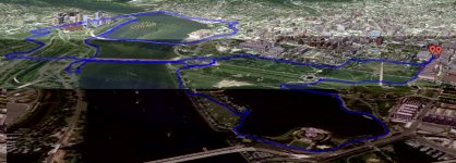

in the meantime, i had a nice lunchtime ride yesterday:
file.php
working on a higher def one for later, but just the trip highlights (music at 480 now):
[youtube]-RVX3wvqOYU[/youtube]
