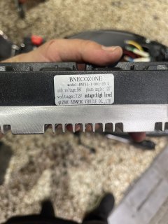

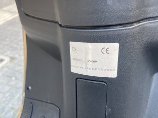

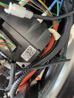

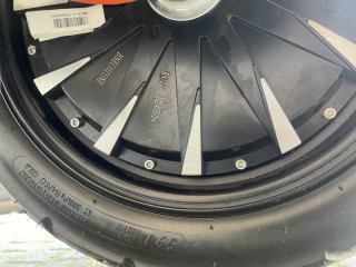

Hello Everyone,
I bought about 2 weeks ago an electric scooter with the attached specs (you can see the motor hub/controller).
The motor rating is 2600watts.
I bypassed the speed limit and I can hit up to 55km/h (it's easy, it's just a cable in the controller), but i would like to make it a bit faster.
Thing is that i cannot find anything about my controller on the internet and if there is any chance to connect it to a PC and check the details or re-program it. I would like it to be able to go around 70km/h.
Any ideas?
I have also thought about buying a new controller - better one to match it with my current set-up but i need your help in this. Any suggestions? And also do I have to change the screen/speedometer?

You could look into the shunt mod but if your battery pack/bms cant supply the amps you demand.. if your lucky a fuse will blow, unlucky and your bms and perhaps battery cells could get dramatic. Or the controller itself may fail due to the increase in amps its handling, cables could overheat short etc..
Also consider how other road users will see you and your bike as it approaches will they expect 50 km/h + speeds or will they see a 'moped' and make judgements accordingly?? No one needs to hear "sorry i didnt see you" after the event!

Thanks will look into this mod. However, i am looking for a safer solution, as i understand there is a high risk if you do that. Do you have any idea if i can connect to my controller a module so i can get data and/or tweak the settings? Or i need to buy a new one? If this is the case, are you familiar with any good brand/model?
You are right about the latter, however, it would be safer for me to move around 70km/h as this is the limit in some roads i am driving. I feel that with 50-55km/h is more dangerous. I am from Greece and generally drivers are not that careful, i am lucky that my horn is loud 🤣
It takes at least twice as much power to go 70 km/h versus 55 km/h. So your motor, controller, battery, cables, and connections must all be able to handle twice your current power.
My advice in this situation is always the same: if you want to move like a motorcycle, use a motorcycle.

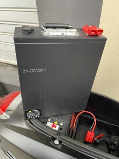

Battery is ok for now i think. I am using the one i bought the scooter with which is 72v/20Ah (i have a spare one from a friend at 72v/52Ah but i have not used it yet) and the distance I do daily is max 15km. With max speed at 55km/h it lasts 2 days for sure (30km) - plus i leave it overnight on with the alarm, which consumes some battery as well. I haven't tried going any further without charging it, but potentially it could make another 10-15km like that.
To be honest, i do not want to mod my controller at all, since i cannot find any pinout/diagram for its connections and i do not have the time to do trial and error. I want to keep this as is and not toast it.
I was almost certain that with a new controller a new screen will be needed. Point is what controller/screen i could buy? I do not care if the controller is similar to my own but at least i need it to have a module, so i can connect to it (via pc/mob phone) and tweak it. Do you have any recommendations?
The same frame of my scooter & brakes are being used also for a 5kw scooter here in Greece, i've seen it. But i do not know the specs of motor hub/wheel/screen.
Photos of the battery?
Attached!

Is the battery under the seat? Is there space for another battery under the floor?

The battery is under the seat, next to it you can place one more identical battery and under it there is room for 2 more batteries or a bigger one. Its crazy what you can do with it.
It used to have also a luggage rack on the rear, so you can store your things there, but i removed it because it looks nicer without it! hehe

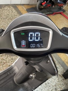

Tested with full battery (70-72v, saw that from the screen):
a) while driving goes max 55 km/h maybe 56 but no more.
b) While on stand (unloaded) it reaches max 58 km/h.
Unloaded is still higher but its only 3km/h. What could i do?

Maybe your speedo is off.

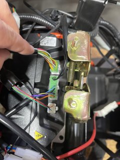

Actually, i did the bypass to him since we have identical controllers.
It is one black cable on the controller, which you disconnect it and can hit max speed. If you connect it again, it goes max up to 25 km/h
See the first photo below (i marked it in green colour).
I will check today how fast both scooters accelerate.

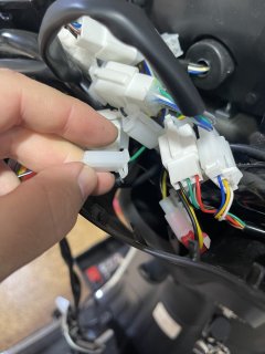

Moreover, i have noticed that i have some extra connectors behind me speedo/screen that are not connected anywhere.
1 plug with 3 wires & 1 plug with a green wire.
I think i need to put both scooters side by side and see exactly where each connection goes.
I have started to believe that i should take my controller out, disassemble it and see on its bottom the functions it has. Maybe i stand lucky and there is a speed/sport function and/or something to put a diagnostic plug on. However, since this will be a generic controller & i cannot find anything on the internet about it, i will not be that lucky.

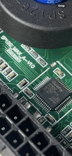

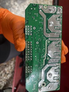

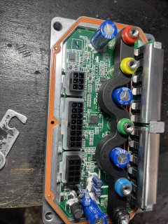

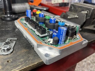

Well, i could not hold it anymore, so i took the initiative and got the controller out of the scooter for inspection.
a) Soldering generally is a piece of crap but i will try to fix it.
b) Seems that in 2-3 locations there was "cold" soldering
c) and in other locations seems like there was humidity - will clean it as well
d) Good thing now is that we have the pinout!
I want to study the pinout now, to see what other functions there are (if i can put a diagnostics on it or if there is a speed/sport button etc).
Problem is that i cannot find anything on the web, eg: What is 485B-Rx / 485A-TX / SIDEVCO? / ZDJC / SOC/ A / DCH / TA / PC14 / COMA / CR / TB
For sure i have cables coming from TB / COMA / TA / A / SL / GND (last 2 is the cable for the speed limit) But what the rest are?
e) I think i will also chance the 4 capacitors from 100v 330 μF to 100v 440μF - i already have them with me from other projects
f) i will try to search on the web the various codes on the board to see if i can come up with something tangible.
IF anyone has any idea, let me know :)
