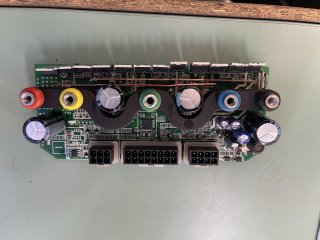

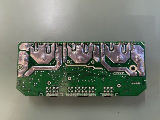

For the time being, i made a better soldering job on my current controller and upgraded all 4 capacitors from 100v-330μf to 100v-440μf. Plus i changed the 63A relay that my scooter had to an 80A automatic fuse. Total speed has not increased but for sure we have better torque now. It is very noticeable.
Next upgrade will be to change the positive and negative wires with good quality ones to try and minimise the voltage drop / stabilize it when going full throttle.
These are just small upgrades that cost almost nothing and can make it a lot safer/better.

Hello everyone, i have this controller as you see in the photo. No idea on brand i cannot find anything on the Internet for it.
However, i changed the capacitors to bigger ones and fixed the soldering on the board.
I wanted to connect this with my pc to see if i can get any data or even program it. So i bought also the attached adaptor.
I made the connections to 485A, 485B and ground and it can be connected to the pc. I used also a multimeter and i can see i have 5v on the usd when the scooter is powered on, so i think i am ok from connections side, right?
Any ideas on what program i could use?

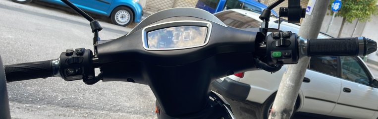

What i did is below, i installed the Z6 Switches, it looks and feels nicer. I had to modify some connections, so all previous functions could work but it was worth it!
I tested also the DKD speedometer, it works (after modifying the cables as well) but not as i would like to. Seems its functions are limited. Plus i need to modify the housing of the old screen to install it and i do not have the time to do it at the moment.

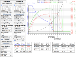

Then swap out the motor. You can easily go 70km/h with the same battery and controller using a faster wind motor. The only difference between System A and System B in the example below, is a faster wind motor, 11.35Kv vs 15.5Kv. (I don't know what motor, size tires you have or total weight, so just an illustrative example)
If you look at the specs of the motor below, it has a very wide range of voltage, power, torque, and speed, so you'd want to order based on the needs/requirements. Speed and torque tradeoff, so you should really know what you want the motor to do, since climbing a steep hill, vs going really fast are two different motors.
