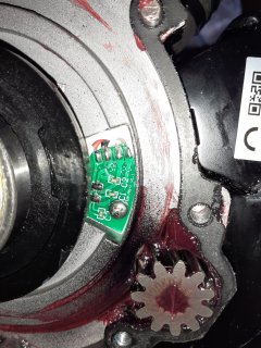

So far looks like there is a poor soldering on a white wire.
Edit.
Now suddenly it started working in opened state. Was about to test the voltages on the sensor since there was a continuing on solder joints.
There could be possibility that the magnetic disc gets displaced too far away from a hall sensors since it's a bit loose.

That could do it.
Now after putting it back together it was still working but after shortly turning on again cadence sensor doesn't work anymore.
Was tapping the solder joints but it didn't stop the sensor from working. Also reconnected the cadence sensor at the controller side.
Bummer.
You can test the sensor outputs with a voltmeter. You can do this on the controller side with everything hooked up. Measure the voltage on the grey and white wires while turning the crank slowly backwards. Put the meter negative on the black wire or the battery negative. You should see the voltage toggle from near zero to near 5 volts as you turn the crank.
The problem could be the sensor or could be the controller itself. If the sensor tests bad then replace or repair it. If it tests good it would point to the controller.

I thought there is no point to measure the hall sensor voltage when it was working when opened since you need three hands to do it without soldering.
