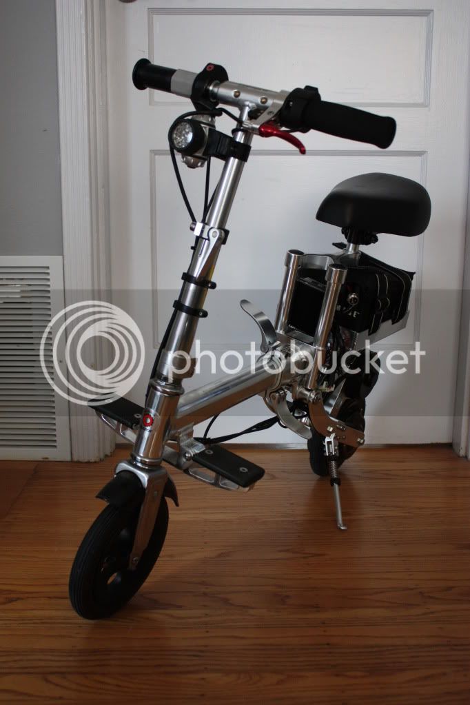

Trying to revive this old guy and hoping you guys can help me out:
https://www.youtube.com/watch?v=dwBNZ0LoXIo
My LiPo battery went bad way back when and I'm replacing the setup with (3) 12v SLA batteries. I know how to connect them in series (do I really need 12AWG wires), but I'm hoping you guys can help me with a wiring diagram on how to charge it.

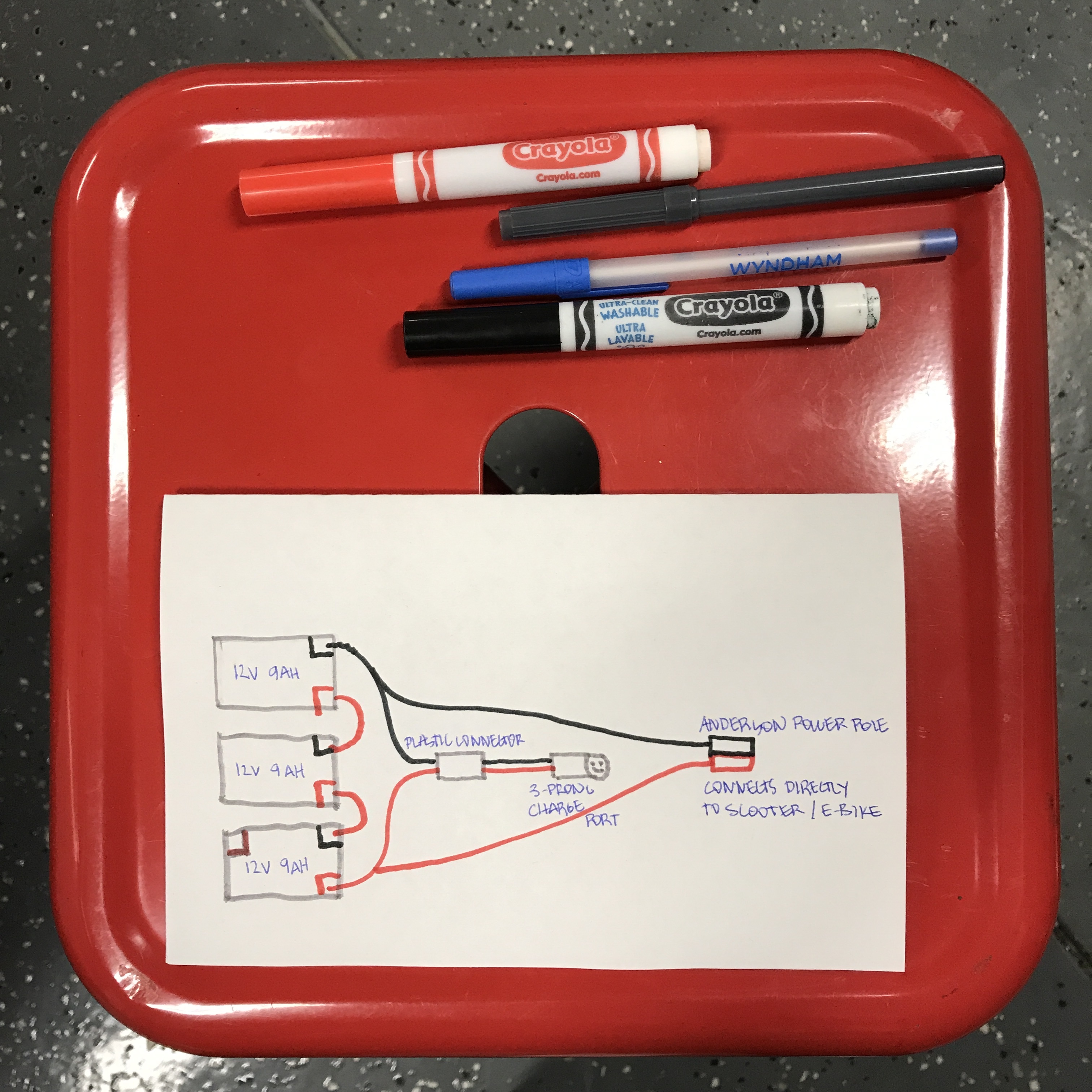

Using the setup from my cruizincooler, I used that as a starting point and created this wiring diagram. This allows me to charge using the 3-prong charge port and then power the scooter (and also an e-bike) using the anderson power poles:

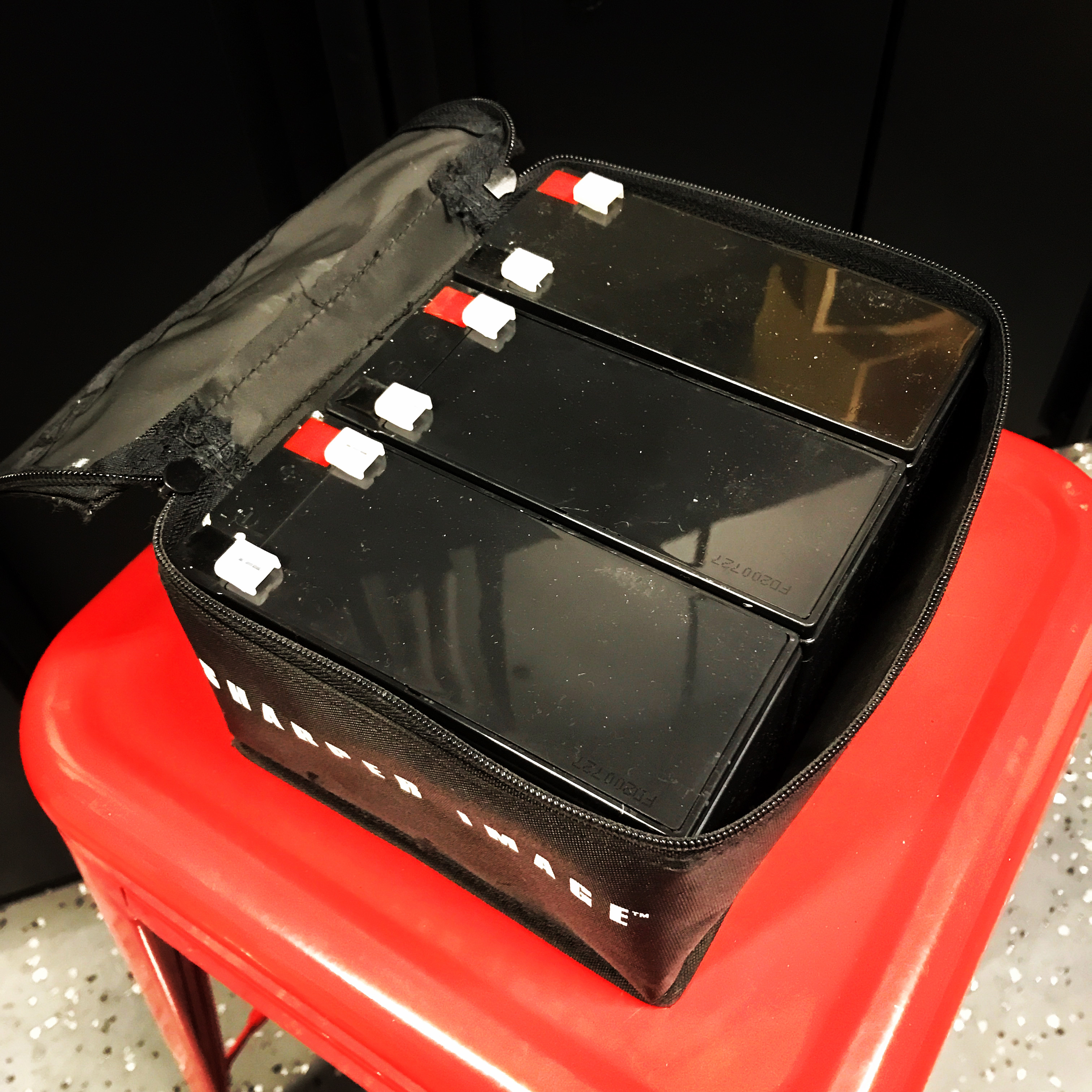

I'm pretty stoked that the 3 batteries really do fit inside the case that the scooter came with. Originally, it housed (2) 12v 10ah batteries. By dropping down just 1ah, I was able to fit (3) 12v batteries in here for the overvolt system:

Yes, I figured charging in series was the way to go. Makes more sense as far as convenience. Can't imagine taking it all apart every time I need to charge.

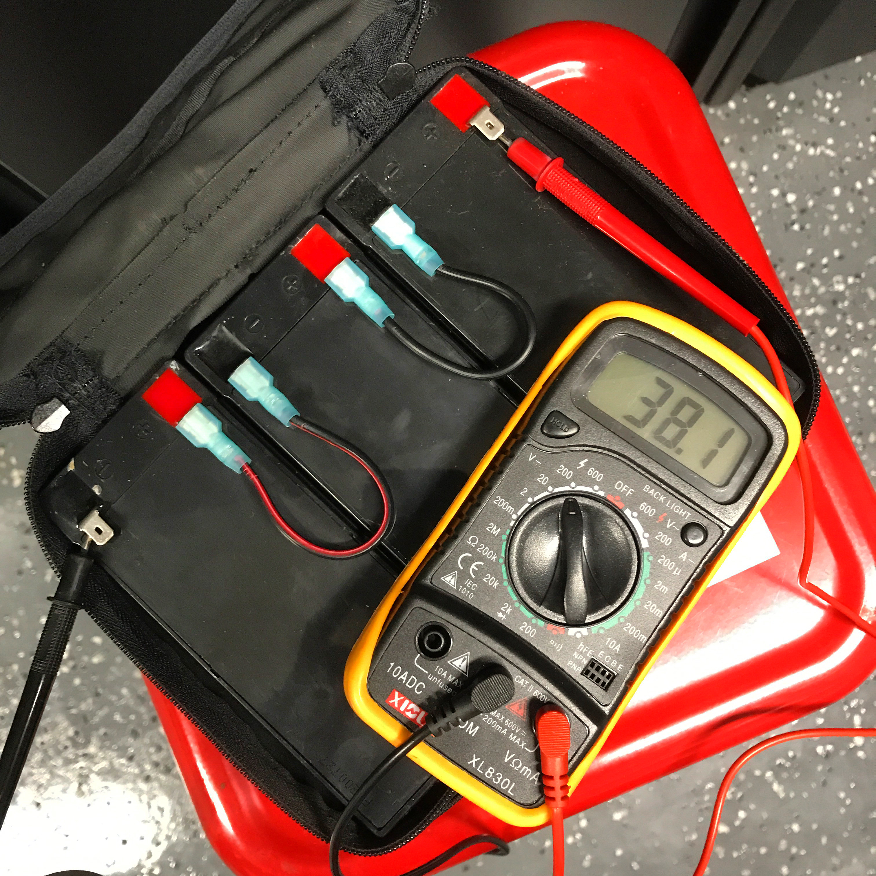

I thought I'd give you guys an update.
Next step was just to connect the batteries in series with my homemade connectors. I'm not usually the guy to make stuff like this albeit it's not the most difficult thing. I snatched some 14gauge wire from an old RC NiCad battery charger that I no longer use and crimped some connectors I got from my local auto parts shop. Tested the voltage to make sure everything was connected correctly. This was actually one of the first times I've used a volt meter. Yeah, I'm an old newb.
This afternoon an idea dawned on me. Rather than wiring it like the diagram above that I uploaded, I figured removing the harness is actually pretty easy. So instead of splicing a charging port and another connector to connect to the scooter, I figured I can just have them completely separate. Use the charging harness when charging and remove it when not in use. Then connect the cables from controller to the battery when I'm operating it and voila!
Took it for the first test spin this afternoon and it worked! I had a hard time getting any Anderson Power poles at decent prices, so I ended up forgoing the turn signals on the scooter and just ran some basic insulated connectors to get the scooter at least operational and it runs now!
