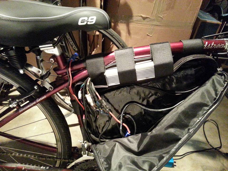

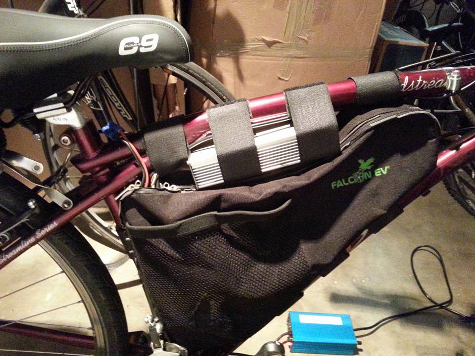

I didn't make it to the hardware store for some u-bolts, and I had to come up with something to get my controller out of the bag. I wasn't about to fry another controller and leave myself stranded in the middle of the night. So, I came up with this on-the-spot solution, which has worked out pretty well :
I mounted the controller using what I had at the moment: velcro straps from the frame bag. They hold it very securely. I also have it upside down, so I can check the temp any time. It gets a lot of airflow, stays cool, and protected from splashes and sprinklers (but not rain).
Bag zipped up to the wires. You can't see much of any wires anywhere. Looks rather clean, in a retro-fitted kind of way. I love that industrial, electro-punk, retro-fitted look of these custom kits.
