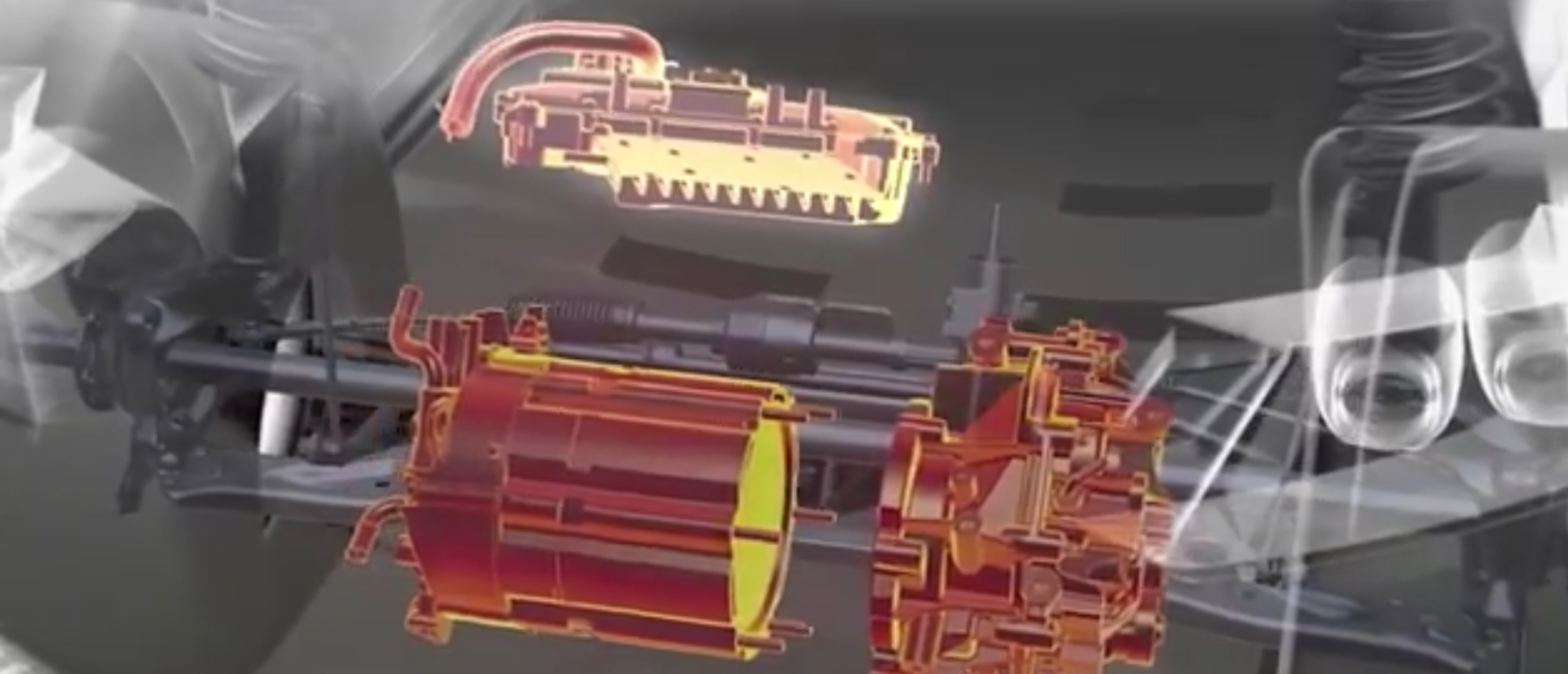

Interesting... so the mid drive vs. hub motor debate comes to automobiles.
I really like the idea of hub motors for multi passenger vehicles, because it frees them up to carry more and larger payloads in a smaller footprint. But at the speeds today's drivers expect, on the surfaces we have to work with anymore, hub motors seem to present suspension issues that can't be solved without using unnecessary vehicle mass to mitigate their unsprung weight.

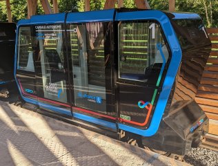

I like the idea of having hub motors, but it will be feasible if the road or track is smooth, or has a running track like the urbanloop
I rode on the UrbanLoop , which is a vehicle on steel tracks, using 2 hub motors (72V). The track is very smooth, as it is made with 2 steel rails, so the unsprung weight of the motors wasn't problematic, even at 50km/h
I think hub motors will become lighter, and with a tyre helping to suspend the motor mass, to make them usable on everyday's cars, usable on highways
if the technology don't become lighter, the hub motors will be more suitable for subways or rail tracks, but sadly not for heavy cars, like the Teslas or MG4 (small, lightweight EV cars, like Renault Twizy (the twizy has a classic motor + gearbox currently) would be fine I hope)

The wheel's structural mass isn't the problem. It's the motor. Electric motors are mature tech and don't have substantial fat to trim, nor big performance gains to be had from additional development.
Making hub motors 10 or 20 percent lighter per HP won't make the basic problem go away, but that degree of improvement is really difficult and expensive to achieve at this point.

Chassis mounted motor with reduction drive through drive shafts ( as with most current EVs) avoids so many issues.

That's extra weight and expense in addition to the already bad weight and expense of a large low RPM electric motor..
The inboard motor is cheaper to produce and makes a lot more sense!
Given that you can have one motor per wheel, and at least four wheels, it doesn't seem like torque is the critical limitation
Oh, i am sure it will work at some level, Mercedes, Ford, Honda,have previously built test vehicles with hub motors, but with no obvious outcomes ?
Until DeepDrive have their motors independently tested on a vehicle , i will remain sceptical !

I suspect that hub-like motors connected to CV joints and half axles (with or without planetary reductions gears) are the sweet spot. But all that lost payload volume....
Cars. They suck. They keep finding new ways.
Multiple motors, inverter/controllers, gear systems, etc, doesnt sound like a sweet spot to me when compared to a single motor drive train, with a geared differential ( as in most current EVs) .
