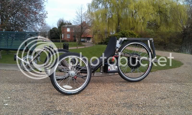

I'm gonna dump the mdf, just picked up an abs plastic box that might be useful, Once its supported underneath!
Careful with the ABS, too; I have an ABS box I didn't properly support for my battery, and the wiggling over time cracked the edges and almost dumped *my* battery out. :roll:
I've dropped the box, too big. Got a frame support welded up. Only supported one nd at the moment, will troangulate once Im sure how much space I need. Have found the perfect box for the batteries though! Ironcally it a petrol can...
Almost like it was made for lipo!

"Xanda wrote: Think I've solved it! Works great.
Love your custom build. Just be sure that petrol is very empty or you won't even be walking in shame :mrgreen:
JK, seriously nice skills you have and great end result! Does the seat flex at all? I ask b/c I want to place an RC motor in that spot on a two wheeled recumbent.
Batteries in a petrol can....brilliant, i can see Officer Dibble scraching his head with that one.
The seat doesn't flex noticeably, but I have reinforced it a bit near where the rear fork meets the seat tube.
