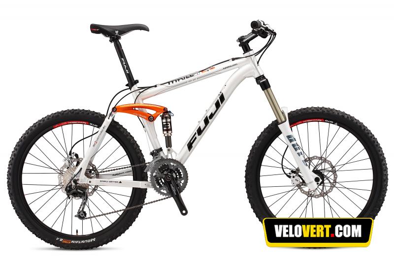

What would you consider an enduro frame? I'm currently working on a project using a 19" 2009 Fuji Thrill LT 2.0 frame that has 150mm of rear travel. I found the perfect fork for it, a 180mm Fox Float 36 RC2 (straight steerer!).
I bought a BBSHD for it, and it fits its 68mm threaded bottom bracket perfectly, and the Luna Eclipse chainring fits without touching the chainstay (awesome!). 42T on a 26" bike is the equivalent of a 38T on a 29er (which is what I have now on my main bike, and it is more than adequate for motorized climbing), and if you use a wide range cassette like a 11-46 or an 11-42 with a 50T OneUp Cog, it should climb anything.
The triangle has quite a bit of room for a battery (for a full suspension frame).

How did I miss that bike? This Fuji looks like a fantastic choice for an e-bike.
I pulled the trigger on 2009 Giant Trance X0 and I'm building my own transmission to fit that bike.
I like Tangent build, but noise and vibrations are something I couldn't live with.
