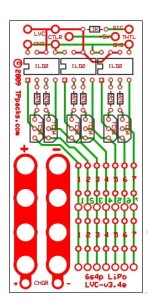

I will have these ready by about Monday of next week:
This combines a simple LVC board with a parallel adapter that lets you combine both the main pack leads, and the balancer plugs for up to four 6s-5000 turnigy packs in parallel. This yields up to a 6s4p configuration, paralleled at the cell level. There is one output balancer plug/pigtail, and one set of main discharge power leads. This is basically an updated version of the combo LVC/parallel adapter I sell right now, shown below:
What is new is it now also has the parallel adapter for the main pack leads as well. The 4mm bullet plugs that come on the Turnigy packs will plug right into this board.
I also have new balancers that have an active cutoff of the charger power if the voltage gets above 4.26V. The balancer shunts are set to 4.15V and provide about 660-670mA of balancing current to each cell, which is at least double what any of the RC charger/balancers can manage.
What I'm putting together are some complete packages that include a pack building kit which contains an LVC/parallel adapter board, double-sided tape for sticking the 6s-5000 packs together and extra-wide shrink wrap (248mm/9.75"...) for finishing off the pack and hiding the various wires/connections. The example below shows a 6s3p 22.2V/15Ah pack and a triangle-shaped 12s3p 44.46V/15Ah pack:
These combo packages will also include balancers (with active cutoff...) and will have options to include a Meanwell S-350 CC/CV 7 or 15A CC/CV supply/charger. The first of these combos will be for 12s2p 44.4V/10Ah or 12s3p 44.4V/15Ah setups.
Also, I have a new charge/balance plug adapter that has a single 18-pin AMP connector that combines the balance plugs for both 6s2p/3p sub-packs, and the main charge leads. Each pin in this connector can handle up to 9A continuous, and two are used for each charger lead. This lets you have a single charge/balance plug for the whole 12s2p/3p pack. A single 12-channel balancer/HVC cutoff unit has a matching plug. This simplifies the whole charging and balancing setup, which is completely separate from the discharge wiring (no more KFFs... :mrgreen: ). The balancer unit is basically connected in series between the charger/supply, with a single plug that connects with the pack. This is about as foolproof as I can make it, mainly for my own protection. :roll: :lol: I've had a few blackened thumb/finger episodes as well...
Anyway, the testing on the new balancer is complete, parts and PCBs have been ordered and I'm working on instructions. I hope to have everything ready by the end of the week, when everything outstanding as shown up. :)
-- Gary
