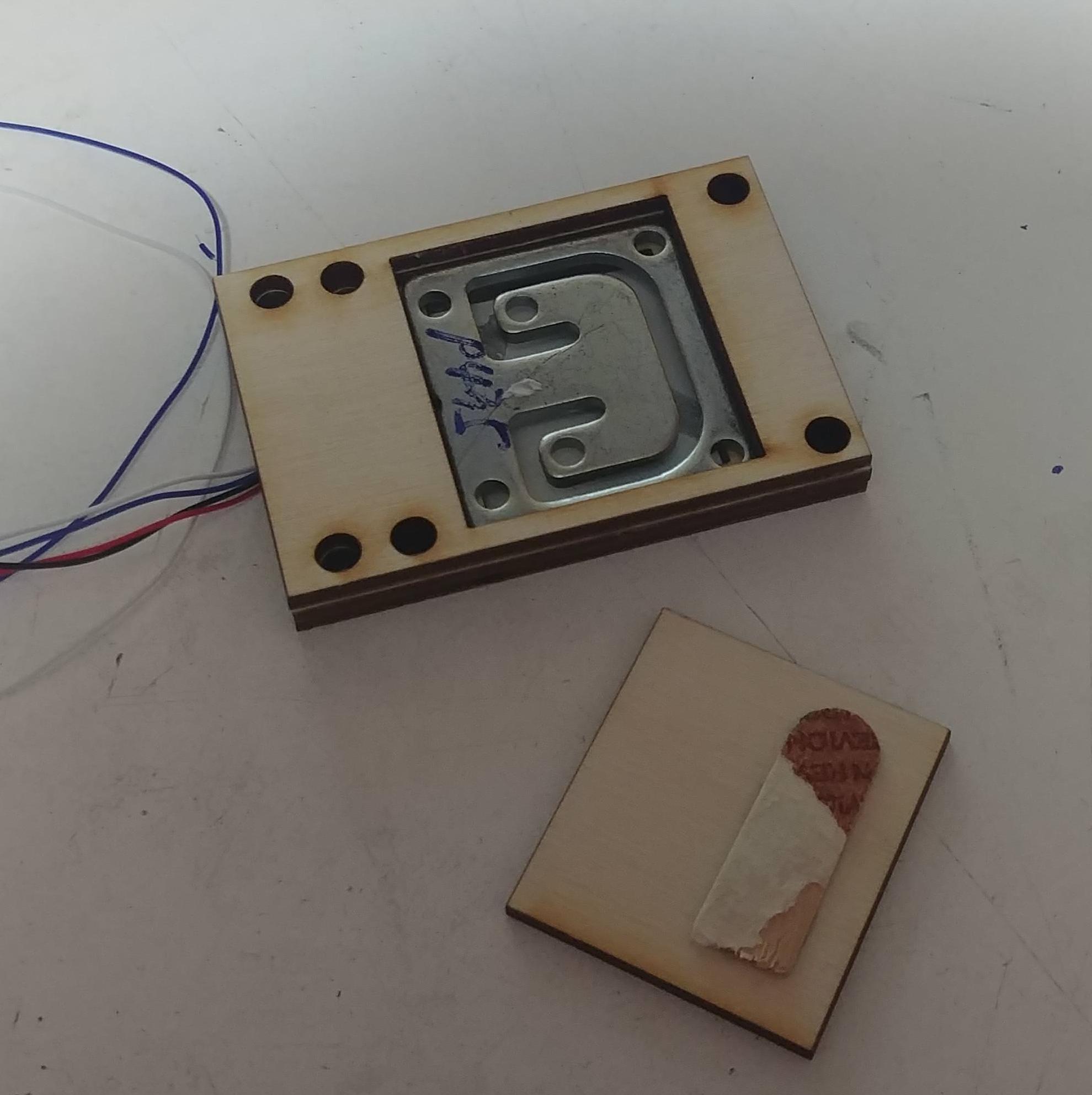

To mount the sensors on the board, I briefly considered having two pads on the top to step on. This, however, violates the design plan-- the skateboard needs to be balance controlled, and that would be no different than stepping on switches.
The current plan is to mount the strain guages inside risers. These are small, 1/8" to 1" pieces of plastic that go between the board and the trucks to add some height. My trucks came with 1/4" risers and hardware for them, so I want to see if I can fit the load cell within a riser of this size.
My first iteration, pictured above, was made of stacked laser-cut birch wood sheets, and amusingly, a piece of nail file. There was pocket for the load cell, space for the load-bearing part to deflect down, a hole for the wires, and a lid on top. This test was a great success-- all assembled, the board was able to detect the two load values and output a graph.
Iteration two includes six stacked rubber sheets in the same design with some minor refinement. Instead of a lid, the top can now flex, and I hope the rubber will absorb some shock from the ride.
