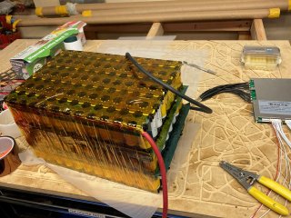

Dude this bike kicks ass! Have any pictures of the battery build?

Here are a couple pics of the battery build for those asking. Its a 72V 45.6 AH 24S-12P pack using LiFePO4 K2 26650 cells. First battery build. I didn't really blaze any new trails here as I used pre-made cell holders and nickel tape etc. In hindsight I would have made some improvements though.
The ANT BMS is has plenty of overhead on the current requirements at 180A continuous and 400A peak but I accidentally didn't get the can-bus version. I may replace it someday to improve the accuracy of the battery level gauge on the speedometer. It does have a nice Bluetooth app for the phone which gives me tons of info so I'm not too worried about it. Also the series and parallel connections on the battery are only the .15 x 10mm nickel strip. The motor can draw 150+A during hard acceleration and I think these connections are probably the weak spot in the battery build. I have a few temp probes around the battery and reporting to the BMS and Bluetooth app and the temps aren't particularly high or anything even after hard riding. I usually ride in gear 2 which reduces the top speed to about 55mph or so and lowers the peak current to 120A for short intervals of high acceleration. It's the perfect balance of performance and battery life at that level I think.
Thanks for the great feedback on the build, its making me think about doing another one for sure.Batt Cells.jpgIMG_6579 (Large).jpgIMG_6590 (Large).jpg
Nice build. Your battery is nearly identical to mine, cept I used 32650, but still used the same 3 layers, same orientation. To beef up the series connections, from just plain nickel strip, and to handle more current easily without a drop, what I did was find tinned copper strips online. Cut those to length and soldered them to the top of the series connections. Certainly not the perfect way to do it. But worked for me. LiFePO4 can handle soldering for a few more seconds than smaller Li-ion cells, though not unlimited heat applied. And anyway, I was heating the series connections, nickel, not the cells directly.
Your battery should last quite awhile. I hope to follow yours years from now to see when you need to replace it, so I can compare it to mine, at such a similar build quality and style
