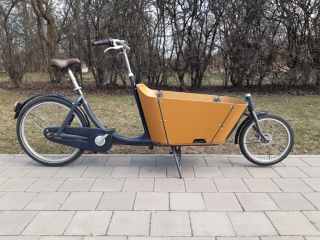

Shortest possible summary: Take a cargo city hauler bike with a front basket, add a hub motor, use the basket for battery and storage, turn it into a long-distance cruiser/bikepacking machine.
My context: I have a converted 26" hardtail with a 48V battery and a 2.2kW-capable controller/motor combo. I liked the bike as an acoustic, I liked it as an electric, but neither form really satisfied me fully. It was my main bicycle for the past 15+ years. I did a lot of MTB and the hardtail aspect was limiting for aggressive riding. As an electric bike, I like the range and power it has (with a custom battery made to fit the frame in 13s10p), but the aluminium frame's dropouts are a poor match to the wide motor, so it keeps coming loose, wires rub, the drivetrain is a converted 3x8 -> 1x8, and it's all a huge compromise. I wanted to turn it into a long-distance trip machine, and the plan for cargo was to pull a trailer, but with the motor axle problems i'm not convinced that would work well. Plus it's a size 19", and I'm 186cm tall, so the geometry isn't all that great.
My specific plan: Get one of those:
Which can be obtained used for about 400 eur. It's steel frame with rear-facing dropouts (for singlespeed) - so adapting that to securely hold my motor should work very well. Worst case I can just cut and weld new steel plates to that to make it accept a large QS or something if needed. I'd likely keep it single-speed for simplicity; I don't plan on scaling mountains on it, and if I ever need to, I'd probably rather put a 8kW motor in with a 21" motorcycle wheel and rely on that instead of pretending i can pedal myself and 50kg of bike and gear up a mountain.
The length isn't a problem for me and I think it should be an advantage - i want to ride longer trips, 80-100km/day across bike paths and forest fire roads. With 2+kW of motor behind me, i'm not concerned about the weight and like it more than a trailer. I would put the beefiest tyres I could fit on it, but it already comes with pretty large ones - since it's prepared for the overall large weight. The geometry is relaxed which should work well for longer trips when i only need to put in a bit of power and don't have to be folded over and pedalling like crazy; I might replace the handlebar with a flatter one and with a bit longer stem just to give myself a tad more space and bring it from "upright city bike" to a "comfortable semi-upright tourer".
So I'd take the motor and battery off of my bike, put it into that, see if I like it, and if so likely replace the box with a dedicated solution that holds a larger, dedicated battery I'd make for it (likely needs to be easily removable for charging in a hotel room), and lower-profile, waterproof, lockable storage. To top it off, i could add a solar panel to the lid for extra points.

Just for reference, this specific bike model has 26" rear 20" front as standard, and the rated cargo box capacity (so excluding rider weight) is a whopping eighty (80) kilograms (or 176 pounds). Even with luggage for two people and a massive battery, I'd be nowhere near that.

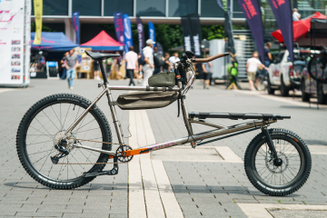

Posting a couple more tangential projects:
Omnium Cargo Ti
First time I saw this. This particular photo is from 2023 Eurobike. As I understand it, Omnium is a pretty cult brand at this point, and the bike has many elements I thought about, yet is decidedly more... bicycle?
I love the front tyre matching the rear one and of course the frame is amazing. The titanium ones are of course pricy (5000 eur+), but the regular belt-driven model can be bought for ~3200 eur, which looks like a fair price. They even have an e-option, but I'm obviously very reluctant to dive into proprietary mid-drive market for such a build; a belt-driven generic hub still seems like a better option for long-term ownership.

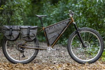

Sentient Cycles
This one is far more custom; featured in Bespoked London 2026, it immediately presents a much more offroad capable machine. This one puts the cargo taller still though, meaning that while certainly capable, i can imagine it's a bike that would require much more attention during riding; it looks less like a relaxed cruiser and more of a true expedition suv.

I've also learnt that the Babboe has a Mini version, which is pretty cool, because it's 20cm shorter (for a 1800mm wheelbase). It would fit my purposes better, but it's pretty unobtanium used, and the affordability of the used ones is what's also pushing me towards this project in the first place.
