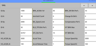

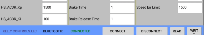

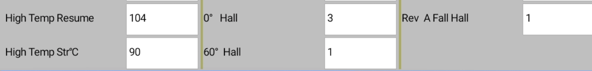

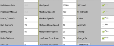

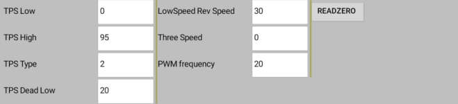

So recently I wanted to tune my KLS730N for better responsiveness and copied a lot of the values from this thread.
If I go >25mph its smooth and if I use regen throttle from 30-0 its smooth, only at slow speeds the motor jutters and resonates with the bike (see video).
I initially though I messed up a motor parameter so I re-ran the motor identification sequence but there was no change.
Im running 72v with a MXUS 3k 4T.
Here are my settings:
