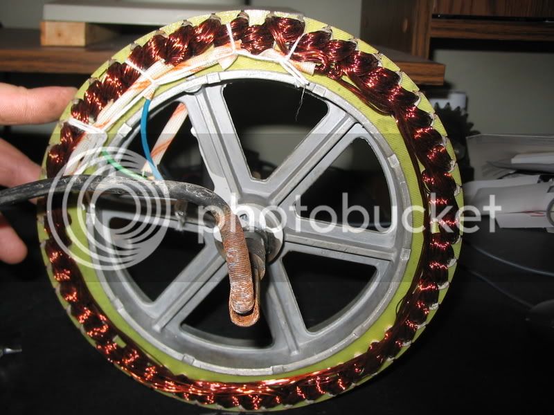

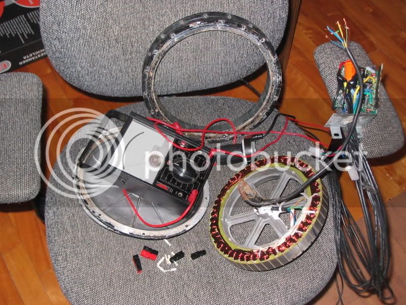

core & ~1.5foot cable ~2.7 kgs
face plates: 784g
bearings: 88g

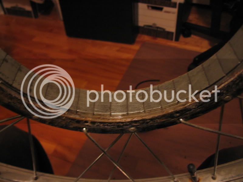

magnet ring thing 2.220kg +-5g
nuts washers & screws ~110g
total ~5.875kgs

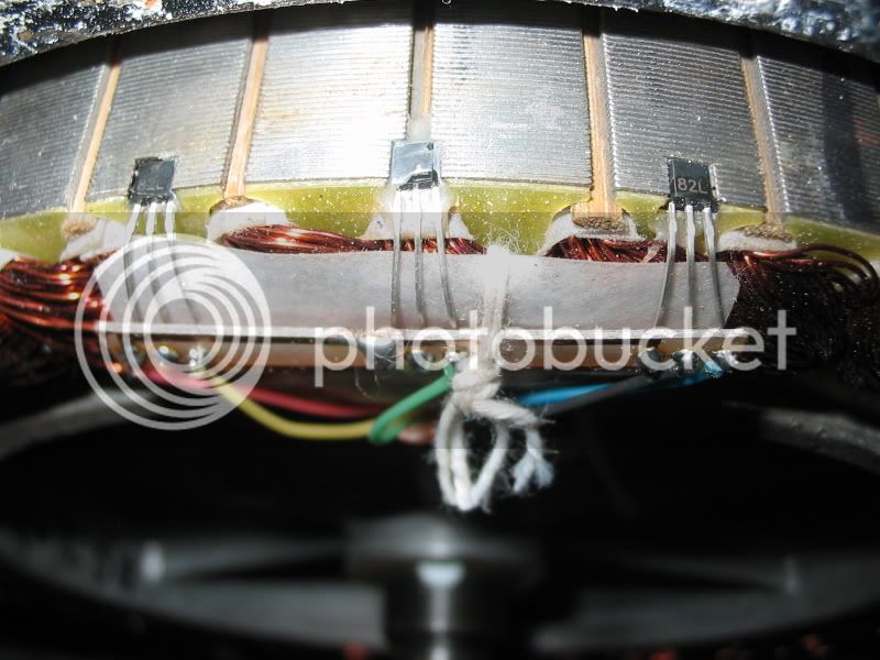

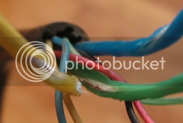

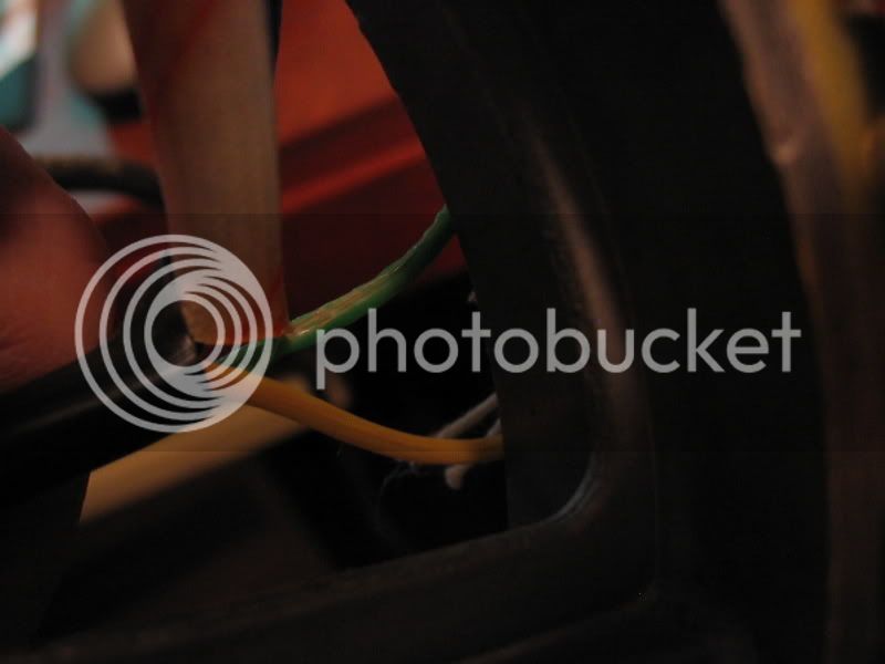

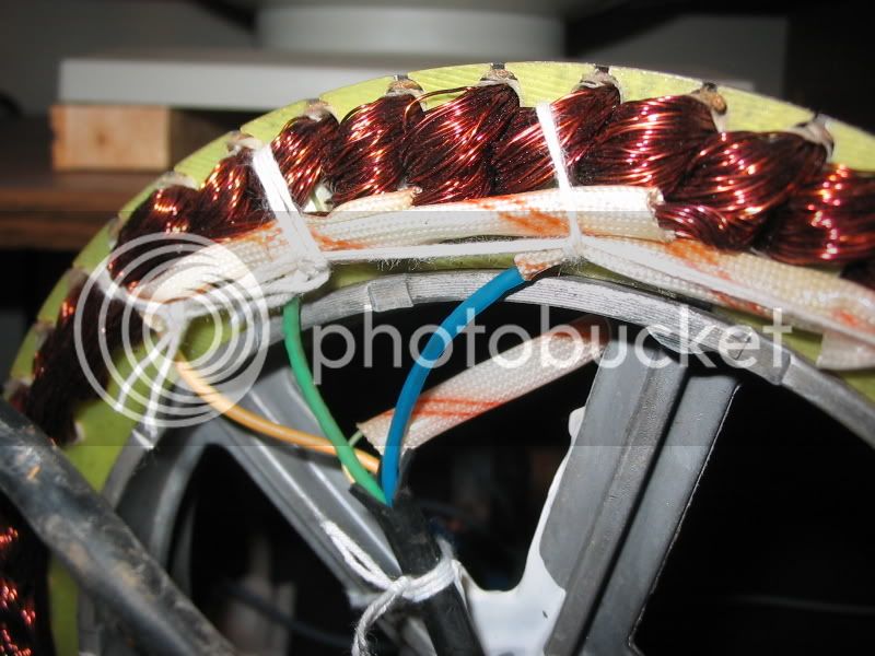

Wires melting together:

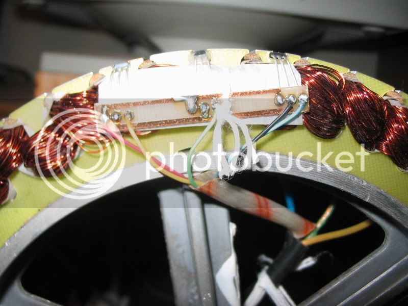

Watch the metal coil going into the hub. It isn't that great in protecting the wire and can actually hide damage.
3rd pic down. The hall sensor board. The right hand side connector looks like it is beyond the protective board and is risking connecting the windings.
Yeah, I'm thinking about putting fatter wires for the coils though. the ones currently in place show signs of having melted, and indeed fused together, though electricly everything still works as it should there for now.
The pic is a little misleading, the peice of parchemin paper(?) actually covers the underside and such pretty well.

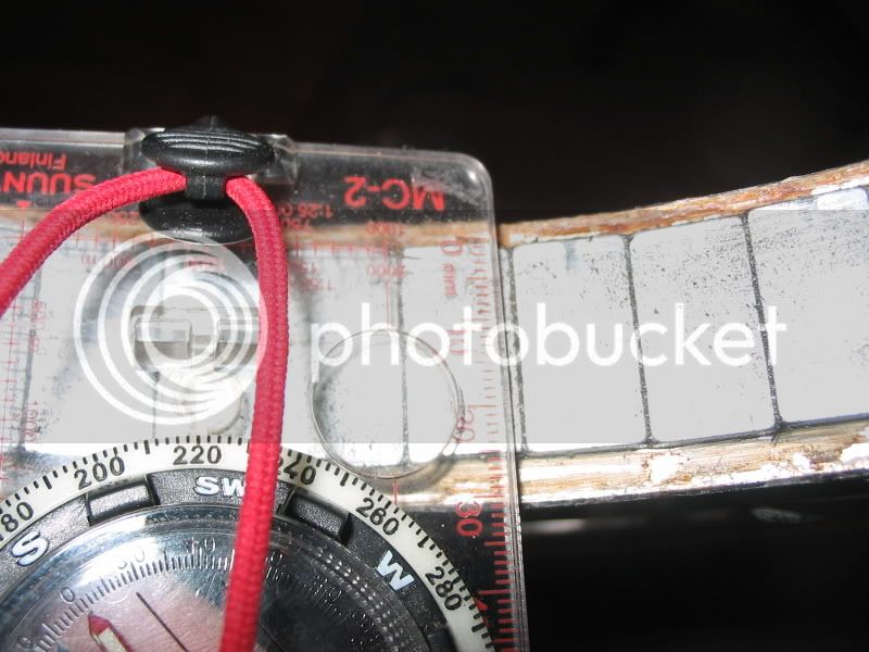

Oh, and the magnet ring is 19.8cm cm's across, also the faceplates seem to be aluminium-ish material, the inner part of the motor too. The part where the magnets is made of something that rusts.
