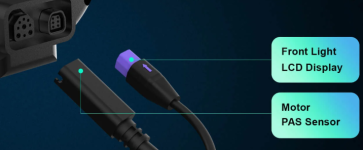

On this battery holder, there are only 2 connectors visible on the bottom, so imho no option to switch levels

The purple 6 pin plug on the battery bottom combines the light and the display wire, there is a 1 to 2 cable that splits to the "normal" green 5pin Higo display connector (used for UART in most cases) and the red 2 pin Higo for the headlight. The
connector on display side seems to be male, so it't not Bafang, but Kingmeter / Key-Display standard.
