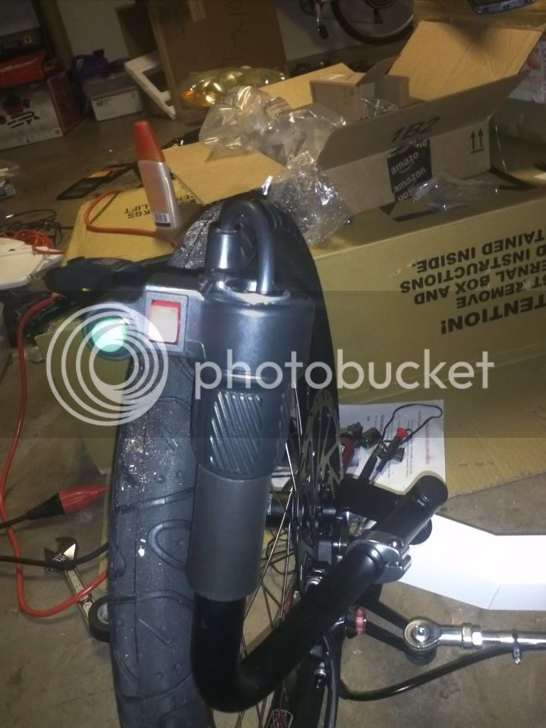

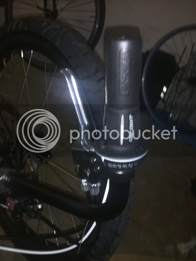

Installed the shifter for the rear derailleur. Bought an SRAM grip shifter and cut a wuxing handlebar grip. 7 speeds it is. Now I need to tension the rear chain a bit since it is a bit loose. It still shifts good but i'D like to tension it a bit.
Shifter and Brake

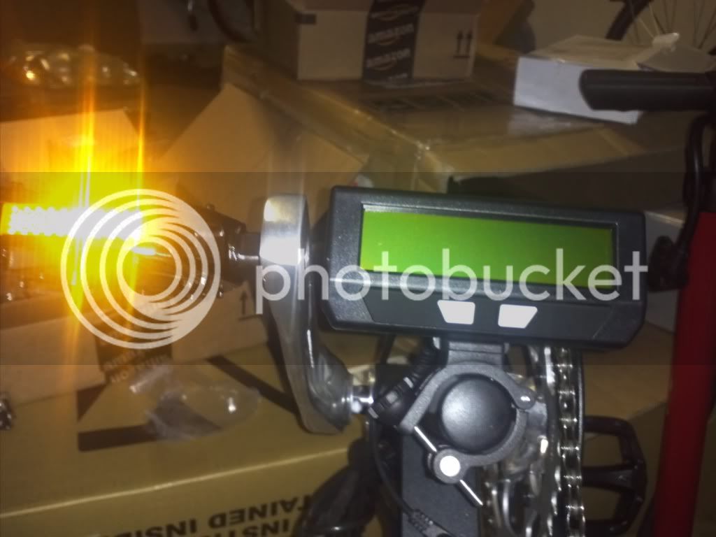

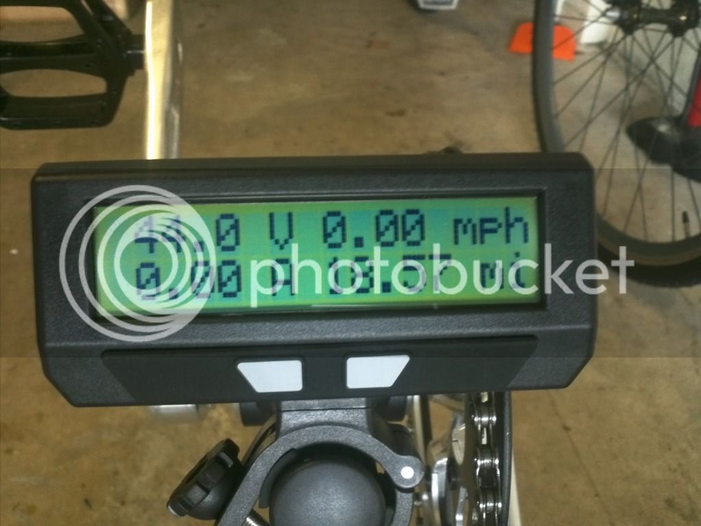

Installed a CA up front and used all the cable routing stops for the front derailleur that I won't have.
CA with a bit of clearance on the right
Left clearance
Now onto the throttle ... I bought a throttle from an user here on ES a while ago. Now I got it installed YPEDAL's style. Definitely the best way to install a throttle on these KMX trikes.

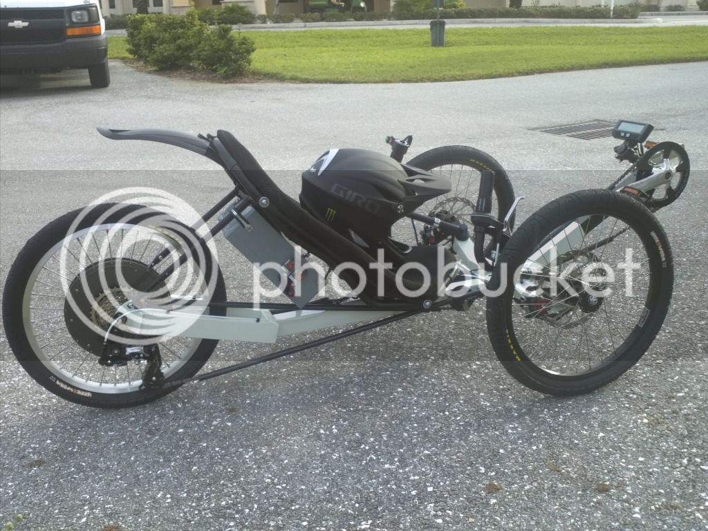

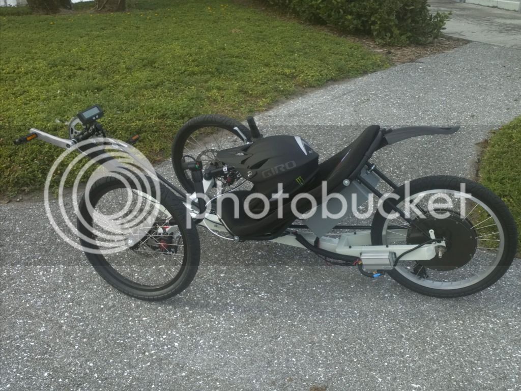

Well I did my first test ride today.

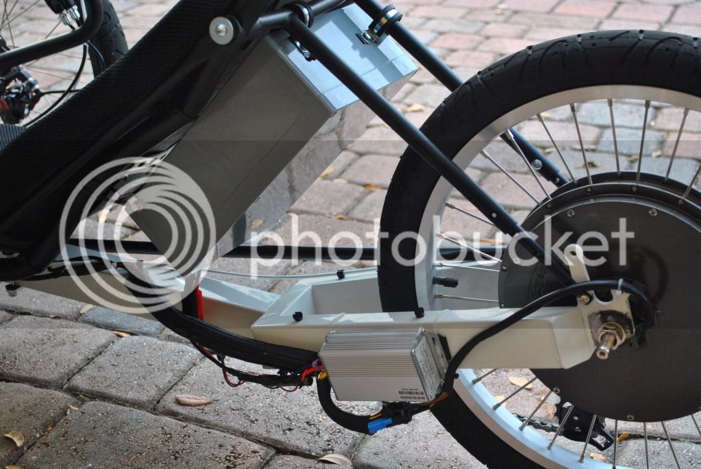

So far it is running with a lyen mini monster controller setup for 35amps and 12s lipo. Lyen added a shunt and modded it for more amps.
After several full throttle launches the controller gets warm to the touch. I had a plastic enclosure box which I modified to attach to the rear part of the seat. This is a temp solution until I make a permanent box.
Now some thoughts on the setup;
I love the hs3540 on a 20" rim at 35 amps it is brisk and agile I can't imagine it at 60 amps.
Top speed using the 120% setting is about 27mph. I'll have to ride the trike for a while before commuting since the steering at 27mph is a bit scary.
The CA DP is a perfect addition to this setup.
Brakes lock on the right under hard braking so I might have to adjust them.
Anyway I've attached a picture. Will start taking some more during the week.

Lyen's mini monster controller is pretty good so far doing 30-50 amps on this and it doesn't get crazy warm but just warm to the touch which is good for me.
BTW when you guys use the ebikes.ca simulator do you use semi recumbent or full recumbent?
The reason I ask is because yesterday I got ~9.5 miles of trip distance and my 12S1P pack was at 3.80v/cell. I'm using turnigy 6s 5Ah. According to the simulator using semi recumbent I should get ~10 miles.
I use semi recumbent.
If I understand correctly the range in the ebike simulator is calculated for a totally flat track at full speed without frequent braking and accelerating. Thats not how you normally use your trike on the road.
Acomplishing 9.5 miles real road out of calculated 10 miles range it pretty precise, don't you think?
There is also the little uncertenty about how much juice you really extracted out of your battery...
To increase battery life I normally charge my 5Ah RC-LiPo packs to 4.1V per cell (90% charge/4.5Ah) and treat them as 4Ah battery packs in every day use to avoid sucking them dry. In the beginning I deep discharged and killed a 6s/5Ah pack and don't like to repeat that.
If I don't made a mistake in my calculation that means my 10s3p battery (37V/15Ah nominal, 42V off the charger) is in fact a 41V/13,5Ah battery at 4.1V per cell and I suck no more than 12Ah out of it. 41V/12Ah is actually what I type in the ebike simulator to get a 'feeling' about my potentual range and top speed.
When I connect the packs to 15s2p (55V/10Ah nominal), 61,5V hot off the charger at 4.1V per cell, its a 61V/9Ah battery that gives me 8Ah of juice to play with.
I understand everything you explained. The thing is my CA is showing 9.5trip distance and my resting voltage is 3.8v which seems a bit too high if I take into account this is storing voltage.
I checked the shunt value and it is correct. I also checked the wheel diameter and it is ok.
I really didn't do much regen so I might do another test run using my cell phone to log distance.
Florida is all flat and the majority of the areas I commute to are flat with not that many stops so the simulator pretty much resembles what my route is.

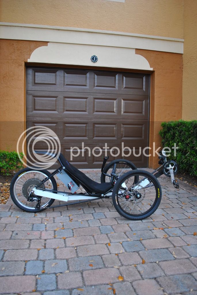

At last my 12s2p enclosure is ready for the daily commute. Any suggestions besides a spare tube and adjustable wrench to carry around?

Little multitool with Allen keys for adjusting everything from your seat, handlebars, brakes etc and a couple cable ties
Sent using Endless-Sphere Mobile app
Excellent thread, thanks again.
I bought a Slime Schrader Valve Tube, 20" X 1.75-2.125". Don't know if it works, but it is only a couple bucks more than a regular tube. Don't want to be changing a rear tire!
PLEASE tell us where you got that 12S2P enclosure box, thanks in advance. Nice location behind the seat!
Joe Mc.
The enclosure was bought locally from mpja.com this is the link ;
http://www.mpja.com/1043in-X-728in-X-374in-IP-65-Plastic-Project-Box/productinfo/17398+BX/

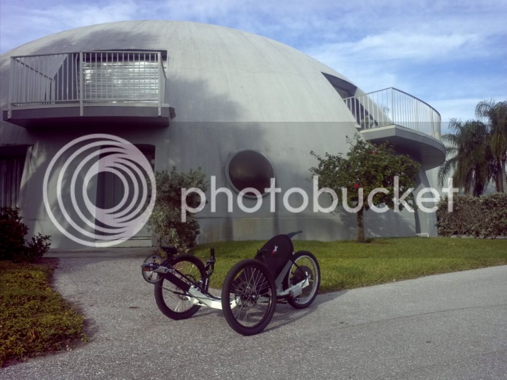

That your round house ? Looks cool.
