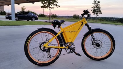

About the only wisdom I can add to your question regarding compatibility of KT clone displays to genuine KT controllers is my sole experience. Bike came with what I believe is a KT clone display (part number on the back does not start with KT), and a generic controller.
Replaced the controller with a larger genuine KT controller (25A Sine) and genuine LCD8 screen. Just out of curiosity tried the original what I believe is a clone LCD3 display, and the KT controller .... worked perfectly.
