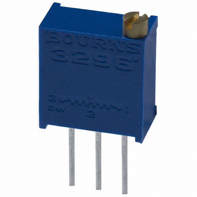

What if you had the level of assist you need by pressing a button? On my earlier version of my bike, I added a momentary button switch that I could hit with my thumb. It used a trim pot as a voltage divider and output 0-5V, depending on how the pot was adjusted. I had it set to provide a throttle signal that would provide 50W from the controller. I used the button for "coasting" for long distances when I felt like taking a break. I used one of these, since for my application I just did a set and forget, but a pot with a knob could also be used. 1V-4V is the valid range for a throttle, so doesn't work near the two ends of the adjustment range.
To use it with the KT PAS, I'd set PAS level to 0, and use the button instead of PAS. You can still pedal, but only get the assist from the button. When you need more, you can just click the PAS level up to 1, 2, 3 or whatever.

Lol, that's above my knowledge level. If I cannot find an answer by adjusting the display settings I can send your answer to my install guy to see if he understands it. Thanks though...you're talking to novice with electric stuff.
