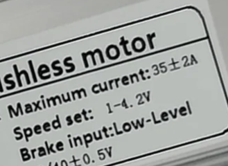

Water in the controller is probably the issue, but it would be worthwhile testing your throttle, and what range it's outputting.
When I was using a KT controller I discovered some odd behavior. The valid throttle range for your controller is written on the label, for KT's usually it's 1v-4V
What I noticed is that below 1V there was a range where the controller would regen, separate from the brake lever regen, then below a certain point, the controller would "disconnect" from the motor and the motor would coast (as much as a DD motor can coast). I made a little circuit with a pushbutton and resistors to keep the throttle voltage minimum above that cutoff point and was able to use that voltage range below 1V and the cutoff for variable regen. It would regen to a lower speed than the brake lever regen would, since the brake lever regen would "freewheel"/coast once the speed dropped below 7mph, while the throttle mod would regen down to 4mph. Anyway, I used this for a little while, mainly for experimenting, but it occurs to me that if your throttle is not going to zero and outputting in this weird range, it could be causing regen.
