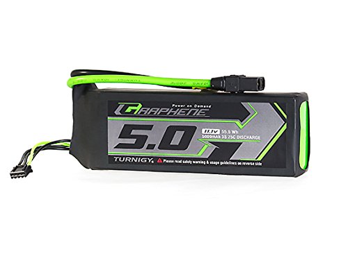

I've got two Lipo batteries and I'm not sure if any is good enough to use the the Kweld.
a) 4s (14.8V) 16,000mAh 10C (this would make 160A continuous)
b) 6s (22.2V) 5,800mAh 25C (145A continuous)
Could I use any of this batteries with this spot welder?
They are both likely produce enough current, a because of its high capacity, and b because of its high voltage. But this also depends on their brand and age, because of their internal resistance.
I can't really recommend either, because their current ratings aren't high enough. I have made some comparison tests, and Lipos that are too weak tend to either swell quickly, or even have their cell interconnects break. Only the ones that I have linked in the kWeld page on keenlab.de got my approval after these tests. Customers are using other similar models and brands with success, but they all have 300A+ rated current in common.

btw: building a highpower battery with 40T right now.
0.3 nickel. i have a 65C Graphene 6000mAh Lipo as Power source.
XT90 melted now. 5-6 welds and you cant touch your probes :p
took a fan to cool down everything. but melted anyway.
after replacing to XT150 i stepped up from 1350a to 1650a and got better welds.
but damn ....0.3 nickel isnt the best idea =)
