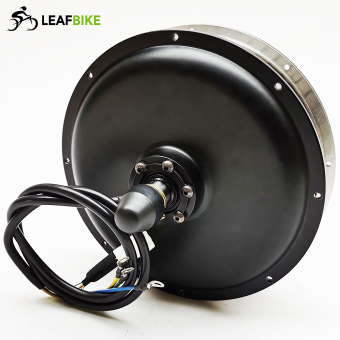

Hi,
I am in the process of building my first electric bike and need to choose a motor.
Here is a photo of the bike:
It's a 26-inch aluminum frame, 135 mm dropouts.
I will primarily use the bike for commuting to university and work, covering distances of 5-10 km (3-6 miles) one way with a lot of 200 m (656 feet) up and down hills. My average speed will be 30 to 40 km/h (19 - 25 miles/h).
Do you think the 1500W Leaf motor is the right choice?
I am also considering the GMAC and the H212.
The GMAC seems to be more efficient at my required average speed, but it cannot do regenerative braking and may require more maintenance.
The H212's advantage, I believe, is its true 135 mm dropout design, although it has lower efficiency.
Currently, I have a 9-speed cassette on the rear. Would it be possible to buy the cassette version of the Leaf motor and use it without changing the derailleur, the cassette cogs and the shifter if I remove one of the cogs?
I am a bit concerned that this version of the motor might be too wide to fit properly in the frame.
Thank you in advance. I really appreciate your help.

What is the rear dropout width? The Leafbike 1500W needs 137mm to fit, and with some leverage, 135mm dropouts can be pulled apart just enough to fit the Leafbike 1500W.
You cannot go wrong with this motor. It's very reliable, well-built, is among the best on the market regarding efficiency, and relatively easy to work on. But which motor among those listed is the best for you really depends upon what your goals are.
The GMAC may see an upgraded version in the near future that allows freewheeling and regen.

The GMAC CAN do regen...it does not have a freewheel clutch like the MAC:
A 10T GMAC laced in a 26" rim would work or a 5T Leaf 1,500w motor would work...those two would be my recommendation.
Use the Grin Tech Motor Simulator to compare the performance of the two motors and that should help you decide which one to go with. Depending on how long and how steep your hills are, the GMAC may run too hot. If you run a 5T Leaf on a 14s/52v battery and put Statorade in it, you will be better off from a "Heat" perspective than with the GMAC.

Got an answer from Leaf:
"A and B are the same. But, because works with 60V battery. It's too fast. Sometimes, we will use slower speed winding rotor."
