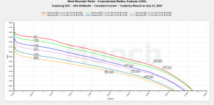

Why? One cell is capable of a 35A discharge, and I will have three in parallel. Won't a peak of 105 battery amps be enough?
You never want to run your cell at the maximum advertised discharge rate. That's where you make just barely enough heat to not damage/blow up the cell. This is the single cell limit for heat, not the quality of output. You need a ton of thermal headroom in an actual battery pack when you've got 100 cells cooking next to each other. Take that maximum discharge figure and cut it into a third basically.
Here's a discharge graph of that cell. Performance below 10A is pretty stout for a high-ish energy cell,
but during a 30A load on a single cell you can expect a 50.4v battery to drop down to 46.2v which is pretty saggy. You're also turning ~10% of your battery's energy to heat at that point if you do it continuously.
And the worst part is you're missing ~10% of your power at the motor.
So while you can do it, expect a quite short range, battery life, and rapidly increasing sag as the battery ages. when running a high power motor like this. You really want more cells in parallels for best enjoyment and reliability ( try 5P minimum )
Okay, you're right - those are maximum and undesirably high currents.
Let's assume that in normal operation I don't have to draw more than 10A per cell. Is that low enough to not harm the battery even in continuous operation?
