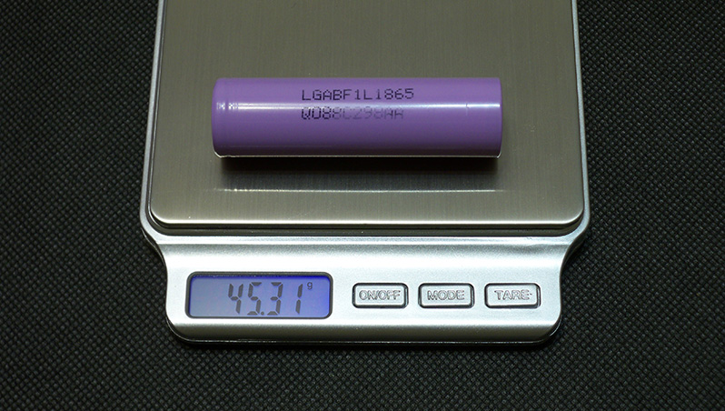

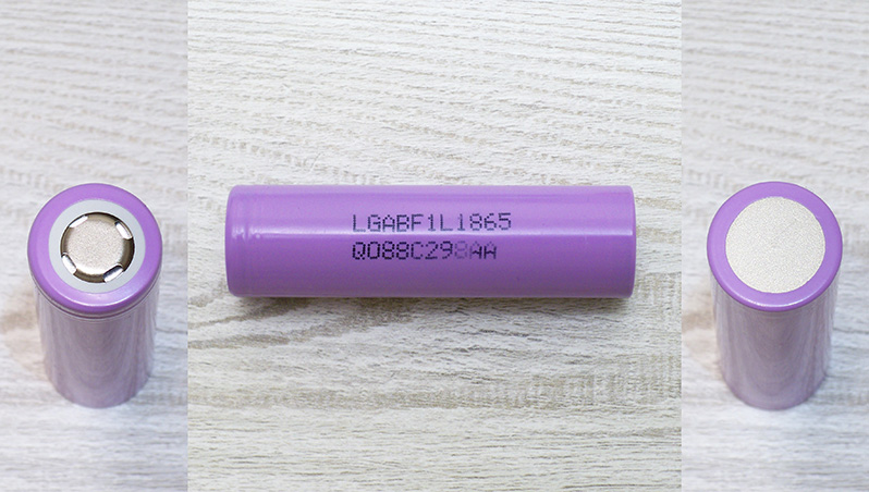

LG INR18650 F1L
My cell has the following marking: LGABF1L1865 Q088C298AA. According to BatteryBro Q248 means that the production date is March 2017.

Weight (max): 49g
The measured weight of my F1L cell is 45.31g

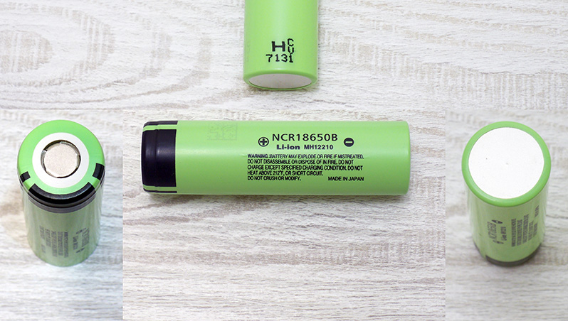

Panasonic NCR18650B
The cell which i've tested has the following marking: H CV 7131. BatteryBro says 7131 means that the cell was manufactured in Jan 2017.
Specs from datasheet:
Typical capacity: 3350mAh at 25°C
Minimum capacity: 3250mAh at 25°C
Nominal voltage: 3.6V
Standard charge current: 1625mA (0.5C)
Charge end voltage: 4.2V
Charge cut-off current: 65mA
Max. dischg current: 4875mA (1.5C)
Discharge cut-off voltage: 2.5V
AC impedance at 1KHz: ≤100mΩ
Weight: 48.5g

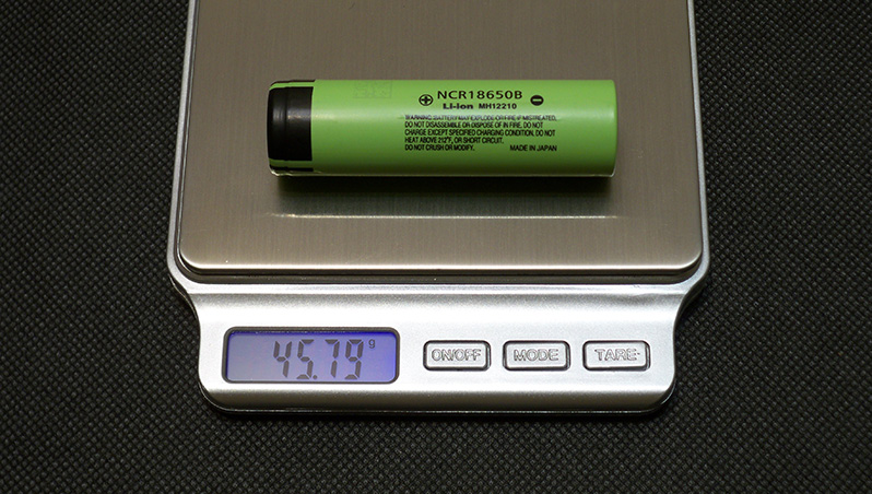

The measured weight of my NCR18650B cell is 45.79g
Test results:
At 0.2C (0.65A) NCR18650B's capacity is a bit higher than 3300mAh but still lower than 3350mAh. At 5A 3162mAh and 10.40Wh look not bad.

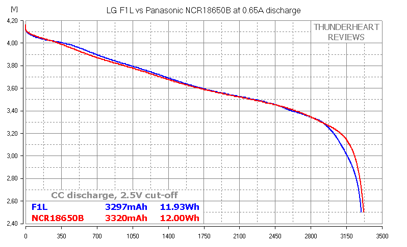

Let's start with 0.65A (0.2C) discharge:
Very close results. NCR18650B is a bit better, but the difference is not significant.

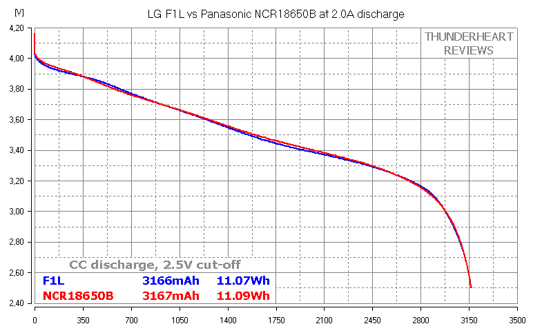

At 2A discharge:
No difference at all! Just like twins!

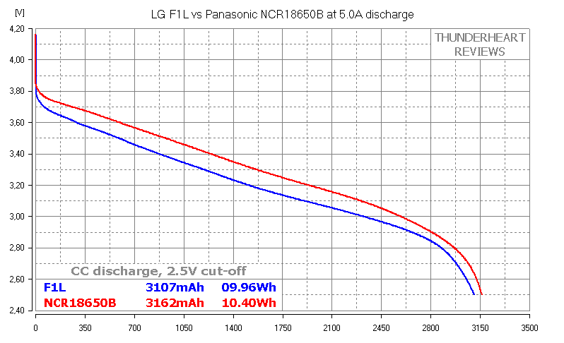

At 5A discharge:
NCR18650B at 5A leaves F1L behind with 55mAh / 0.44Wh difference. Not a huge advantage though.
CONCLUSION
Panasonic NCR18650B seems to be just a bit better than LG F1L but the difference becomes visible only at 5A. The price plays the first role here - Queen Battery sells NCR18650B for $3.9 and F1L for $2.6 so F1L is a smart choice i think.
