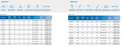

I am taking this opportunity to include a roadmap for 2024 by Lishen which shows, amongst others, two 4695 cells (energy and power variants, 33Ah and 30Ah respectively) and two tabless 21700 power cells (4.0Ah and 5.0Ah):
I'd also like to include a roadmap schedule for the 46mm cylindrical series by Lishen that I found for the 4695 and 46120 formats:

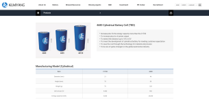

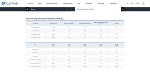

Anyone heard of Kumyang?
They're from South Korea and a newcomer in the cylindrical manufacturing area.
Their cells are high energy and rated for -3C max continuous discharge.
Their planned 21700 are:
  • KY INR21700-40P
  • KY INR21700-42P
  • KY INR21700-48E
  • KY INR21700-49E
  • KY INR21700-50E
  • KY INR21700-53E
  • KY INR21700-55E
  • KY INR21700-58E
  • KY INR21700-60E
There are also 46mm cylindrical cells:
  • KY INR4680-270E
  • KY INR4695-340E
  • KY INR46110-410E
  • KY INR46120-460E
(Seeing the "E" makes me think that "P" power variants may also be under consideration. 😎)
More information here:
Kumyang Co., Ltd.
Kumyang Co., Ltd.
Extracts (for posterity):

yea, looking at the chart above, some of the Lishen cells say 60% after 300 cycles, that also seems horrendous. Assuming contractors buy power tools that use them, and assuming they use them for 2 cycles a day, they will have lost almost half of their capacity after 5 months? wow
Yes. If you're using plain CC-CV and don't even have proper passive cooling at the end of the discharge, your cell will die rather quickly.
There's a reason phone makers and EV makers are hell bent on maximizing charging efficiency through the usage of better charging algos and active thermal management.
Heck, even CP-CV (Constant Power Constant Voltage) charging will help cycle life decently, so it should be the basis to all modern chargers, but it currently isn't.
