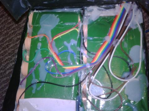

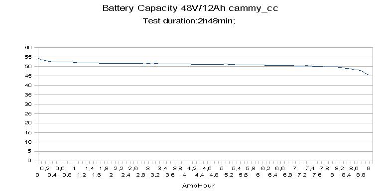

Just a quick update concerning my Cammy 48V/12Ah battery.
This is the initial plot:
After 10 cycles, still 9.2Ah so no real improvment and far from 12Ah. Seems that all the elements are quite well balanced. After a full charge, each one them are at 3.8V. After a full discharge, all of them are at around 2.7V with one at 2.5V. If I recharge only this one, another one reach 2.5V after 0.2Ah.
This is what you can see inside:
Not really clean assembly !
dogman said:
Just try to find one with prismatic cell packs. The eastjimmywu round cell ones have had some real problems.
It seems cammy's has the "round cell ones" from the above picture. Oh well, we know where this is going. :lol:
