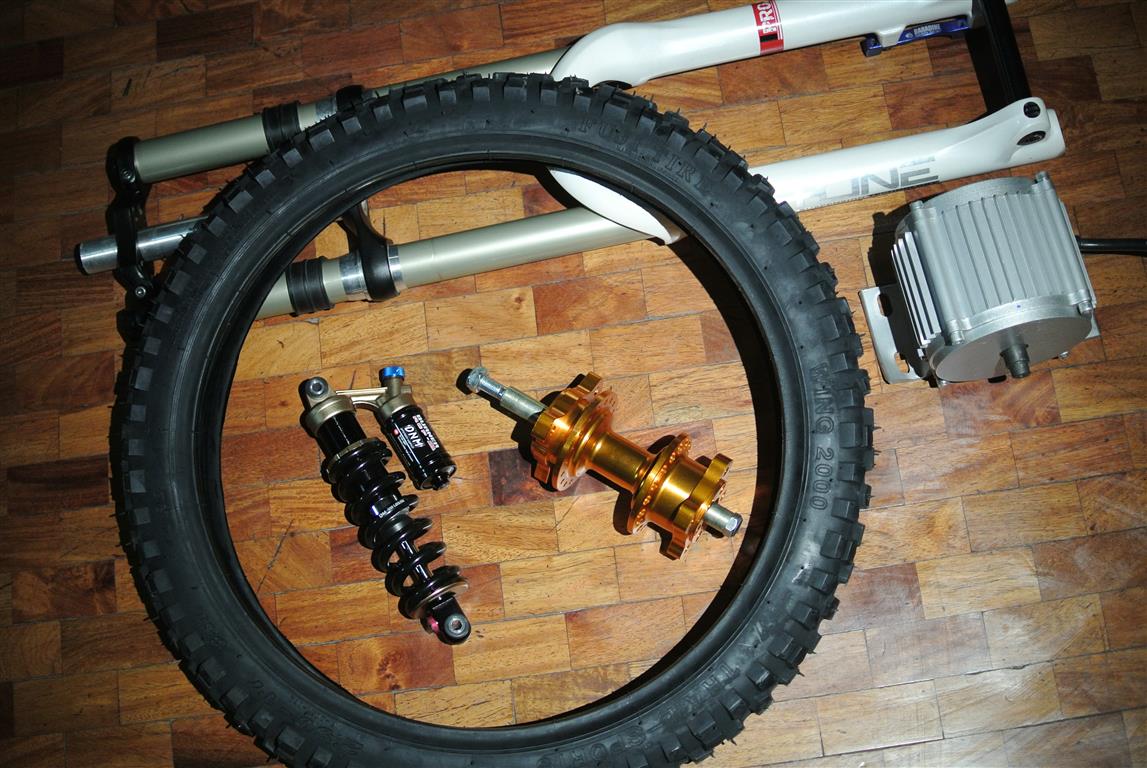

so after nearly 2 years w/ my GNG kit I've decided to do another build. design goals:
1) 50kph MAX, must climb very well
2) single-stage reduction for simplicity/reliability
3) no pedals
4) 18s, 40ah, 18650 pack, no BMS
5) moped rear wheel 17x2.5 knobby, DH MTB front wheel 26x2.35
6) custom steel frame
already got some parts ready now i need pointers on selecting the proper sprockets combination. i was thinking of using #35 chain

It looks nice and not too bulky for ebike.
I've weight my bicycle rim (regular bicycle wheel) with hub without tire and it weights 900 grams.
What is your:
hub weight,
rim weight with spokes,
tire weight,
and rim diameter?
How does it look compared with regular bicycle wheel? In case you got some laying around wheel to compare.

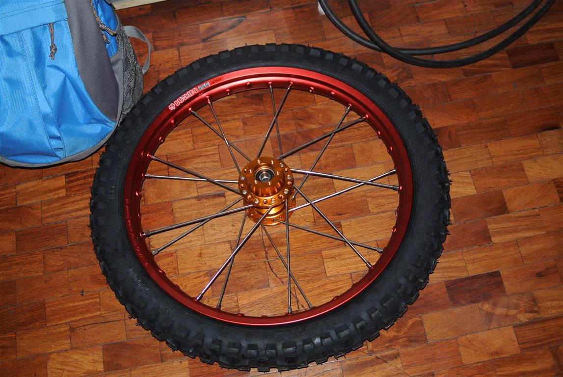

I also feel that i got to use light motorcycle or pit bike rim instead bicycle rim. When i look to my bicycle rim i can't believe that it might cope with more than 2kw mid drive, but maybe i just too precocious
downhill mtb components are tough but i'm going w/ light-moto rear wheel this time because MTB tires wear out too quickly and i need a wheel that's smaller than MTB 26"

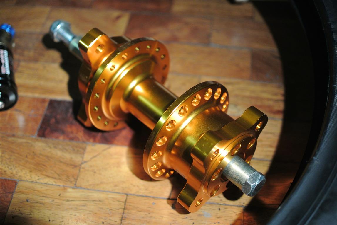

this is 17" x 1.4" rim
here are the weights:
a) knobby tire 17"x2.5": 1970g
b) tube: 420g
c) rim: 880g
d) hub: 580g
e) 36 spokes/nipples: 540g
tire is about twice the weight of a wire-bead downhill tire. for just 1kg more you get a lot better flat resistance and tread life
rim weight is actually competitive w/ a wide DH rim
hub is about 200g more than a downhill rear hub

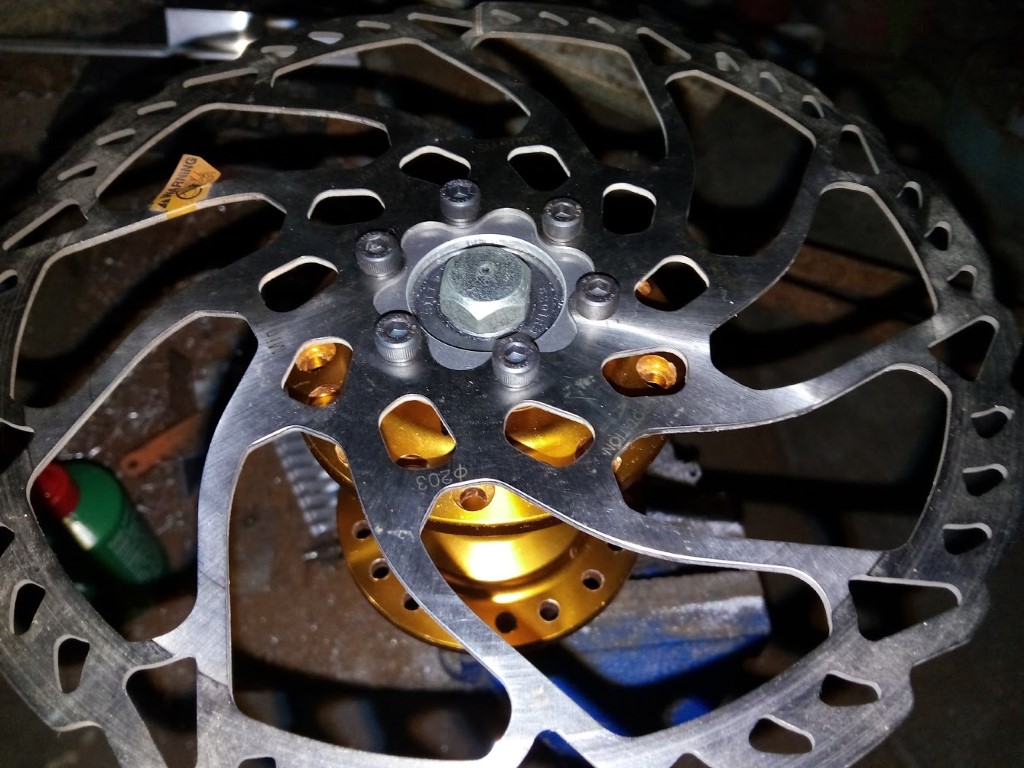

i'll be using MTB rotor:

It surprises me that bicycle rotor fits mini mc hub.

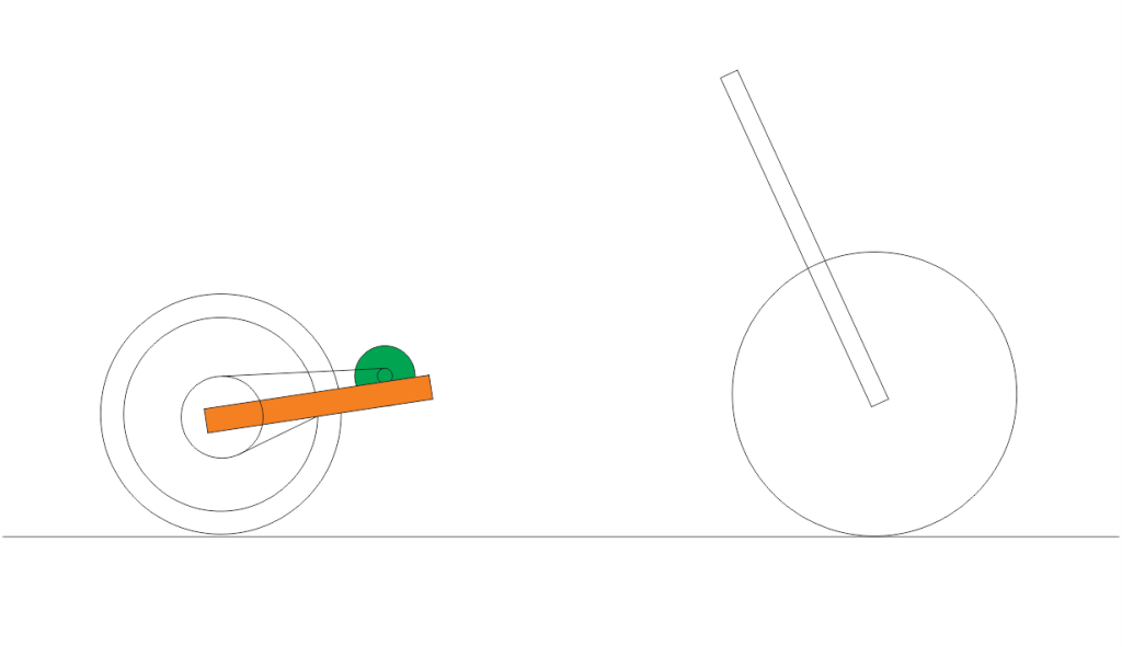

quick and dirty sketch but drawn to scale. rear wheel w/ tire is 22" OD. front is 26" OD. shouldn't look too bad. if it does then i'll use 18" or 19" moto wheel in front :)

actually the holes are off just so slightly
got these moto parts from some local shops around here

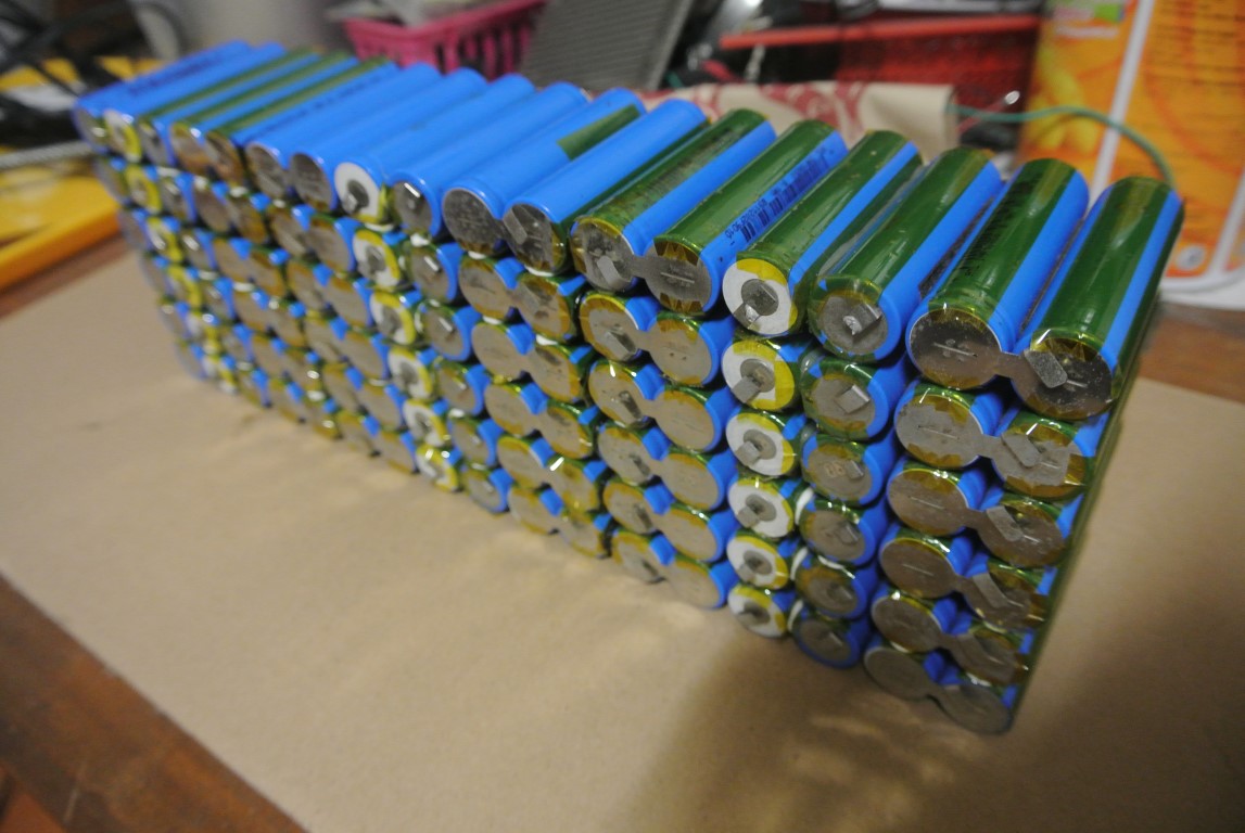

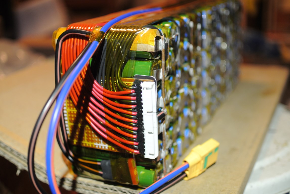

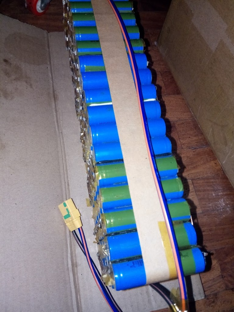

sorry for the lack of updates! been sidetracked by a few things. anyway here's one half of the battery pack. 17s6p. cells are Amperex ATL INR18650 2200mah. to be paralleled with 17s6p Samsung 26F. combined, these cells should easily provide the 42A needed by the cheapo controller

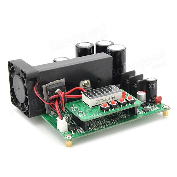

charging to be handled by this 900W dc-dc digital boost module:

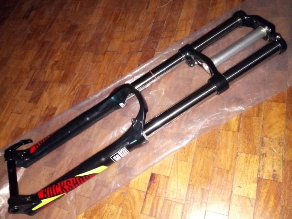

i just picked up this Rockshox Domain to use instead of the crappy RST R-One :roll: heavy steel stanchions perfect for lightweight e-motorcycle 8)
this motor is supposed to be 36KV
i'm getting 2491RPM @ 67.5v, unloaded. close enough
this calculator says i'll get around 28mph or 45kph if i use 13t motor sprocket and 52t wheel sprocket

Altair said:
Cool!
What brand is your discharge monitor, it has a nice display.
https://www.aliexpress.com/item/DC-6-5-100v-100A-LCD-Combo-Meter-Voltage-current-KWh-Watt-Panel-Meter-12v-24v/32546106421.html
100v 100a external shunt. i'll be using it on this build as well

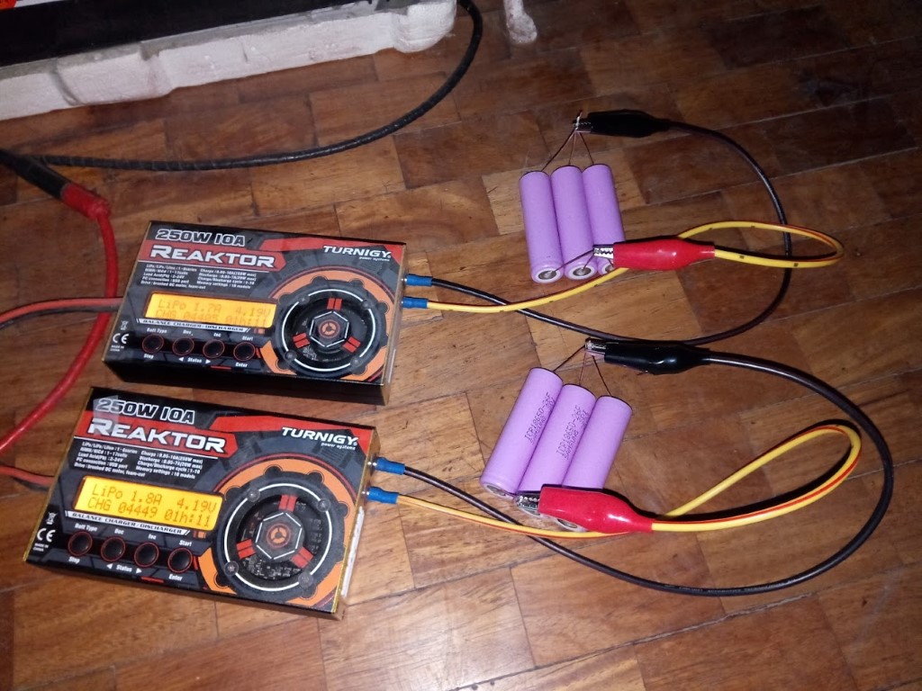

now cycling these 6 cells to match the capacity/IR of my 96pcs used cells. these six BTW came from the same batch. i just need to wear them out a bit to prevent balancing issues

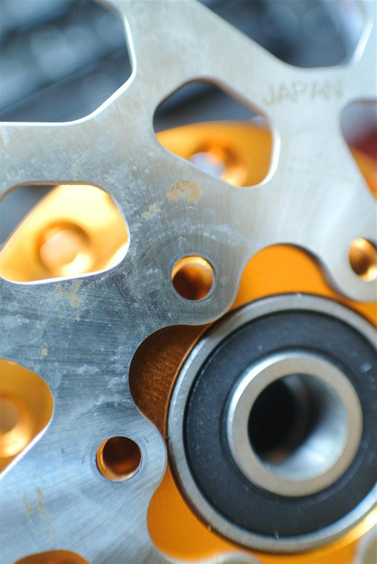

drilled and tapped the hub to attach the 203mm MTB rotor
i decided to use relatively heavy #420 chain and sprockets to make it as maintenance-free as possible, since i'd be riding this through abrasive sand. the #420 should take a while to wear out

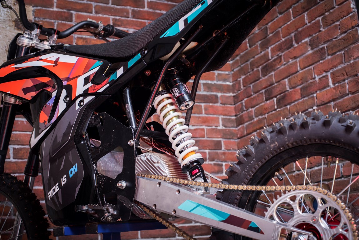

will start soon. it'll have similar layout as the Deller i.e. motor is concentric w/ swingarm pivot
