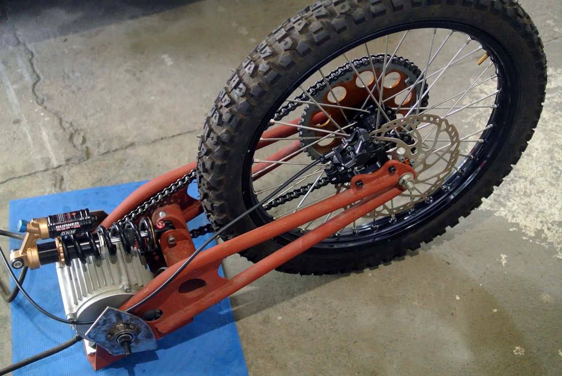

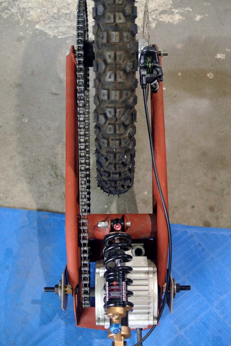

You could add a plate on the other side of the thin slotted motor mount area. Drill holes the same as your motor mount bolt pattern and use set-screws to set the chain tension by jacking the plate forward against the swingarm mount. This would also help to gusset the thin area you are concerned with by locking the whole motor mount flange together. Something like this:
