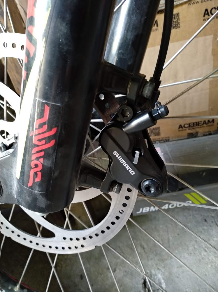

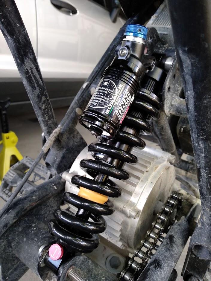

just got a budget quad piston for the front only. the rear tire is already easy to lockup
working great so far. i also got these 203mm rotors. thicker and heavier than shimano RT-66 that i replaced. 250g each. seems to be more powerful too, probably due to having more contact area i.e. less drilled out

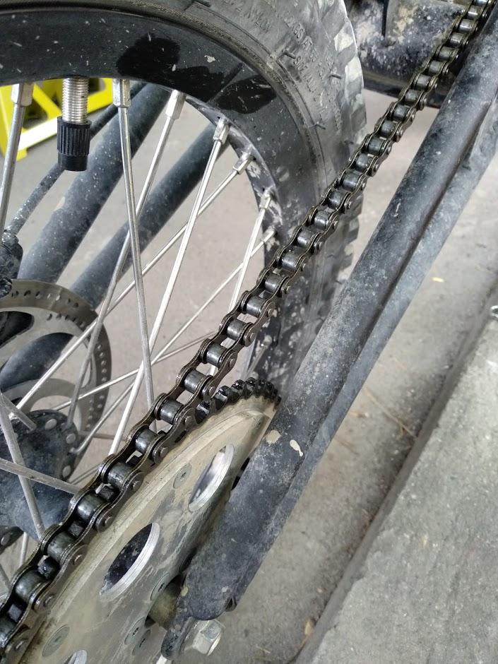

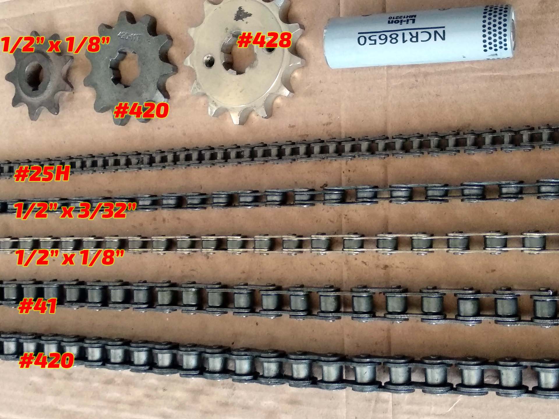

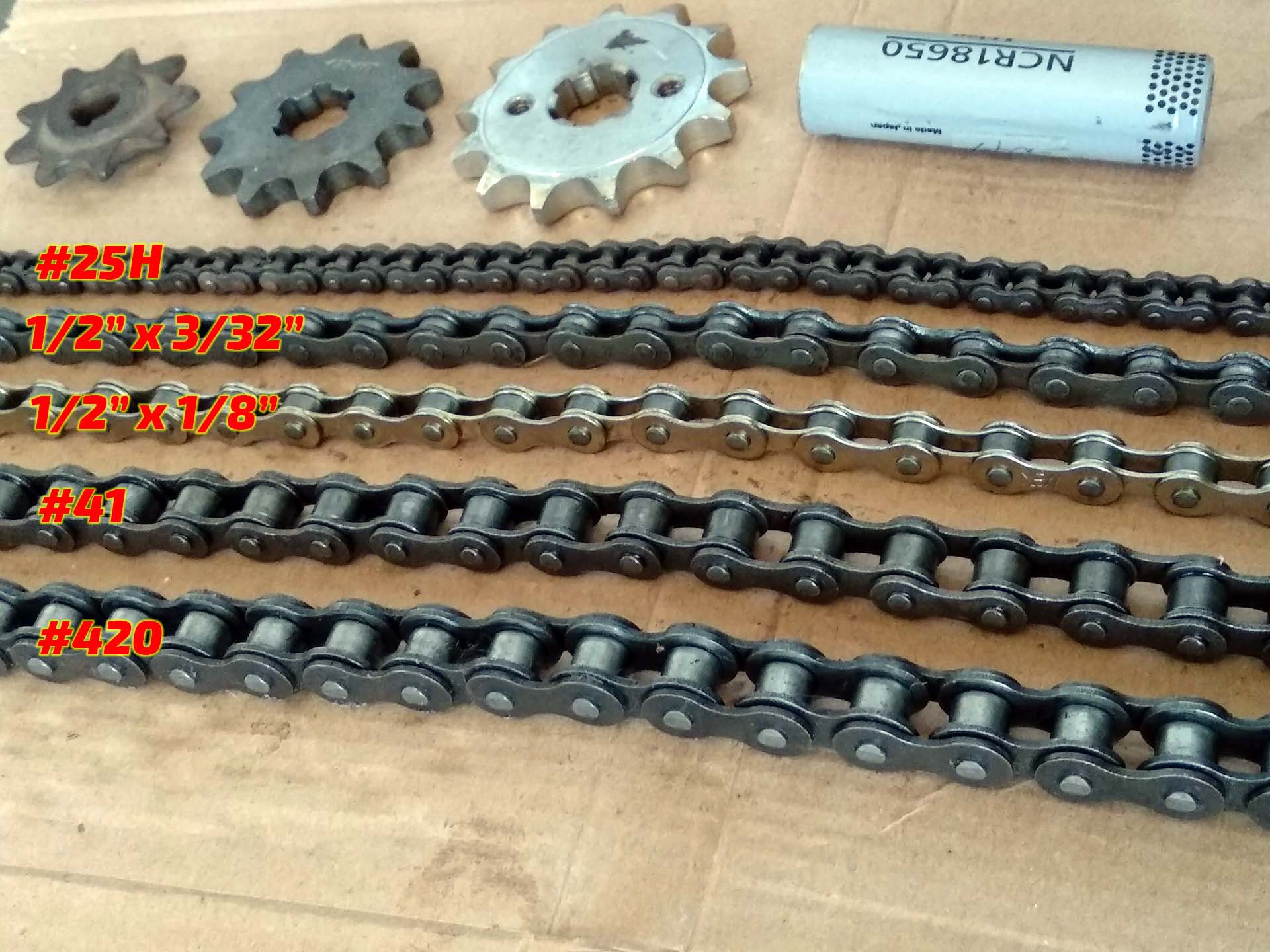

i just got 4 boxes of #41 chain (10ft/bx). interestingly #41 uses the exact same size sprockets as #420. much lighter weight. slightly smaller pins. we'll see how fast it wears out...
i'm also posting these side-by-side pics of these various size chains because i couldn't find any proper pics on the web. top to bottom:
- #25H
- 1/2" x 3/32" (for 6 7 8-speed bicycle)
- 1/2" x 1/8" (also known as #410, for single-speed bicycle)
- #41
- #420
I've found the same conclusion. I use 180mm on rear wheel since is enough to lock up, 203 in front.
Up to now my prefered brakes are the Shimano Zee. https://www.chainreactioncycles.com/shimano-zee-m640-disc-brake/rp-prod82434 , quad piston designed for downhill, amazing modulation.
Those 203 rotors you have look thick. Are the usual 1.8mm width? Magura makes 2.0 rotors by default. Talking Magura, I purchased one MT5E, these come with brake cut switch and are flip flop (you can use left or right). https://www.amazon.com/Magura-MT5E-Carbotecture-Bicycle-Brake/dp/B01EQS1Z6O . Last years I've been using other Magura device to make the brake switch ( https://www.amazon.com/gp/product/B015DJWWM6 ) but I can't find any dealer that carry these anymore. That makes me ask... do you have a brake switch on the brike?
minde28383
Apr 2, 2010
698
Tektro makes 2.3mm
These are coupled with brake supports designed for up to 45km/h as they advertise it.
Usually brake rotors are ~1.8mm
Ps. Chinese brakes comes with thin regular brake rotors and are advertised as brakes up to 45km/h.
Never tried but I think before mentioned magura brakes are good brakes. In the same price range as alternative comes tektro hd71x, hd72x.
https://www.aliexpress.com/item/new-arrival-bicycle-brake-rotor-bicycle-rotors-MTB-rotor-203mm-with-bolts-SH-rotor-7b/32540715682.html
1.9mm
no brake switch. yes i know, dangerous :lol:
