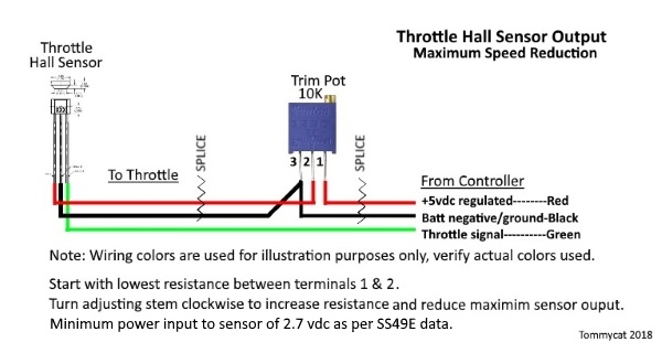

Hello EV friend,
i need your help. My problem is that most affordable controllers are not programmable and do only have a 3 speed switch to control max. speed. As far as i know the 3 speeds are 80%, 100% and 110 %, but what if the lowest speed option is not slow enough (max. 25 kph/15,5 mph) to be legal at a police control ? Is there a way to install a hidden potentiometer or switch to limit the max speed ?
Thanks for your help
best regards
Sparfuchs, Vienna
I am a little bit sceptic about this schematic, it will lower voltage for hall sensor, and it can stop working under some voltage like 3V... Better i thing is connect trim pot as voltage divider from hall output, and centre of pot connect to original wire to controller
Perhaps this output graph will help you...
2.7vdc to be closer... Just a hair over half throttle input.
Keep in mind that this would also lower the home position voltage, creating an unwanted front end dead spot before throttle actuation.
