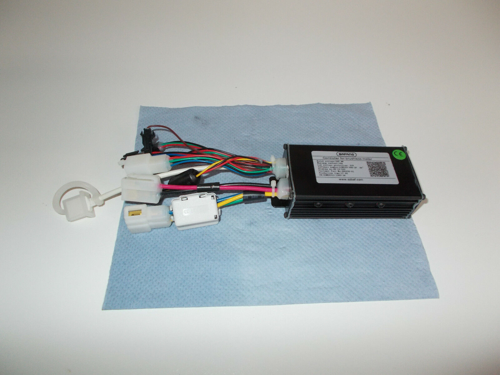

It's arriving to me a new Lishui controller 12 MOSFETs, with 860C display.
It seems board will be LSW12G... something.
Bafang hub motor for testing is G060.750.DC
I'd like to test the open fw by uploading on display connector.
This is because I don't like to open the sealed case (don't have ST-Link, too)
Just have USB-Serial TTL Higo adapter.
Sadly, all connectors are Higo/Julet waterproof, so rewiring not possible at all.
I hope it's a "F" in the product number. Otherwise the controller is not suited for the Firmware. Where did you buy the parts? Is it a bundle?

Yes, I can find a "-F-" in the product code. It's a new model powerful controller, bundled with 860C. Don't ask more :mrgreen:
:thumb: Can you tell me the source? Per PM, if don't want to make it public...

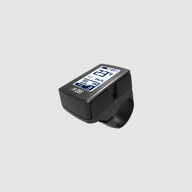

The J-LCD protocol is much easier, but it's hard to get a display, that uses this protocol.
Yes, you are right. J Protocol is much easier than 5S. And for us, display with both J & 5S protocol is available.
Are your displays buyable for anyone, or do you sell only to OEMs / dealers?
Can you post a link to an online-shop?
regards
stancecoke
Yes, usually we provide directly to OEMs. But possible for after-sales service. Means if you are using our display and need some help, like a replacement, we'd like to help.
If you need for testing, please confirm the J or 5S protocol and pins definition for connectors, then I can also prepare samples.
Actually I don't need a new display, but in the german forum are frequent requests from users, who want to replace the simple OEM LED-display (eg. "Fischer" or "Prophete"-Bikes) with LCD displays. Or want to replace the stylish but small LCD display (I don't know, if it's a KingMeter product) with a bigger one.
fischer-e-bike-mtb-montis-2-0-2019-perlweissy-matt-275-rh-48-cm-hinterradmotor-4-4-360x360.jpg
https://www.pedelecforum.de/forum/index.php?threads/fischer-montis-2-0-led-display-tauschen-zu-lcd.64078/post-1217280
https://www.pedelecforum.de/forum/index.php?threads/rex-graveler-e-9-6-vs-8-7-aeg-easy-display-vs-multifunkionsdisplay.63097/post-1194279
They will be happy to have a source for the alternative displays, I think!
regards
stancecoke
Usually if the original display in ebikes is LCD(LED), then it's easier to change into LCD(LED). But if LED change into LCD, there would be more parameters shown on the display, means we need more testing. So we can not provide for personal. As for Fishcher & Prophete, it's all customized display. Sorry we can not change it per each rider's request.
Hello! And have I understood right? - Do the original Lishui controller use 5S UART protocol?
I'm looking for a small display for my Lishui controller to exchange the huge SW900. KT-LCD4 is the best in size, but don't work with the "stock" Lishui. SW-102 from Wuxing (Star Union / Topology) is 2 times more expensive, but also don't work with Lishui "from-the-box". And it also haven't possibilty to set up parameters by display, like LCD4 with KT controllers or "big" SW-900 with Lishui. DZ30 and DZ40 from Wuxing (Star Union / Topology) is also candidates, but I guess, that they also will not match.
What protocol needed for matching and correct work with "stock" Lishui? 5S or J-?

But if you are using a SW900 actually this should use the KM5S protocol. If you want something small, you can use this tiny Key-Display
It's sold as EBS Nano in Germany.
This uses the KM5S protocol, too. But no guarantee, that the handshake works. You can set the parameters as used from the SW900
