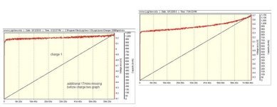

The icharger wont charge the cell if set to Lilo type ( assuming lilo is for lithium cobalt oxides), but it will charge the cell if set to nicad manual charge. Using the nicad manual charge at 1amp the cell has charged up. It doesn't follow the standard lilo charge scenario though. Here is a charge graph:
The charge graph is broken into two parts, due to a hickup using icharger on this laptop. The screensaver was set for 10mins, for some reason this stopped the connection between icharger and computer, so I had to restart the charge.
Setting screensaver time for a long period solved the disconnect problem between icharger and this laptop i'm using.
Inbetween the graphs was a 15min period where charge continued on icharger but I didn't log it.
I'm currently doing another charge graph that i'll post shortly.
What it shows is that a higher voltage is required than the standard lithium charge ( lilo or lipo) on the icharger.
If I try to charge the cell on lilo or lipo the cell goes directly to 4.1 or 4.2 volts and the amps goes very low, I assume the icharger is using internal resistance to gauge when to go into constant voltage stage and lower the amps.
Using nicad charge ( manual ) on the icharger allows the voltage to go higher, it sits from 5.2v at start of charge and goes to
5.7v near end of charge. Once the cell is off the charger it settles back down to 4.2v and holds that voltage.
The cell has a high internal resistance ( 1355mohm....assuming the m is milliohm?)
So the higher voltage seems to overcome that high internal resistance and allows the cell to charge at 1amp constant current,
it also means there is no constant voltage stage in the charge.
I stopped charging when the graph started to get fairly steep instead of a steady increase in voltage, which gives some indication when the cell if getting full. There was no temperature increase in the cell as far as I could tell just touching it by hand.
