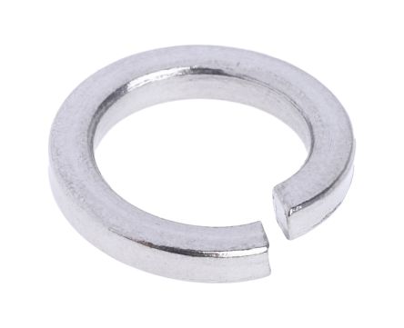

Is that a pressure washer (aka spring washer) ?

yea, thats what i was thinking of, forgot the name. but if theres room for it maybe try one of those :}. if the axel is loose in the drop outs (can rorate at all) itll undo the bolts aswell

I can add a spring washer, but then there will be even less whole-threading, so I just applied loctite to the axle, I'll test it soon :thumb:
