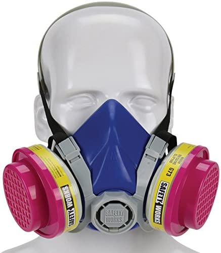

This thread is about the engineering challenges of making a reasonably effective DIY respirator. All responses that do not specifically address that will be considered "off topic" and they will be moved to an appropriate thread.
With the shortage of N95 "disposable" dust masks, I feel that the best way forward is to identify ways to make an effective respirator that can be sterilized and re-used, along with a readily available filter media that can be replaced as often as necessary.
A "mask" catches your cough and sneeze to help reduce the probability that you might infect the people that are near you when you have some type of flu. A "half-face respirator" covers your mouth and nose to prevent you from breathing-in a mist from a nearby person who has coughed or sneezed.
The top pic (below) is the now-famous "N95" mask, and the bottom pic is a half-face respirator. Notice the metal strip across the nose-bridge to help hold the shape of the filter to your face in that area.
As a woodworking enthusiast, I have occasionally used a "dust mask" to avoid breathing in fine sawdust that was floating in the air (table saw, router, etc), and I found them to be grossly inadequate, especially if I was suddenly required to talk, which flexes the "barely adequate" seal around my face. It may "catch" my own cough, but as far as breathing-in the air near me, it was less effective than holding my breath for half a minute.
I am not a certified medical professional, but I have worked for many years in the past with a "hazardous waste" clean-up company, and I was required on many occasions to work while wearing a respirator.
A popular alternative DIY filter media for a viral breakout is the "HEPA" filters for home air-conditioning units, or HEPA vacuum cleaner bags (HEPA = High Efficiency Particulate Air). Be aware if you are using a common dust mask, a HEPA filter of the same size will be somewhat restrictive to flow the same amount of air, due to how dense it is, in order to capture smaller particles. For a HEPA filter to flow the same amount of air, it should have more surface area.
I like cylindrical bottles for the filter housing because the filter media can be held on by a common "hose clamp". In order to provide a stiffer place for the hose clamp to tighten against, I am showing a white disc with holes that I cut out from an HDPE kitchen cutting board. It drills and cuts with a jigsaw quite easily. Another method shown here is the red plastic sheet that was cut into a ribbon from the lid of a common plastic storage bin. Either one of these reinforcements can be epoxied-inside the bottle. Large hose clamps can be found in the large hardware stores in the sections where a clothes dryer vent is socked, or the central air conditioning duct section. Or, you can connect two hose clamps to each other to make a larger one.
The bottle can be cut shorter to make the filter housing more compact, or the extra length can be filled with activated charcoal from an aquarium supply. If you add charcoal, wrap it in a paper towel to prevent breathing-in any charcoal dust. The standard water-bottle cap opening is adequate to breathe through, and a single filter is adequate for a trip to the grocery store. The common industrial OSHA respirators (shown at the top of the post) have two filters because they must be able to operate for a 12 hour shift without becoming clogged.
On the left is a common 9-ounce water bottle for scale, next is a slightly fatter "one liter" beverage bottle (with filter media attached), then a half-gallon vinegar bottle I had that is 4-1/2 inches in diameter, and last is a one-gallon jug of chlorine bleach, 6-inches in diameter. I found the soda bottle with the paper filter on it easy enough to breath through, but the half-gallon jug would provide double the filter area if that was desired.
The entire premise of this build is that it's not ideal to be depending on disposable masks that make a poor fit, and you must constantly be looking for an additional supply. If you make a respirator that is formed to fit your particular face, it will fit well. Then, use a filter media that is readily stocked and easily found, along with being very affordable. HEPA vacuum bags are such a filter material, along with the filters from central air conditioning units.

The filter media (sheet of HEPA filter paper) can be thrown away. The respirator itself can be sterilized by wiping it down with alcohol, hydrogen peroxide, or heating it to a minimum of 140F / 60C for 30 minutes. Higher temps will reliably kill all pathogens in a shorter time, but higher temps may also damage the respirator depending on the materials used to make it. It can also be exposed to ultraviolet light (UV).
If you are fortunate enough to have acquired a factory-made half-face respirator that fits you well, do not throw away the filter cannisters after they have been used up to the allotted amount of time. They can be gutted and then covered with new filter media made from HEPA filter cloth.
Making the face-cup
One option, a semi-rigid flexible and heat-shapable plastic/rubber (Polycaprolactone)...You make a mould (or 3D-print) of the shape you want, you put a measured amount of this plastic into boiling water to soften it, then press it into the mould.

There are now dozens of youtubes about making a DIY respirator, and the most often used candidate is the top or bottom of a plastic 2-liter soda bottle.
In order to form the shape around the nose, a strip of thin steel sheetmetal is glued onto the outside of the nose area. This type of thin steel sheetmetal can be easily found in the roofing repair section as "flashing". It can be cut with heavy scissors, metal-cutting shears, or a hacksaw (the file the edge smooth).
I received a tip, you might find a "full face snorkel mask" at a sporting goods store, or online. There are now several youtubes
Options for the seal between the face-cup and your face
Here is one option for the seal between a rigid 3D-printed mask and your face that I found to be useful.

Silicone caulk can be spread into a ribbon on a glass window or table, and once allowed to dry, it forms a rubber ribbon that can have one edge glued into the seal-edge of DIY respirator. spreading it on glass means that it can be easily removed by a wide razor blade.
An Idea I like is to cut a foam ribbon to make the seal between the respirator face-cup and your face, but the foam may the the type that is porous enough it can allow contaminated air through to the inside. I would take the foam and coat it with a thin smear of silicone. Silicone can be sterilized by wiping it with alcohol, or heating it to "just above" the temperature where a virus would be killed. Of course if you get the DIY respirator too hot, it would damage the type of plastics that are commonly used.

Improvised materials for the various components of an effective mask/respirator are important to identify. Just knowing that it is "possible" opens up an entirely new world of options.
There are dust masks in the hardware stores that do not actually work very well. It is easy to mistake them for a useful filtering protective cover. They might encapsulate any coughs or sneezes of the wearer, but they provide little protection from breathing-in the contaminated air around you. In this way, the "N95" mask reduces the possibility of an infected person from infecting others. A respirator protects the wearer from getting infected. In fact, if the respirator has a "exhaust valve", your breath can infect those near you.
An N95 spec mask has several specific features other than the shell being the filter medium.
1. It has two elastic straps instead of just one, this helps to provide a "better" seal around your face, especially if you have to talk with it on. Face movement disturbs the sealing effect.
2. It has an exhaust valve, so the wearer only breathes in through the filter media. Any exhaust goes straight out the "flapper" style of check valve.
3. It has a bendable and shapeable strip over the nose bridge. That area is the hardest part to attain a good seal. Every face has a different shape, so you will never find one mask that fits everyone.
4. The "P100" spec dust-mask has a higher performance rating than the N95...
With all of this being said, I opened up a certified official P100 that I have had for over a year. My work gave me several when I had to sweep out an area known to have rodent droppings in it. I noticed the seal was made from a thin foam that was similar to a mouse-pad on my computer. Even if you made a seal that was from the sleeve of a dish-washing glove, I immediately noticed that this was a very good way to go. It would work well, and would be easy to replicate.
neoprene (of which there are several types; you want something that very easily compresses so it formfits around other shapes it's pressed against, so much less dense than a mousepad).
Paul, EM3ev has masks and quick delivery.
If you want a mask for protecting yourself, it does all come down to the seal on the face. This includes any adjustments made by the user.
My wife retired from handling very hazardous waste once a week. They used supplied air masks that covered entire face, which were very fussy about the fitting. But they were pouring very strong shit that would cook your lungs to goo in one good breath. The real key though, was that the mask was positively pressured, so leaks were from in to out.
Make your homemade stuff the same way if you are serious about self protection, fan and filter, so the leaks are all hepa filtered air going out the vent. Can cover the vent with a cloth mask.

Someone sent me a tip, if you are looking for an affordable elastic strap, the cheap style of bungee cord has a LOT of them. maybe not the most desirable type of elastic, but as a last resort, they would be easy to find.
I agree about the edge seal, it is the key element. Right now I am drawn to the idea of using a common foam (perhaps thick weather-strip for windows?) and gluing it into the mask. Use a sharp razor blade to shape the foam to be as perfect a fit as possible, and then coat the foam with a thin smear of silicone.
i'm not sure if you mean the silicone to glue the foam to the mask, or to seal it to your face?
i'm pretty sure you don't want silicone grease (or uncured/wet silicone sealant) on your face like that, but petroleum jelly shoudl be safe enough. if you mean to put the silicone on it and let it cure, most of the common silicones at hardware stores are fairly "stiff" even in thin applications, regarding conforming to your moving/changing facial shape. (also, some of them put out toxic fumes for quite a while after "curing", sometimes weeks...you probably don't want those on your face either).
there are more flexible ones, but not usually in common stores--it's stuff you use for mold making, prosthetics, hollywood effects, etc.; it's probably a lot easier to just use the right kind of neoprene foam to seal with originally, so that it conforms better.
most of the window seals i've worked with are meant to have significant crushing / deformation pressures on them, so they generally are also kinda stiff and not truly form-fitting without those pressures. using that much pressure on your face is likely to be uncomfortable at best, over more than a few minutes; the necessary straps will be kinda cutting into the back of your head and neck, etc.
if it is very open-cell foam, and very lightweight, it may well compress and formfit correctly, but it may also be so open that it lets air (and contaminants) thru as well, defeating the purpose.
so it might not be as simple as it seems....
