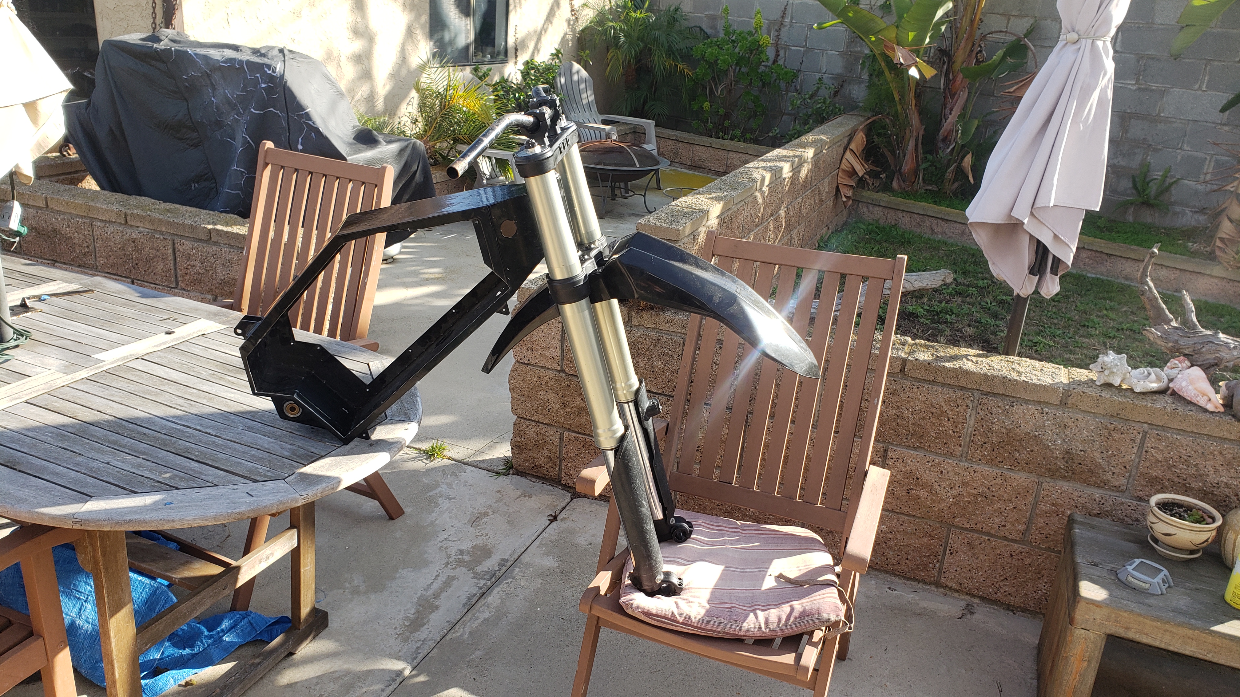

My last build was on a bomber frame and had a QS 273 and a KLS7230s, 72v30ah battery going almost 65mph (just over 100kmph) on a flat.
Unfortunately the bike got stolen and I haven't been able to get a trace on it, so I have begun building a new bike with a monstrous 72v70ah battery that had been sitting in my garage for over a year.

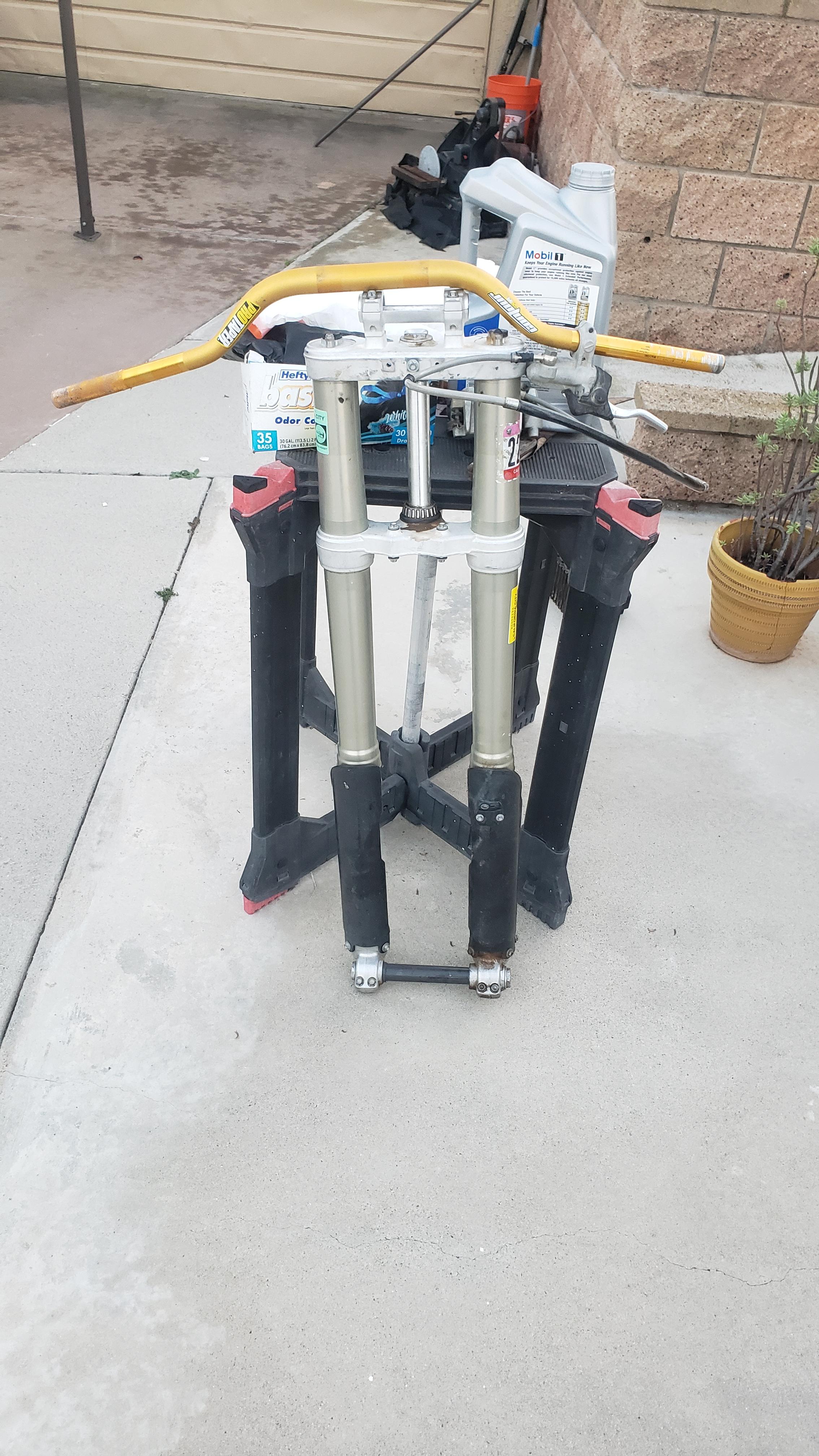

On craigslist, I managed to find a KTM 525 SX 2006 front fork with the triple tree along with the front brake (lever & calliper), all given to me for 200 bucks. STEAL.

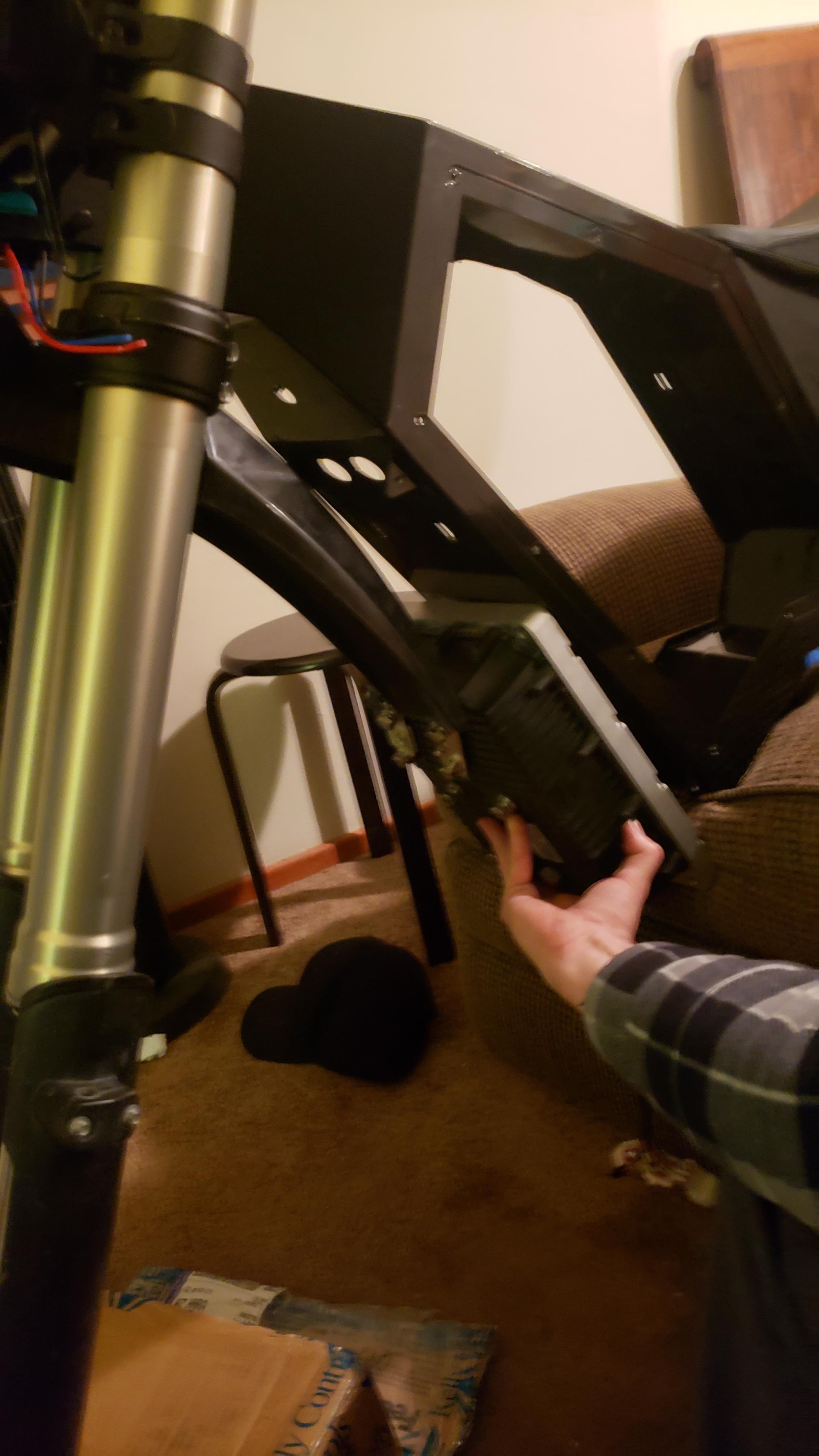

I did some grinding on the side of the stealth bomber frame to even be able to slide the battery in, because that shit is going to fill up like 90% of the space in the frame, wall to wall.
My old roommate has a mill down the street so I did some yardwork for him and he's gonna mill me a new sidewall to bolt up the side, 14 gauge steel.
I repainted the triple tree and clamps on the fork, cleaned it up, and would you believe it.. the steerer tube on the KTM is 1-1/8. It's a perfect fit in the bomber's headtube. No need for any steerer tube replacement, and you can use the stock headset. Talk about luck.

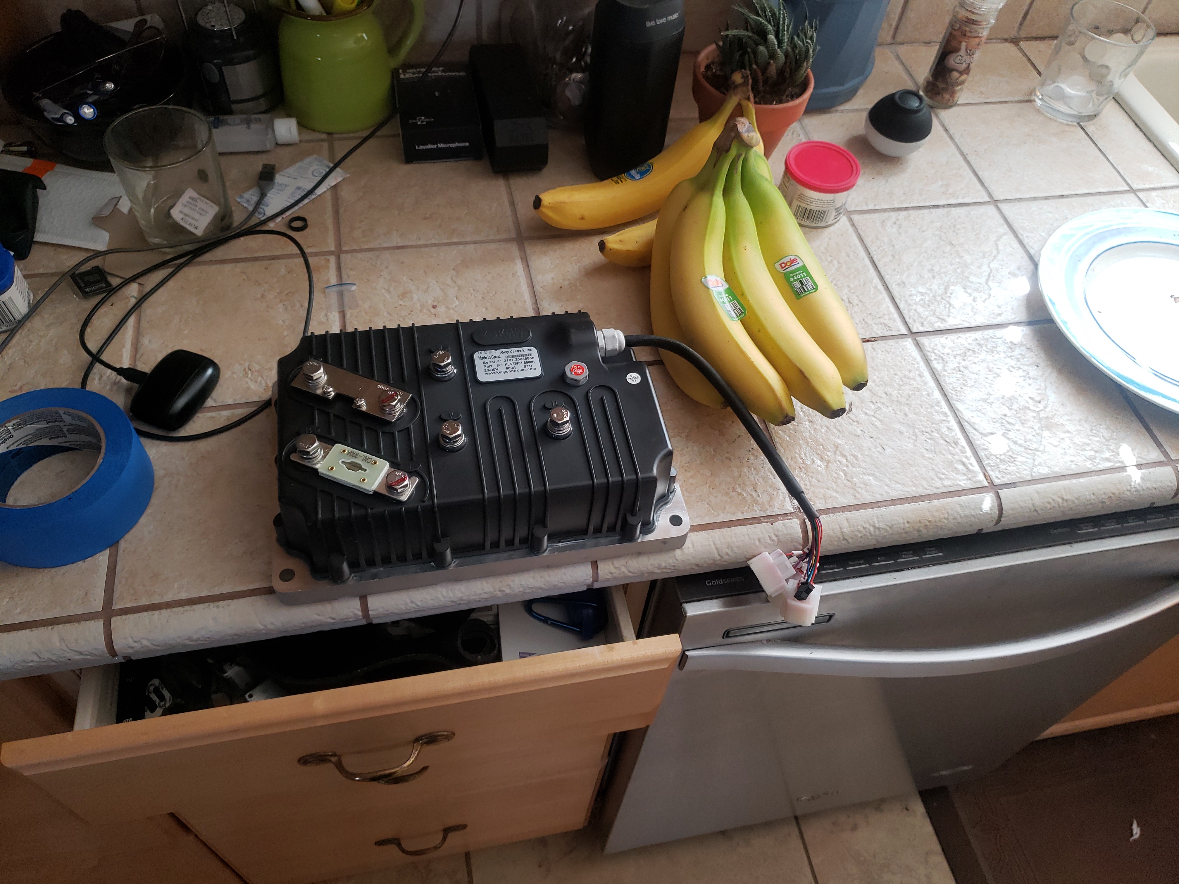

Edit: Forogt to mention. This time I'm going with the Kelly 8080h. 600 phase amps is probably gonna give me a heart attack.

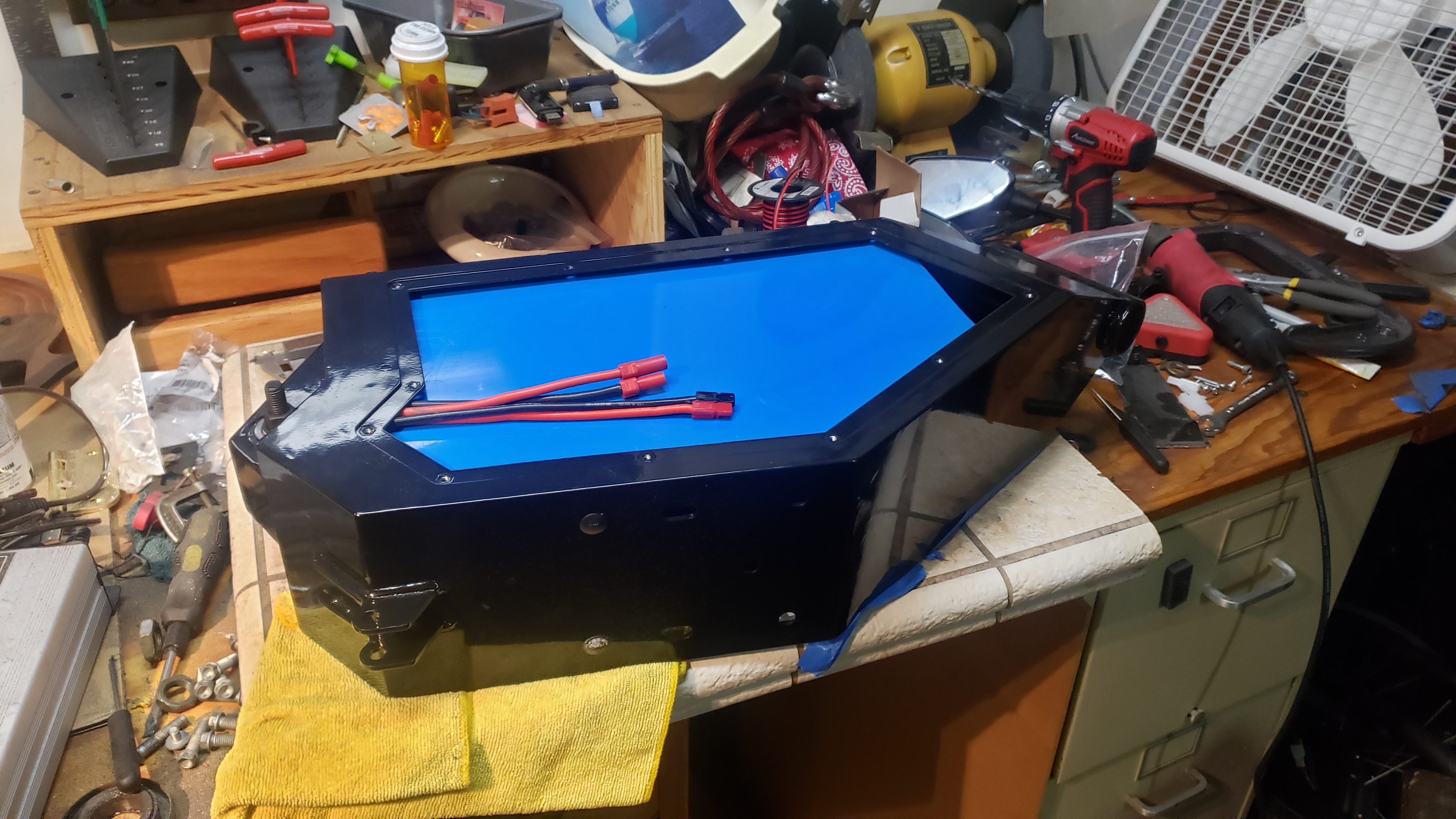

72v70ah battery has a 2 wire BMS and samsung 35E cells. 100A continuous rating, 400A peak, though the cells should never exceed 260A. Charge rate should be good at 30A, maximum 40A.

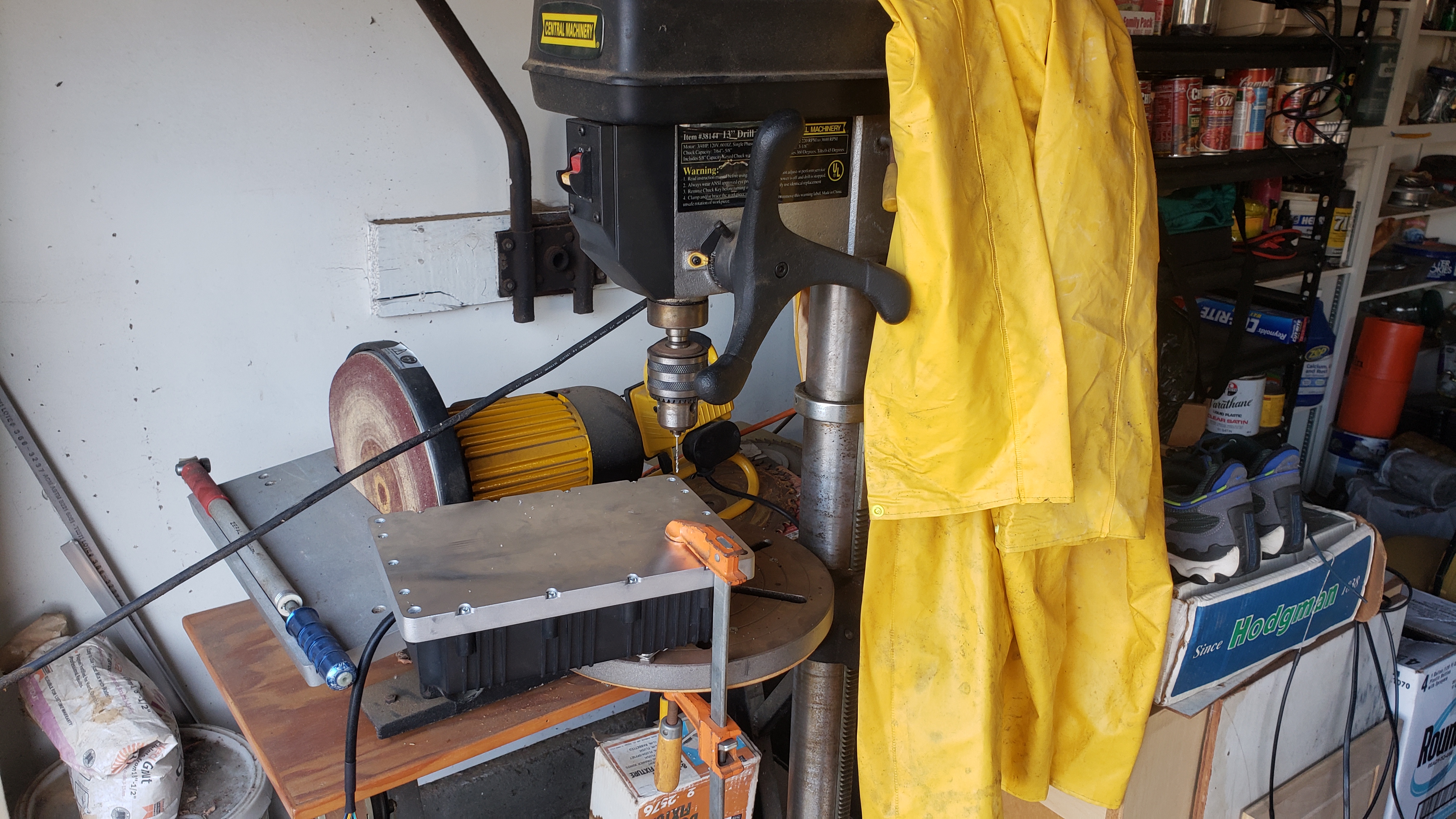

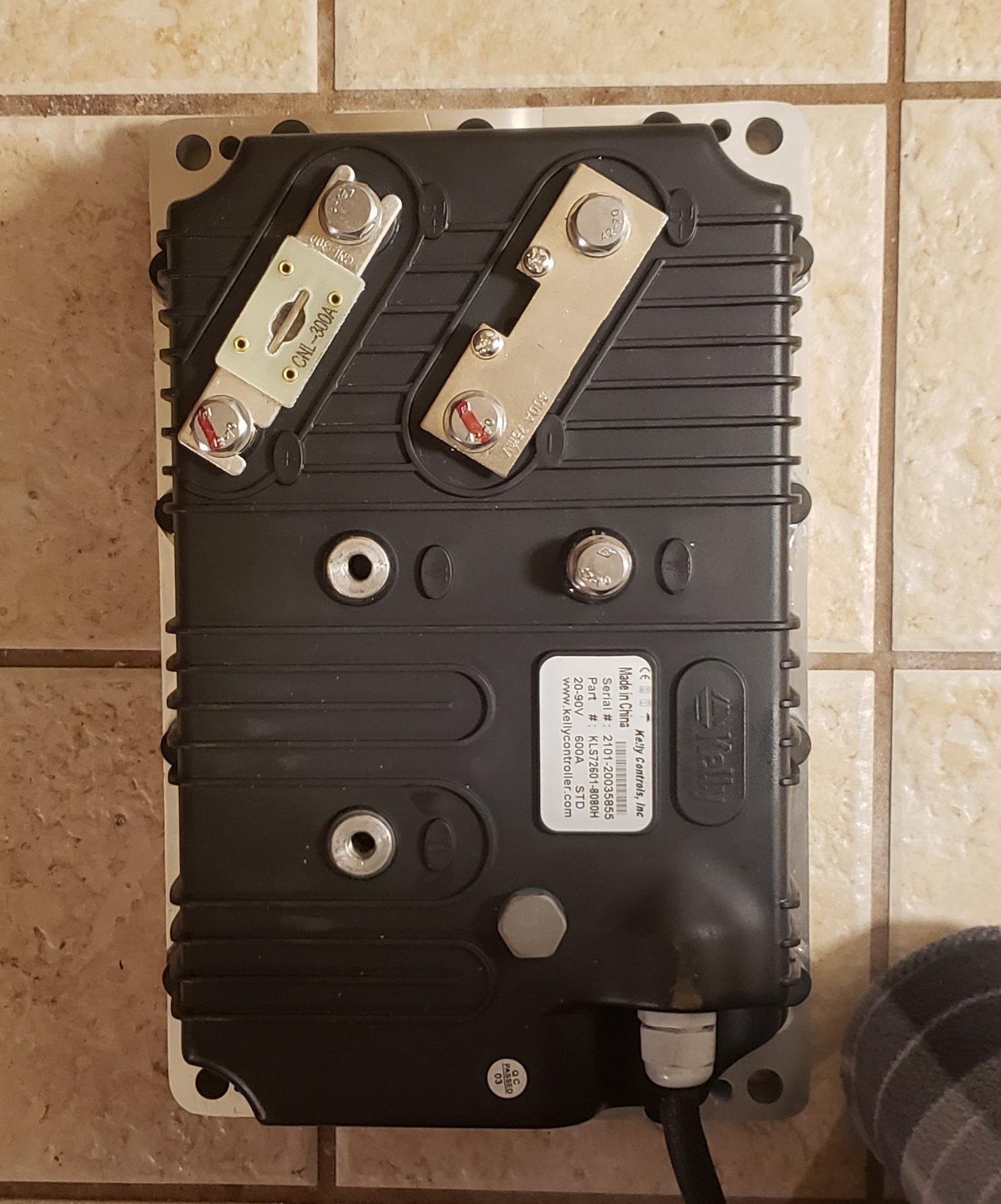

The kelly 8080h is massive.. base plate is like 2cm solid aluminium lol.

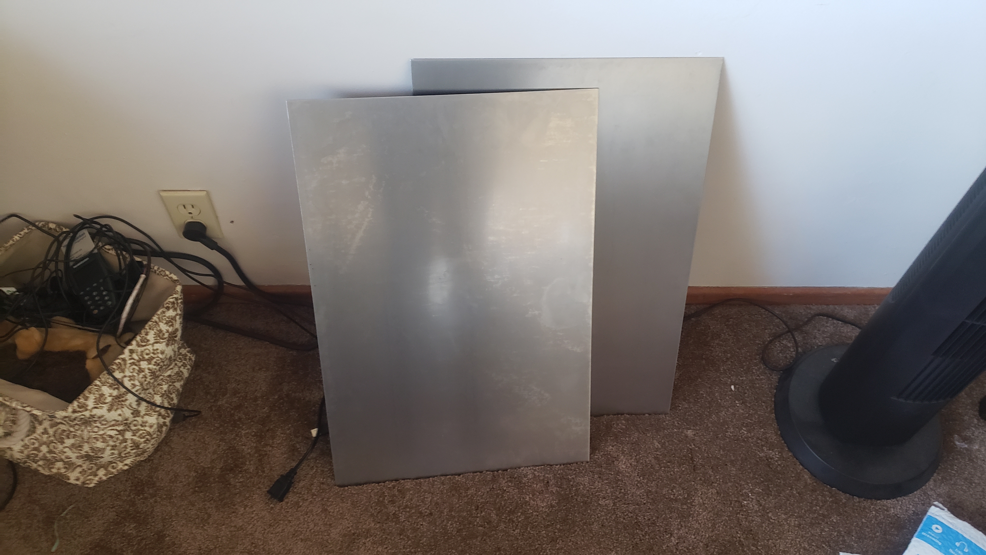

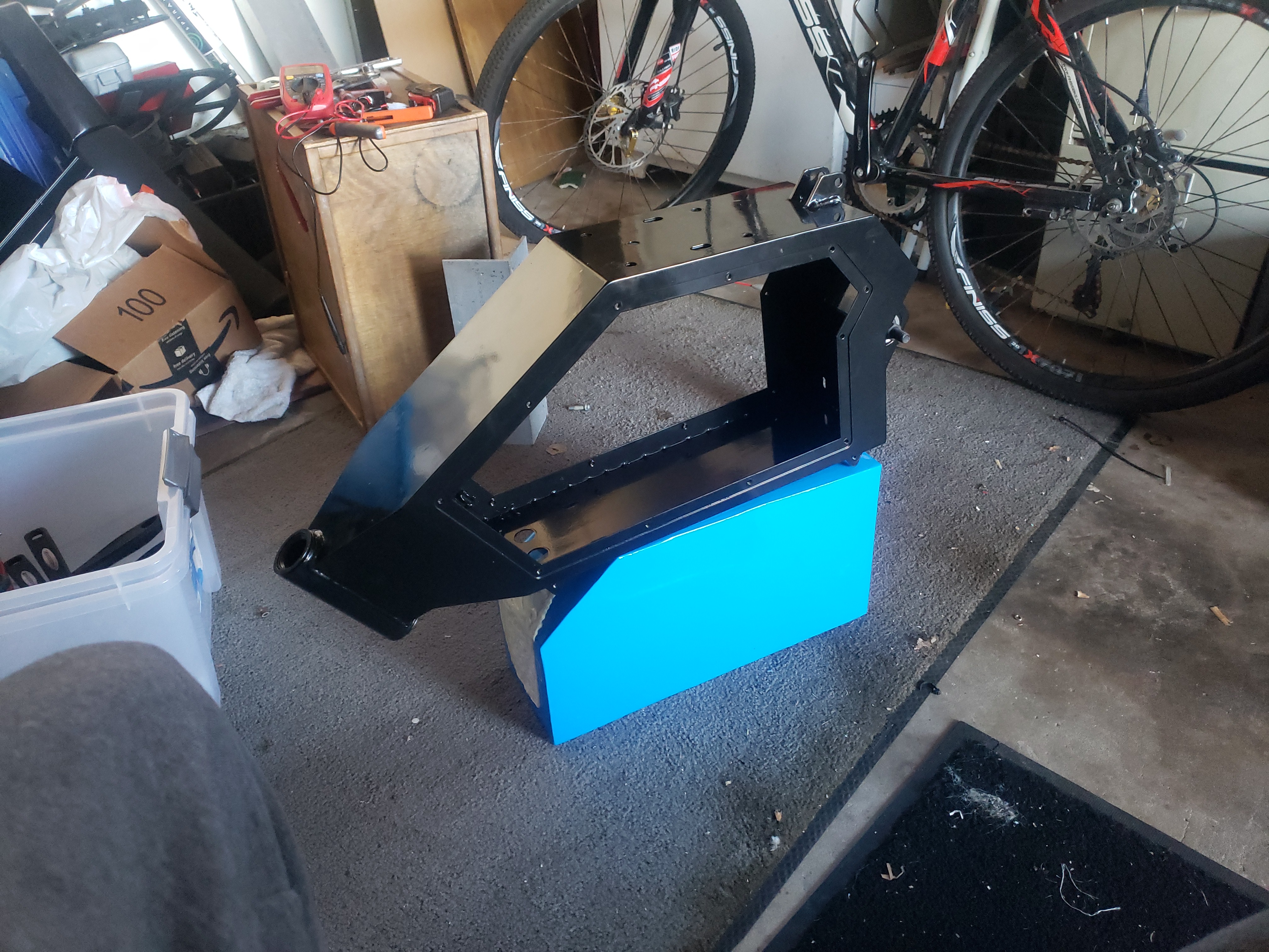

14g steel sheets came in, dropped em off at my miller today. Those things do not bend!

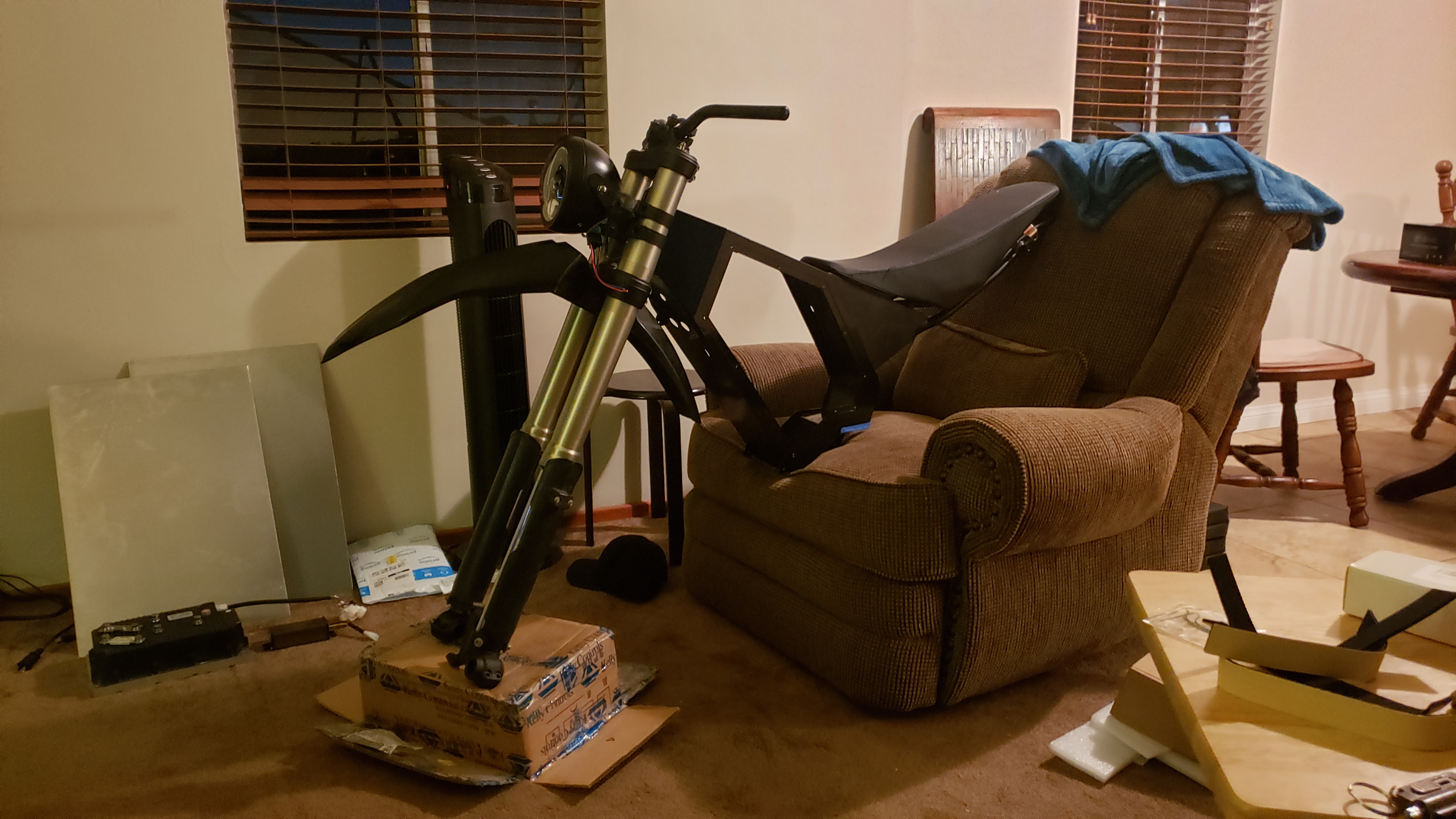

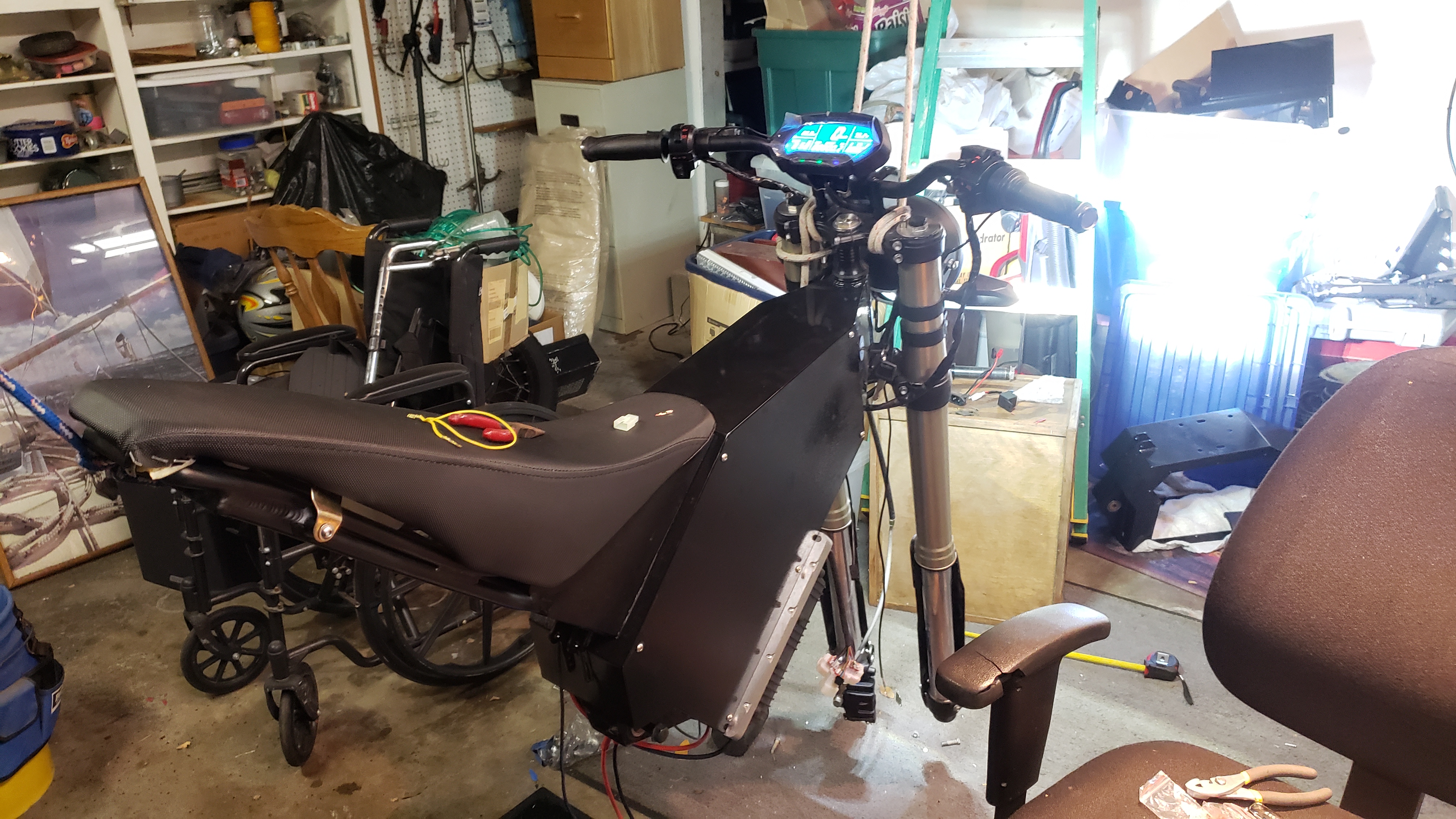

Got the headlight housing and headlight all on, and got the seat mounted.
Gonna be out of town for a few days, when I'm back I'll make a little mounting bracket for the controller.

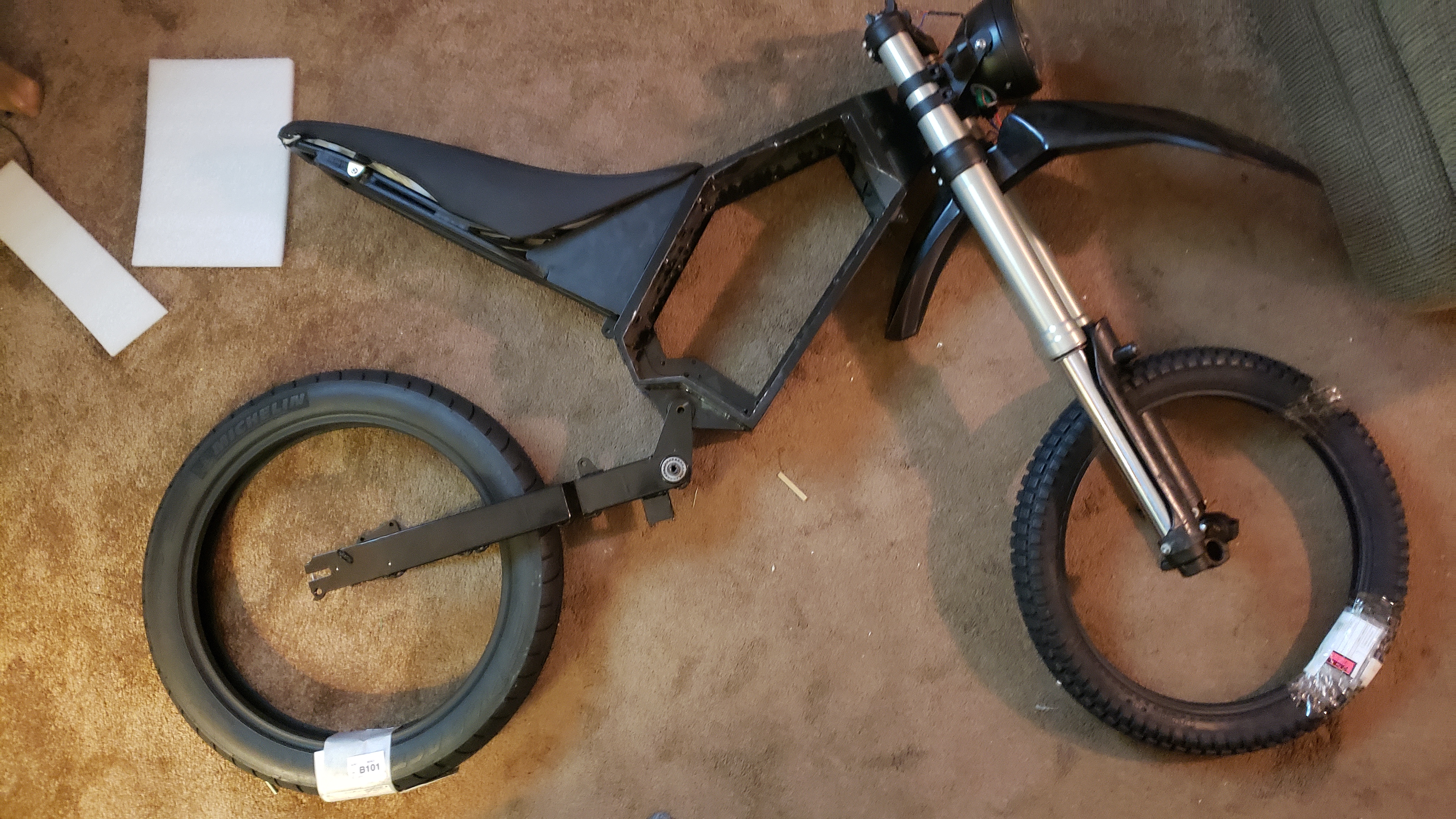

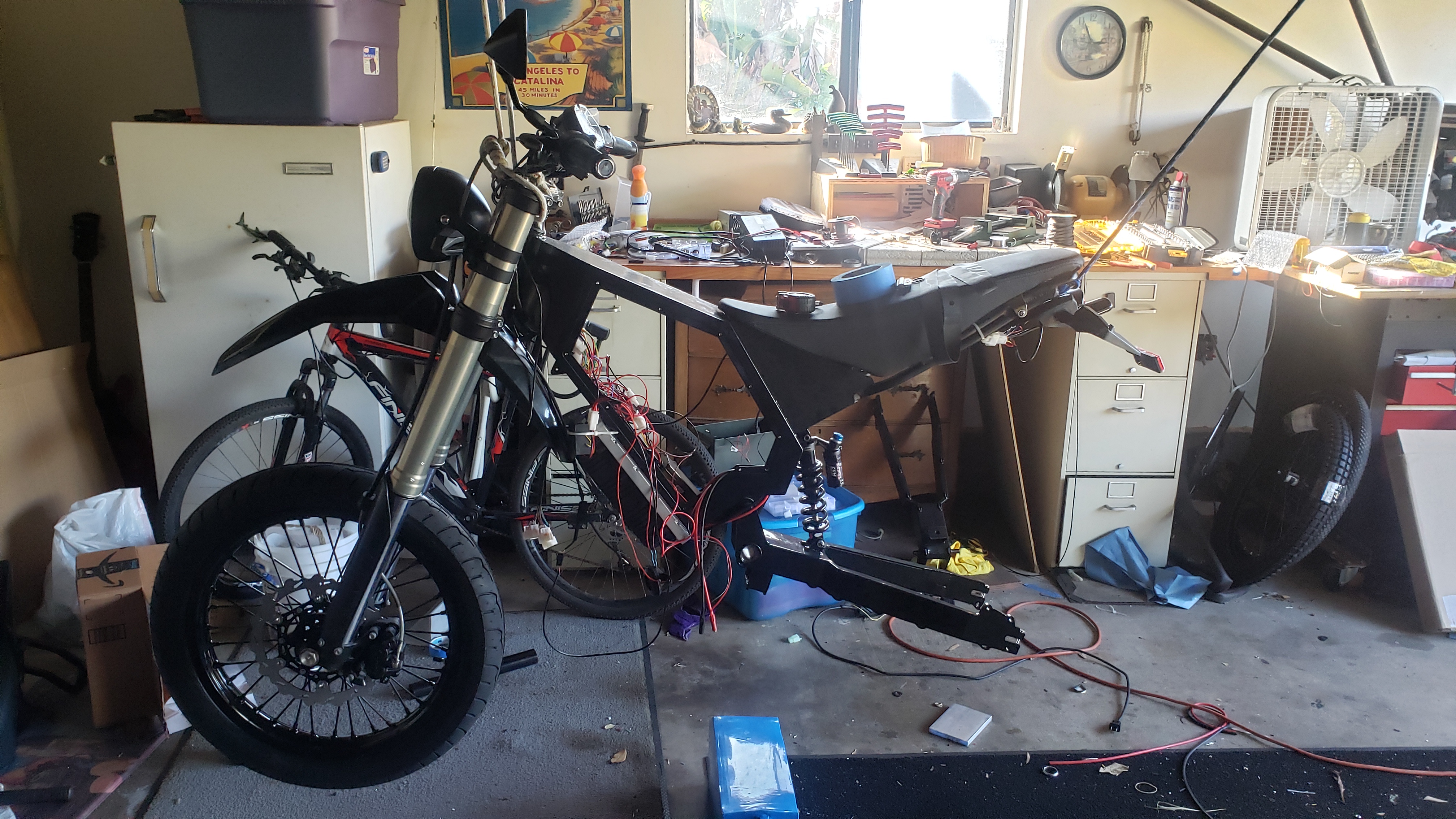

Got some work done today. The seat is mounted, the shape of the bike will end up something like this:
(Gonna go with the michelin touring tire in front too, just waiting on an order)
I used a drill press on the base plate of the 8080h to make some new mounting holes to barely fit it on the bomber frame without having to make a bracket.

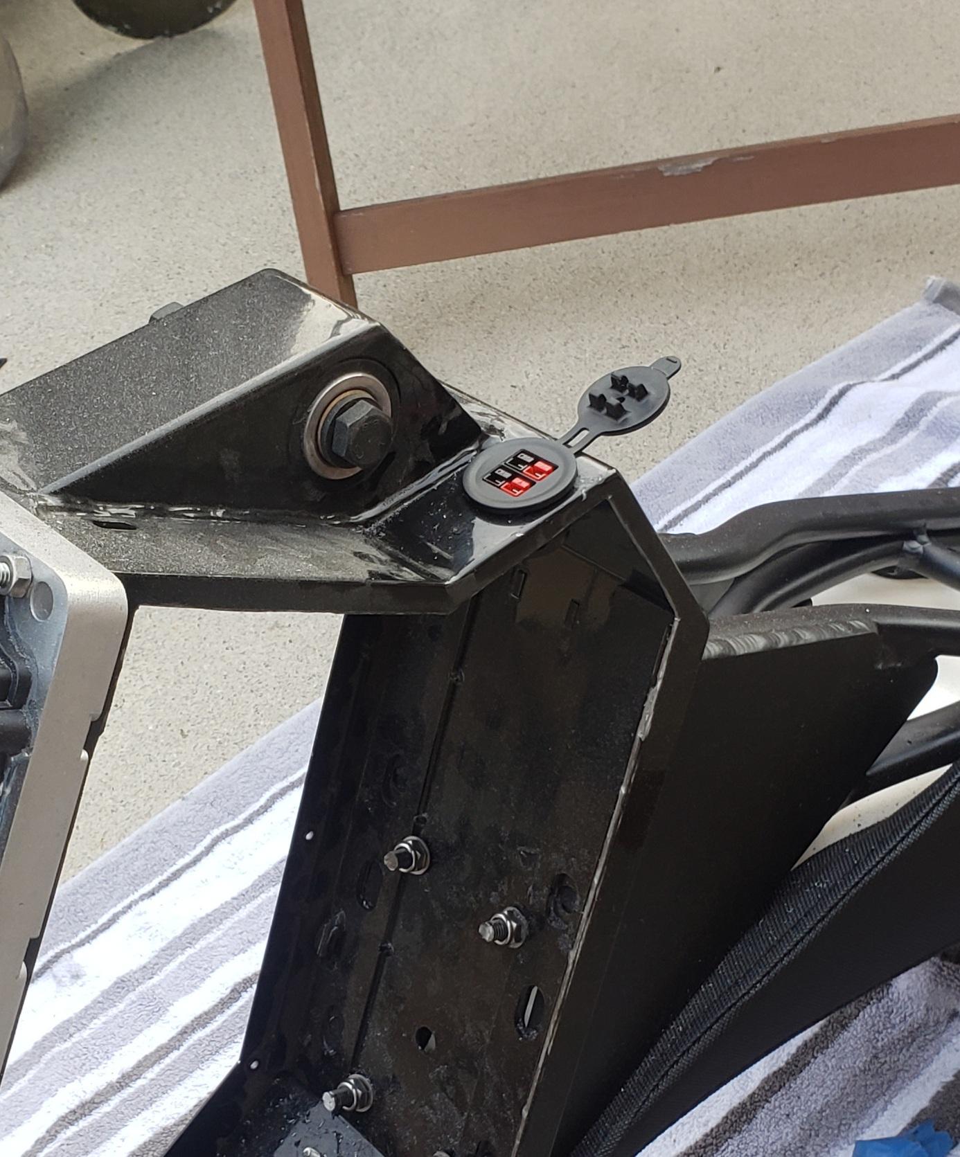

I also carved in a hole for an anderson powerpole charging port with a little waterproof lid:

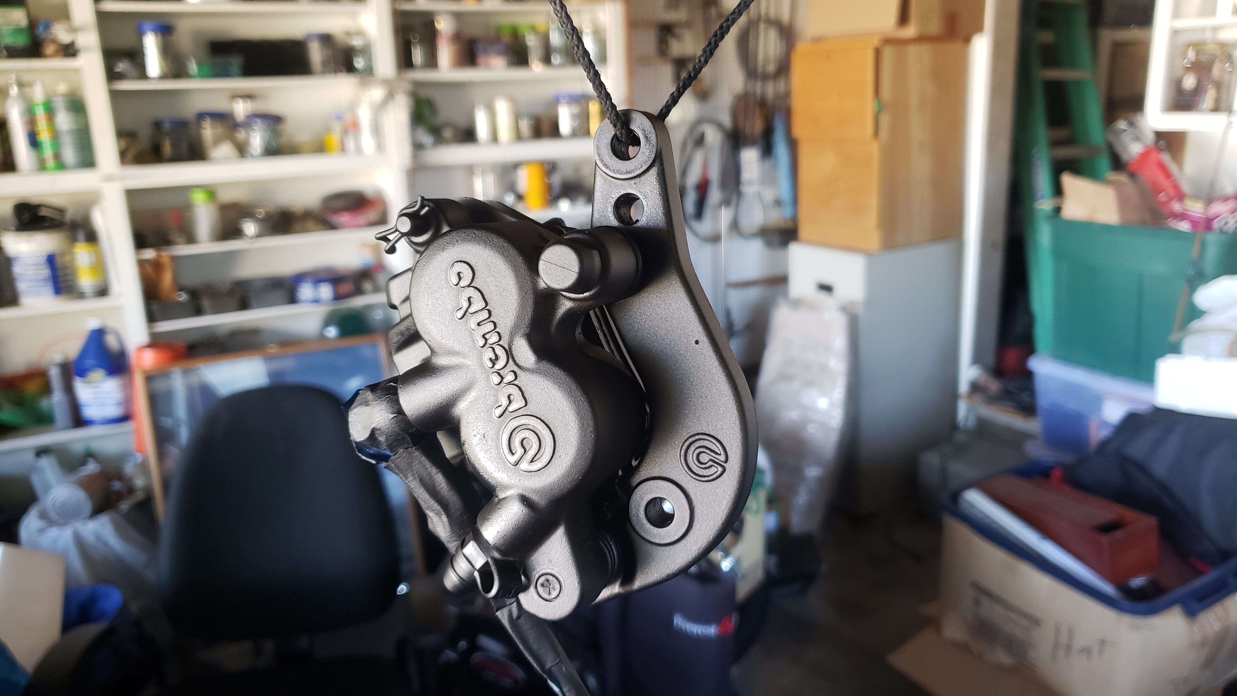

I also took the liberty to repaint the brake calliper. Will probably repaint the lever/reservoir later.

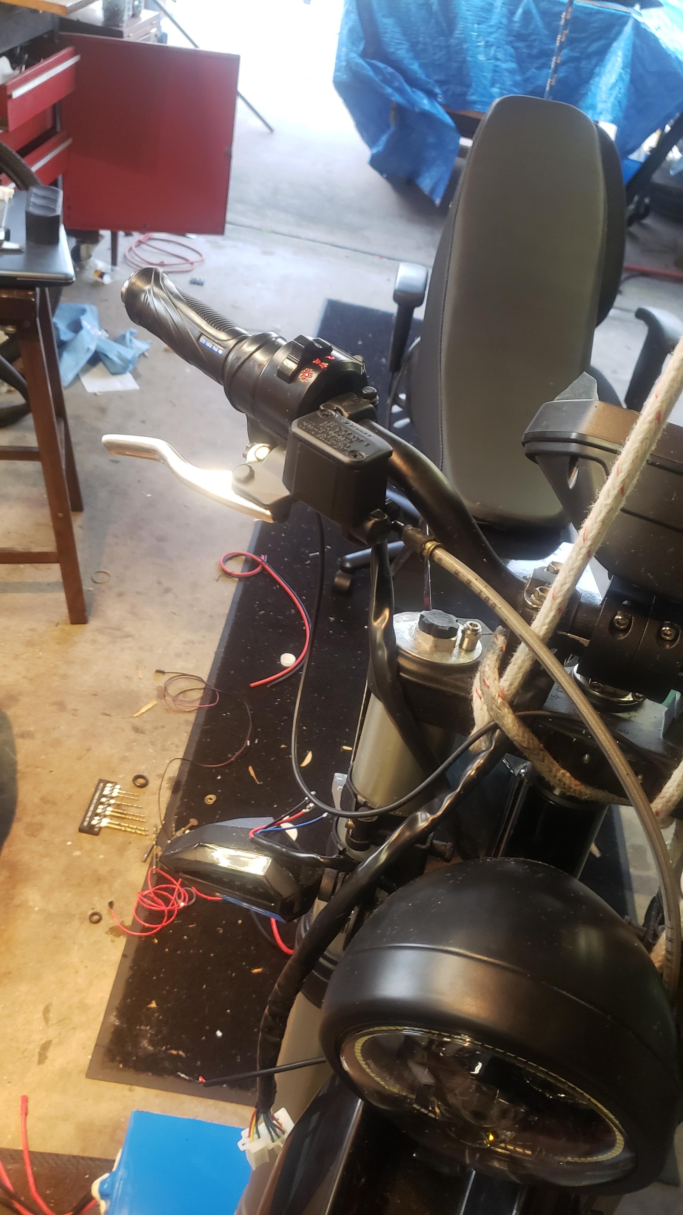

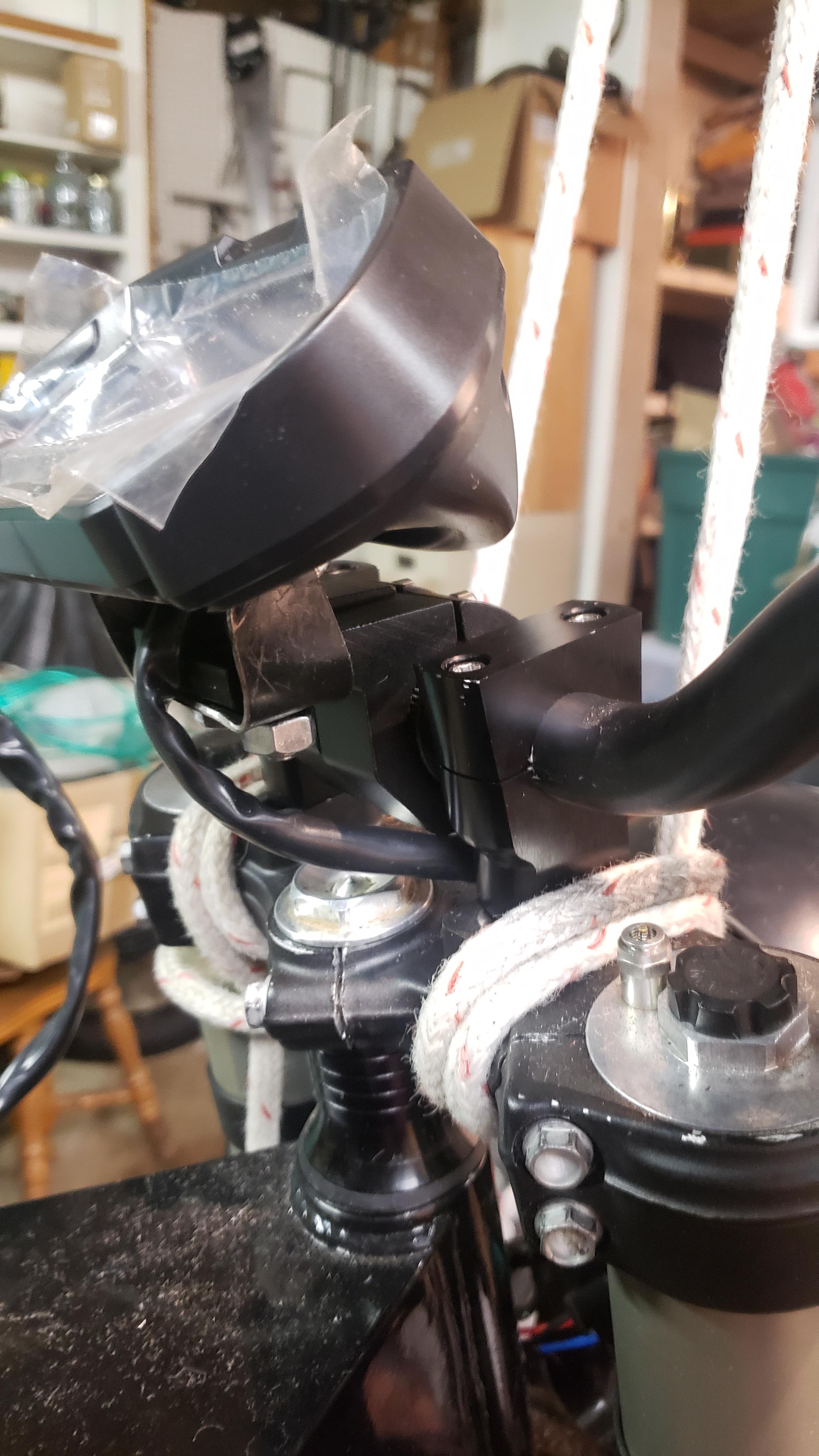

The CT-22 dashboard arrived but has two bolts coming out the back of it, no clear way to mount. Might need to carve some aluminium strips for it.

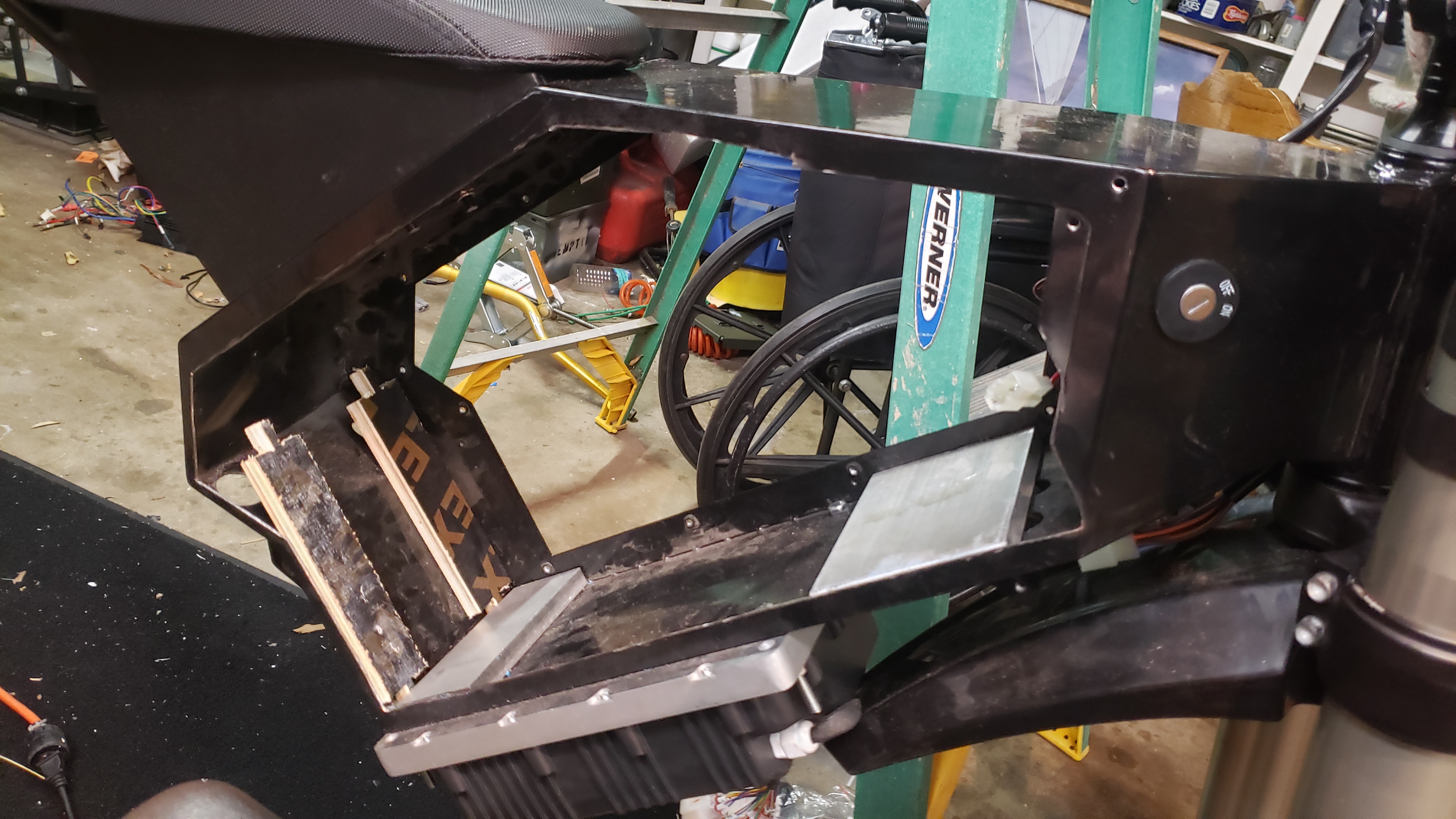

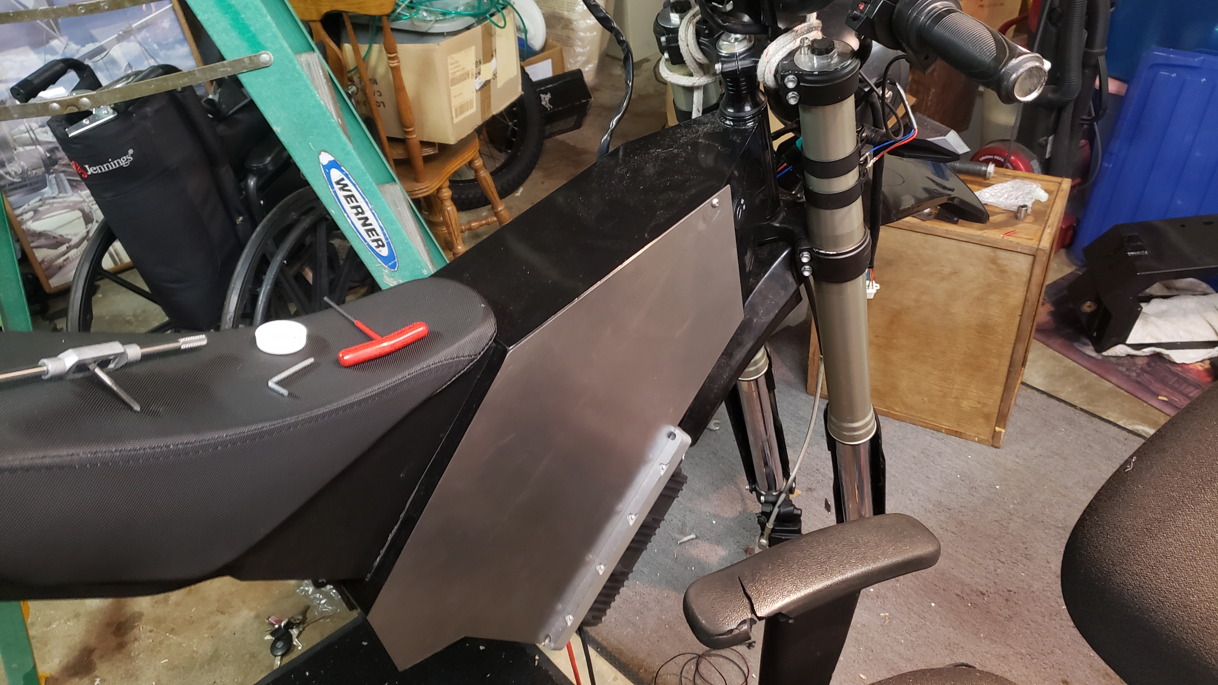

litespeed said:
Will you be able to bolt the side covers on without the bolts rubbing the battery?
Use shorter bolts. ;)
If you can't, then add "caps" inside the frame to cover the holes so when you hit them you know to stop, and then use stacked washers to take up the rest of the space between bolt head and outer face of cover/
Glad you asked. Yeah the way it's set up, the battery slides in like a child's puzzle, then the sidewall bolts in around the outside of the battery.
Spacers (aluminium/wood blocks) will keep the battery out of the pockets.
I had a battery fire on a soft cell lifepo4 using a bomber frame a few years ago, so I definitely keep em outta the way of the sidewall bolts now.
My miller also carved the sidewall, it's almost perfect.
I'll finish tapping the bolt holes tomorrow and paint the sidewall, and start on more wiring. Main battery wires are cut and soldered to XT150s.
Also I bent a little steel strip to make an adapter to fit the dashboard.

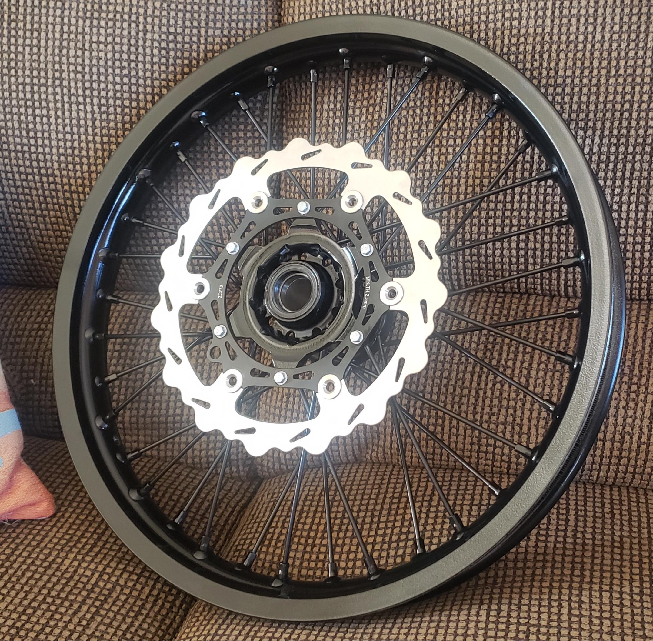

Front wheel came out great. Three coats of paint ended up perfect.

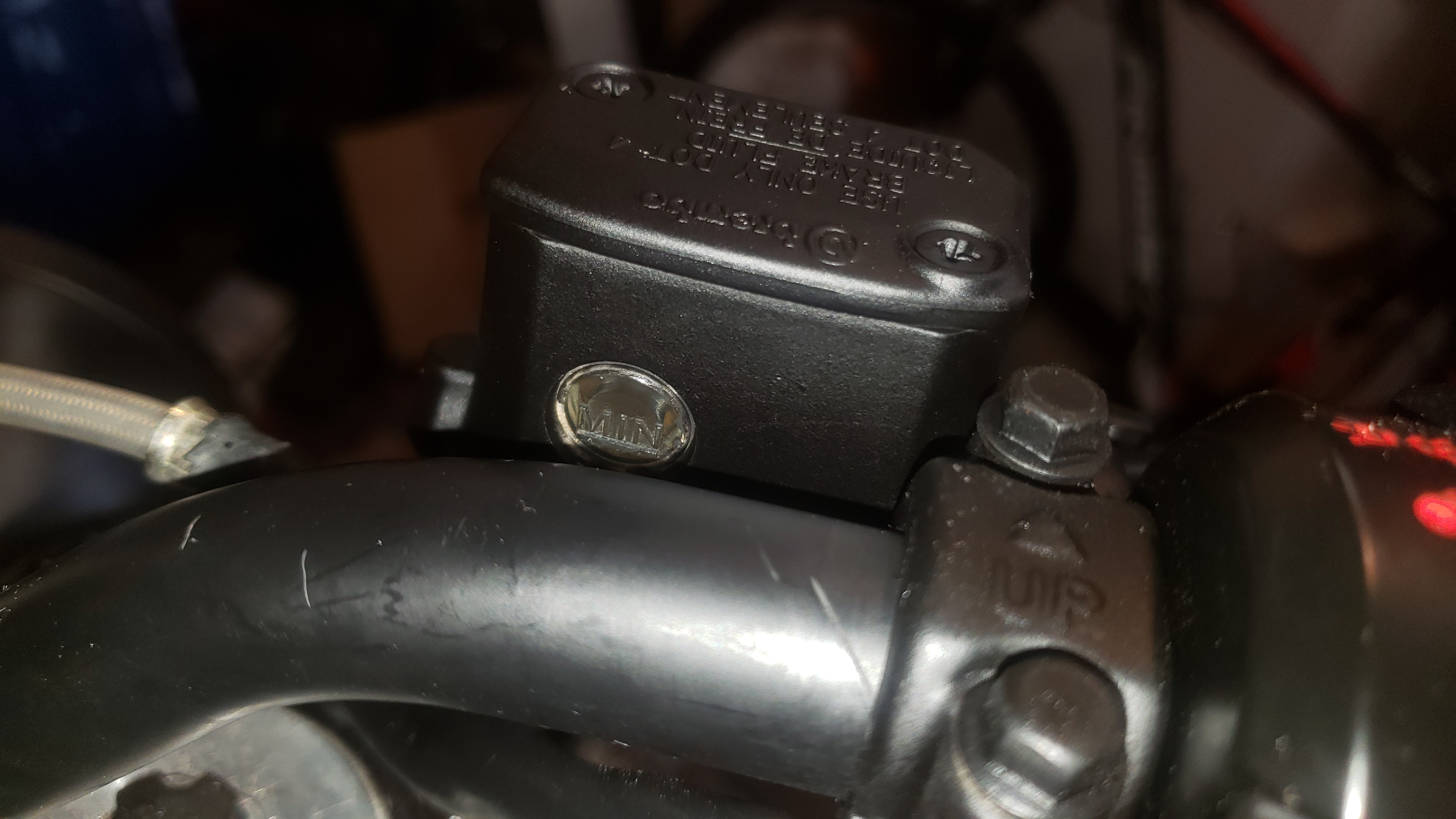

I converted the brake levers to have a brakelight signal using some magnet kits on Amazon.

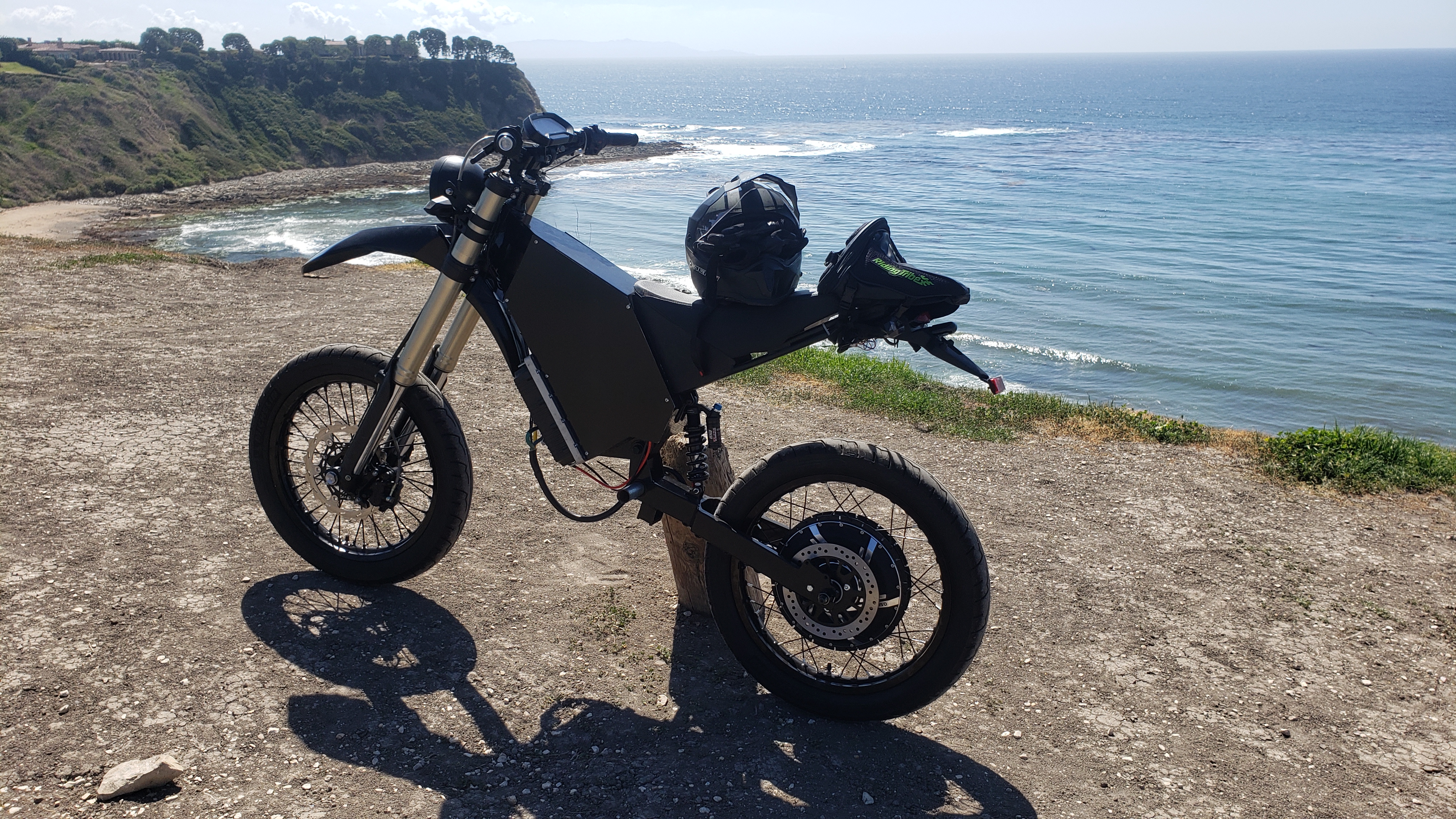

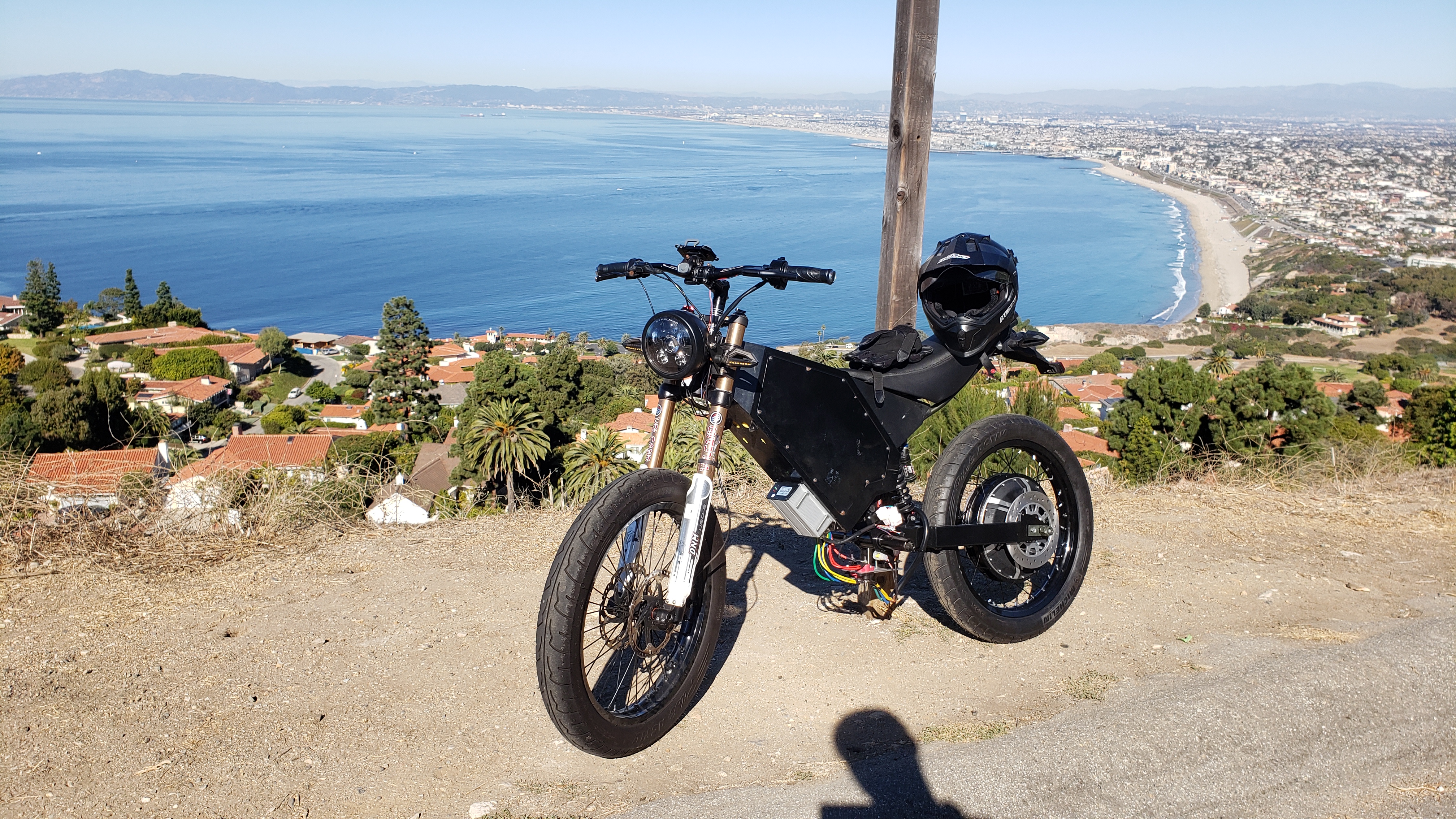

Well boys, it's on the road!

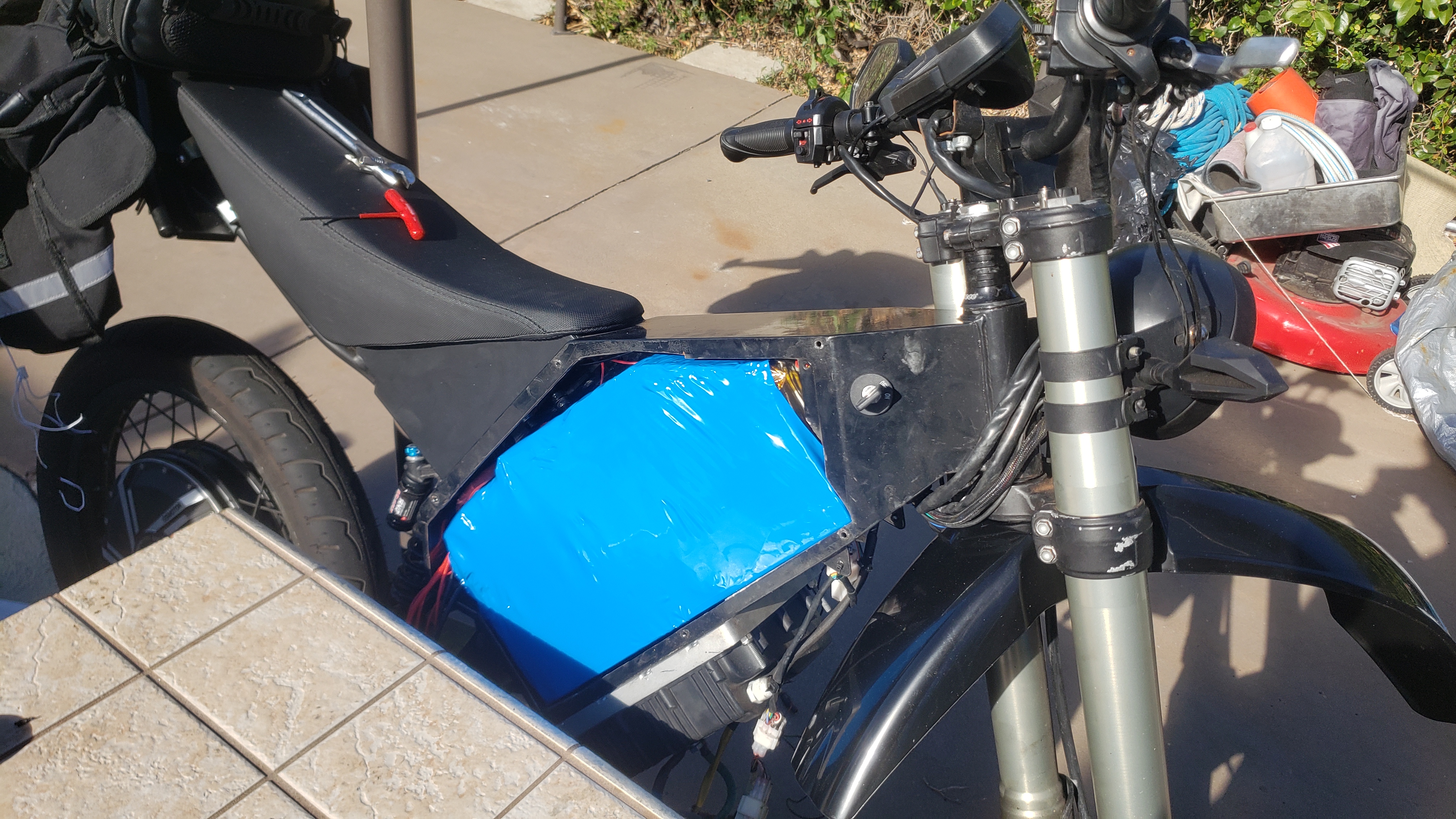

The battery fitment is hilarious. You cannot say I did not maximise space here. Wiring completely stuffed into the front of the bike.
The torque is absolutely nuts and I even limited phase amps to 300. I skipped the "self learning" motor calibration on my last build (on the kelly controller), might have been a reason I was not experiencing torque like this. At 150 phase amps, the front end lifts off the ground. Absolutely nuts.
I rode around quite a bit today. At 110km, my voltage read 76.6v, implying I used 35% battery to go 110km, averaging around 70kmph (43mph). This included riding up and down a mountain. So city range looking to be around 300km? I wasn't even being careful on the throttle. Very surprised.
I still have more testing to do on top speed. I have battery amps set to 90A atm and was fighting strong wind but managed just over 100kmph.
On a side note, suspension and braking are god tier compared to my last build. The regen braking is more than enough stopping power already, but you combine that with the 270mm front moto brake and you can stop practically instantly. The 850lb coil version of the dnm RCP shock is handling the 273 very well.

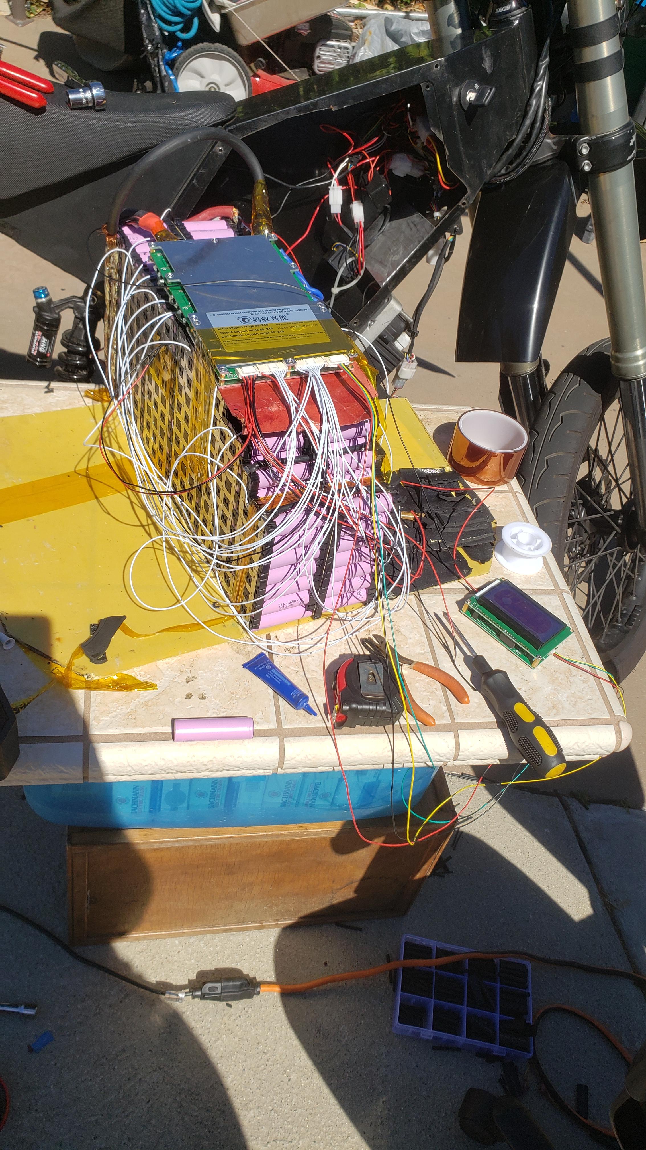

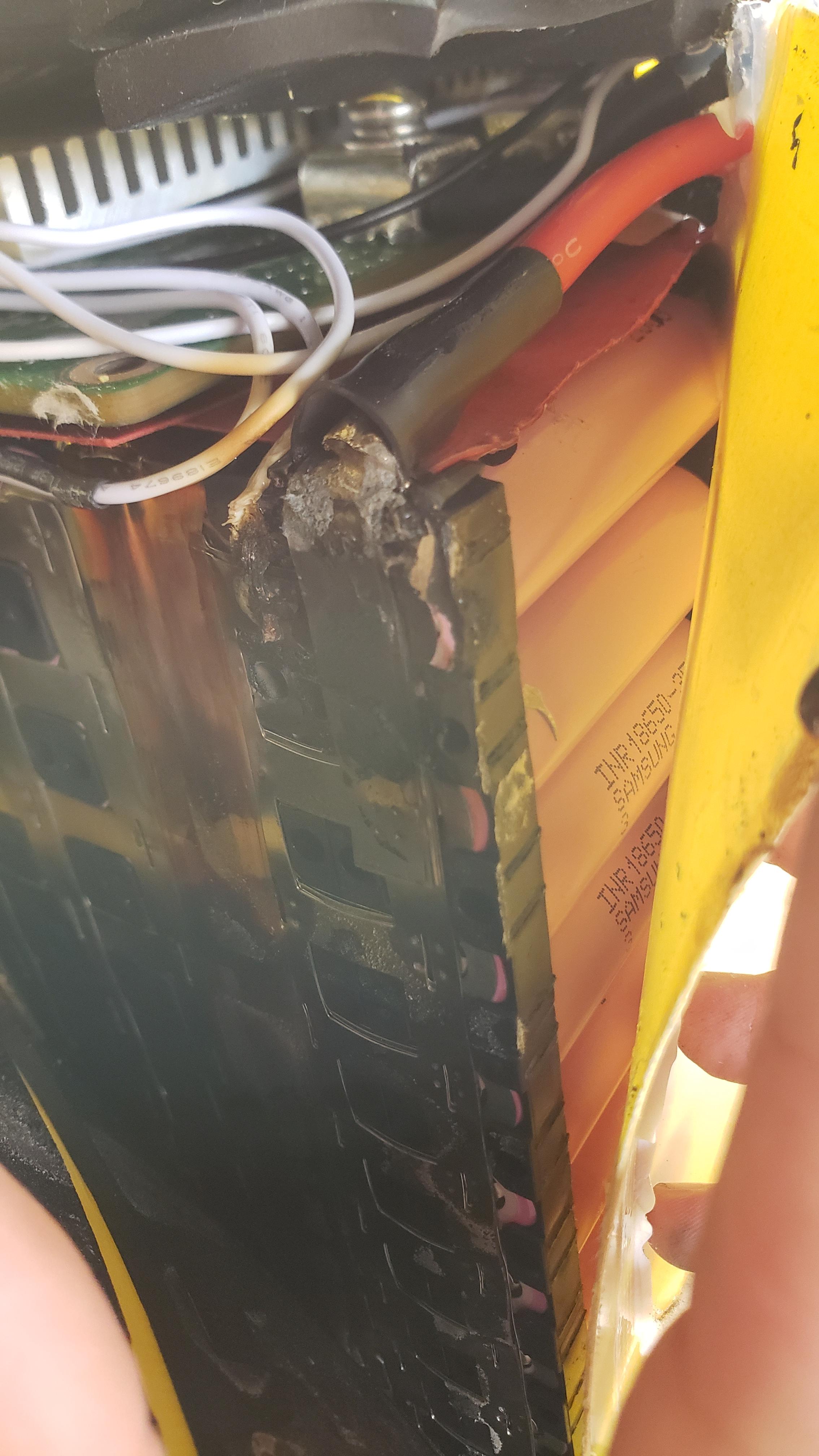

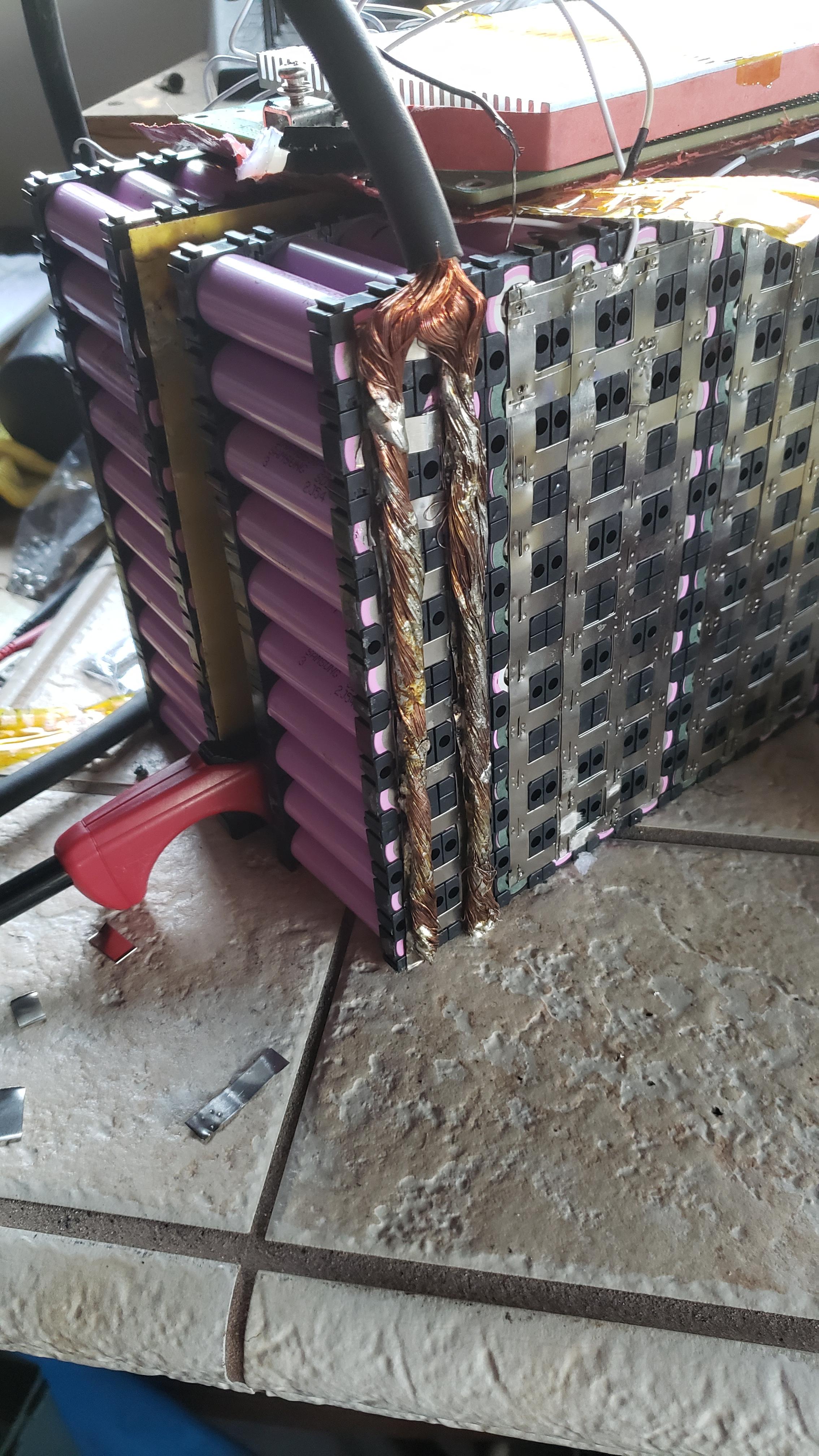

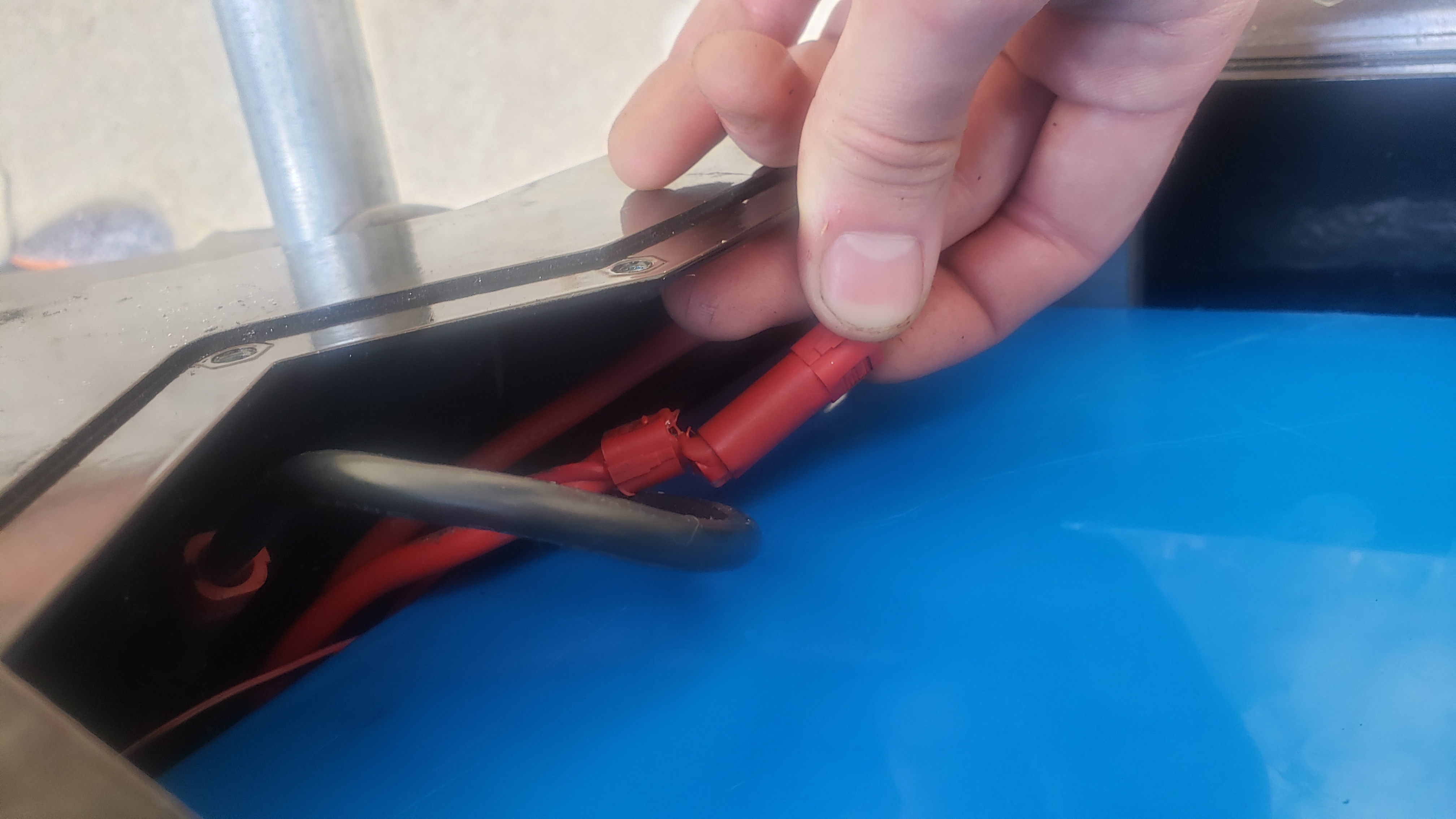

Just an update on this rig: I heavily do not recommend using Unit Pack Power for larger battery packs.
They used 8awg on the main terminals for a 100A battery. 8awg can technically handle 100A........ but at 200°c.
So first issue was my XT150 connectors completely melted with a 90A limit set going up a mountain highway at 100kmph for about 10 min. This was on the CA-60 highway where there is no shoulder and you're locked in by concrete walls. Near death experience, semi trucks going 110kmph less than a meter in front of me while I was sidled against the wall with my bike. Police were the heroes that night, blocking the lane to let me push my 120kg bike up a mountain. I was sore for a few days after that.
To make it back home with limited tools where I was, I did a direct solder to replace the connectors, and here comes the next issue.... that heat now going to the battery's terminal cell group.
Fighting 60-65kmph headwinds trying to leave the coachella valley through the i10, I was again pushing 90A. Should have learned my lesson the first time, because this time, a cell could have (and should have) exploded the way they wired this.
So a truck ride home later, I found out the battery was sizzled, and pry the cell off the positive terminal with a flathead and mallet. Reads 0v. If that doesn't spell out thermal runaway..... man am I lucky the other cells are all okay.
Unfortunately no one wants to work on >60v batteries in my area. So... I got a spot welder and some new 35e's, and some 2awg wire.

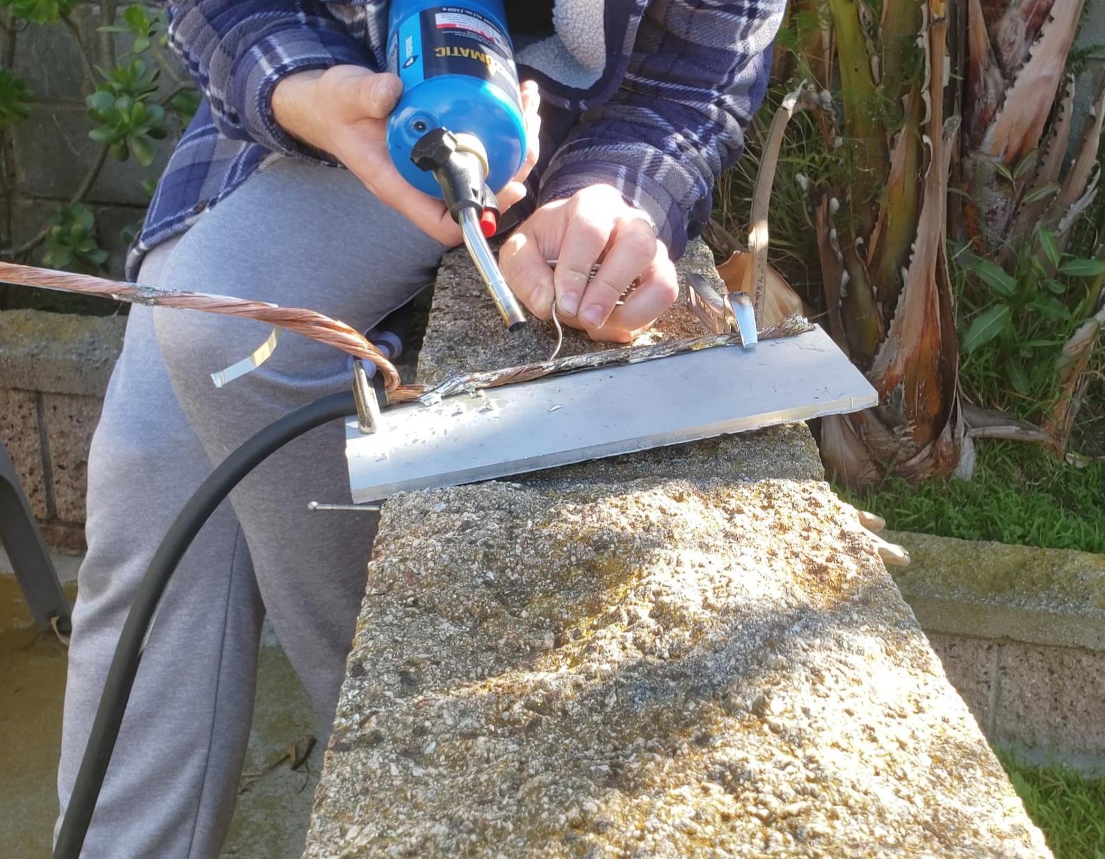

First off I pried off damaged cells, and put in some new 35e's using the spot welder and nickel strips.
Then I started off trying to use a 180w solder gun on the 2awg to solder onto nickel strip and it was not melting into the wire whatsoever. So I stopped by home depot and got a propane blowtorch and MAN that did the trick.
Following a number of good solder joints on a 2-way split on each terminal, I spot welded the nickel strip attached to the 2awg onto the terminal cell group and reduced an awful ~18mOhm resistance down to about 2-3mOhms. For the record, UPP seems to use nickel-coated steel strips, so their resistance isn't very good.
This seemingly should fix the heat issue and I have the battery and bike back up and running. I reduced the awful voltage sag that used to be about 11v drop at 90A down to about 6v, but I still feel like that is pretty high, so I'll have to check around other parts of the battery later.
Crazy how I trust myself with 0 battery building experience over this company that does nothing but build batteries. I guess cost reduction really goes a way in risk management... I'll just build my own batteries from now on.
Be wary of solder in high current connections. It can melt. I've seen battery cable connected to terminal lugs with solder pellets pull out when resistance somewhere caused them to heat up beyond the solder melting point. It's better to have a mechanical connections like hydraulic crimps, screw terminals (like your main electric panel), or I suppose welded since the failure temp is much higher....
That said, I'm not sure how you do that with a traditional spot welded pack.
I assume you also looked at the pack B- connections, likely to the BMS?

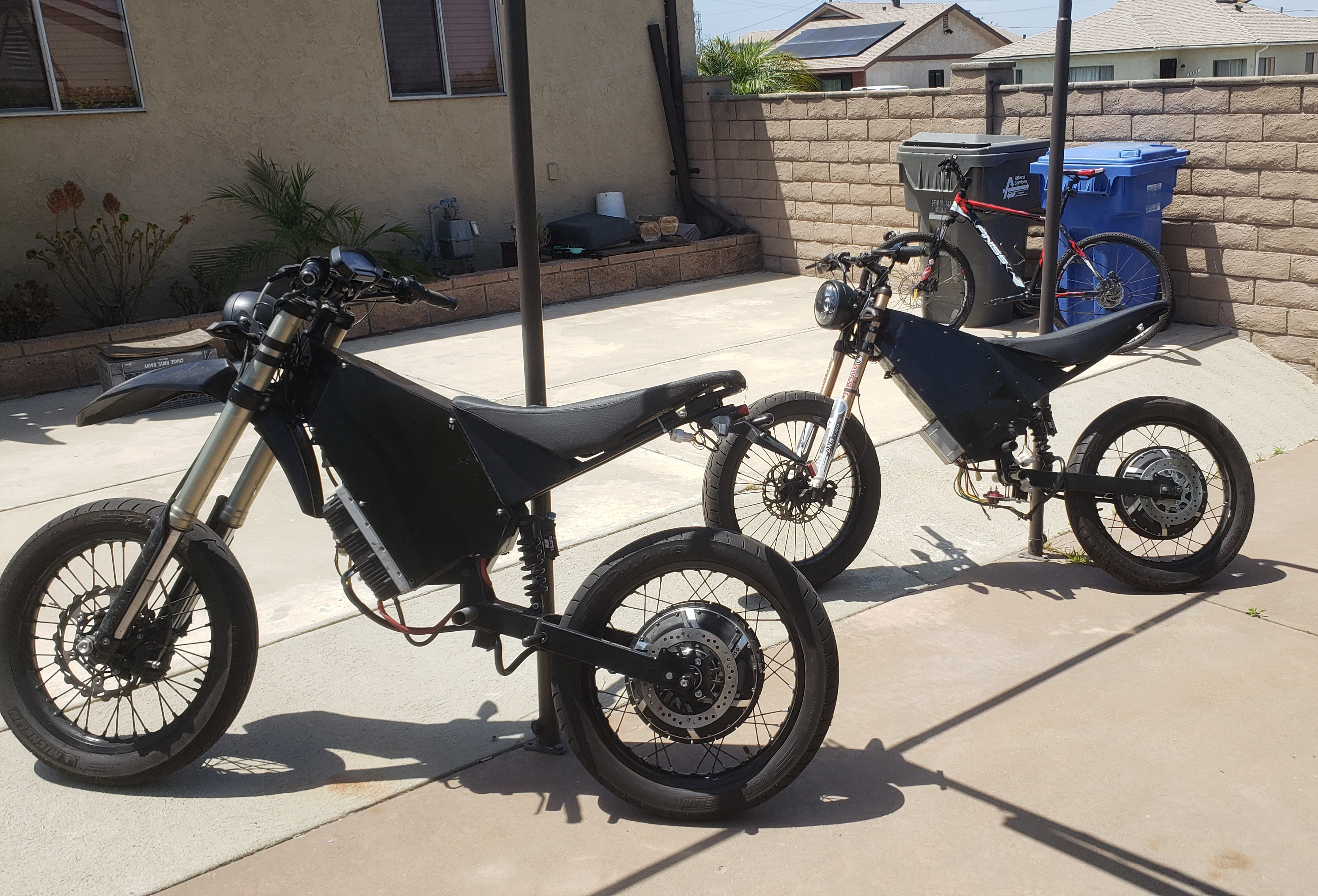

The ending you were all waiting for... I retrieved my stolen bike, six months after it was stolen!
Old bike goes 100kmph max, new bike goes 130kmph max. Love both!

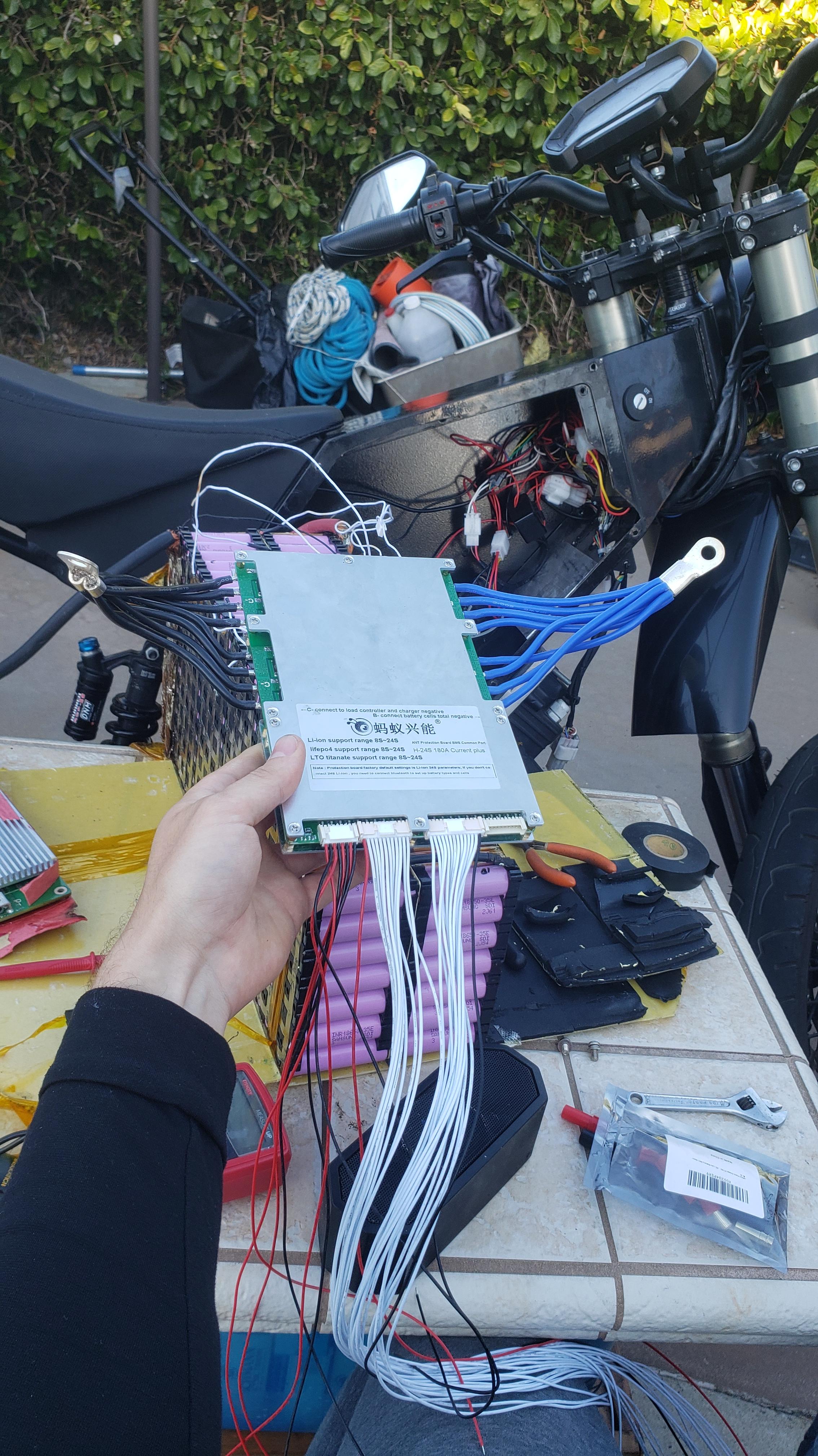

I need to swap whatever garbage BMS UPP put in my battery. I have an ANT 300A BMS with bluetooth but I have to grind off some tabs of the heatsink to make it fit, and resolder some of the wires that hardened widening it. Super tight fit but I think I will make it fit soon. I have a good feeling the majority of my voltage sag is coming from that garbage BMS, we'll find out.

So about a week ago I did the biggest ugprade, and most needed one since the beginning: I swapped whatever garbage BMS was being used from when UPP built the battery, and re-wired a smart ANT bluetooth BMS.
The old BMS was very barebones. It only had balance wires and I guess monitored its own mosfet temp and current.
It was quite a lot of work to get that to barely fit, but now I have 4 different temp probes along the battery and can monitor current, cell group voltages, all different temps (mosfets as well), and purposely shut off battery when needed (ie taking off lug connectors - no more spark!)

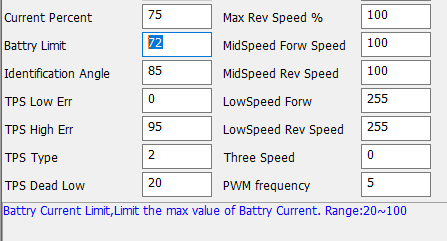

It is also at this point I found out I am pulling a SHIT LOAD of power. I didn't think I was but saw last night 177A max being pulled. Holy hell.
I went into the Kelly KLS software again and there's the battery limit setting here with a very very vague description.
When I first built the bike and had that melted battery wire I had it at 90, thinking 90A. Then found somewhere on this forum it's actually a percentage of the motor nominal current setting, so I tried 72% of 130A for ~94A, but because I had no way to monitor battery amps, I just tried that, and it worked "fine" for the past couple months with very high speeds and such. But I guess I was pulling over 13kW! Jesus Christ.
Today I figured it out, though. It's a percentage of MAX PHASE AMPS. Kelly really really needs to explain this setting, it is important. For me, it's a percentage of 600A. I brought it down to 25%, which is 150 battery amps, and the BMS readings reflect it.

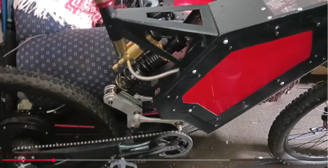

hello can you provide any more info on the fitting of the forks to the frame thanks
Hi i really enjoyed your post and build process, your seat solution is one of the best ive seen if not the best ,all the off the shelf offerings seem to throw the geometrey way out of wack.One thing i found with these frames was the limited swing arm travel and shock options for this design,so thought id share one of my solutions with you ,now has that real long travel feel of trail bike.cheers Kat1.PNG2.PNG
Hi i really enjoyed your post and build process, your seat solution is one of the best ive seen if not the best ,all the off the shelf offerings seem to throw the geometrey way out of wack.One thing i found with these frames was the limited swing arm travel and shock options for this design,so thought id share one of my solutions with you ,now has that real long travel feel of trail bike.cheers KatView attachment 374876View attachment 374877
i designed it so that i could also mount an emoto style seat like yours as well ,but the cops require standard bike seat for dialy riding in sydney australia,we managed to cut out nearly 50% of the original frame weight ,when supplied,heres a link to a video of the whole bike,

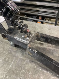

Be careful mounting the rear shock in that section and do an inspection periodically to make sure the sheet metal doesn't bend inward.
I eventually had to weld in thicker steel where the original shock mounted in (both on the frame and the swing arm!) because it was caving in with the 850lb/in coil on the DNM. I had the stiffer coil in there to support a passenger and/or cargo, but I imagine hitting some deep spanned out potholes could also exert a lot of force in that section.
You can see what this build eventually turned into here
