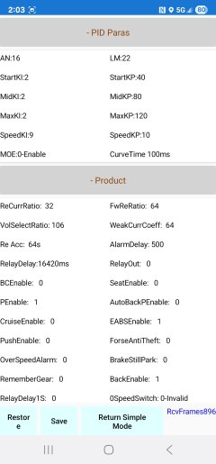

Hi all,
Any Fardriver gurus here? I have a Fardriver ND721200B trying to get it to work with my ME1616. I no the motor has a sine cosine encoder. But I'm not sure what particular encoder setting in the far driver will recognize it. I've got it to where the controller is not giving me any errors but even running the autolearn does not make the motor spin. It will just either or do a light hum. I've tried swapping some of the phase lines with no success. I'm just using low power mode until it spins. Anyone done this combo with any success? I have the 96v Fardriver encoder version also, I'm just trying to get the 72 volt to work before I upgrade my pack. Any help would be great, thanks! Here are my parameters.
