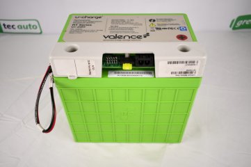

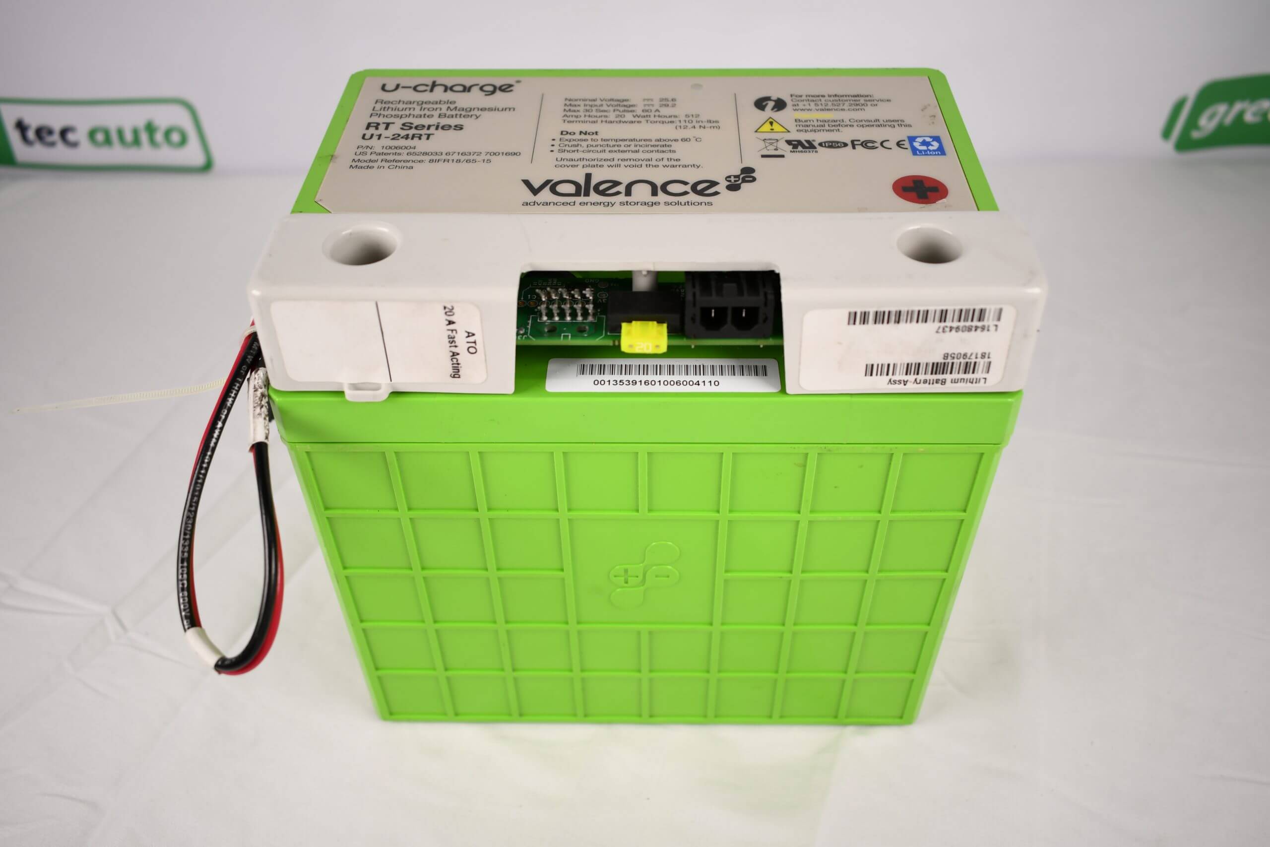

Looking at this:
Data Sheet
Valence-U1-24RT-Rev-3-Data-Sheet-210623
Copy from Data Sheet.
Series connection up to two (2) batteries (48 V)
Yes but how about connecting in parallel? Diode?
  • Valence-U1-24RT-Rev-3-Data-Sheet-210623.pdf
Next question will be. What charger for 2 -24V Lithium Phosphate Batteries wired in parallel?
