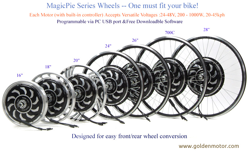

Then understand that every mm of difference between the motor air gap diameter and the wheel diameter reduces the maximum torque you can get from a given width of stator, and that's more important in the equation than wheel mass, by a lot. If torque is the critical value and wheel diameter is fixed, then a motor whose hub shell is also the tire mounting surface is how you maximize torque. That's how dorky little stand-up scooters do it, for good reasons.
Magic Pie 1 from Golden Motor, which is a direct drive motor, can develop 93 Nm of torque. That's mostly due to its diameter. Motors with gear reduction don't need as much diameter, but it still dictates how much torque they can make.
No spokes, tire mounted directly on motor housing, would make it easier to do what you propose. High ratio gear reduction would also help, but only if the gears can withstand the torque you are trying to make.
Powered rear wheels help the front wheels surmount obstacles. That's why some 4WD vehicles can climb steps higher than their front hubs.
Yes I understand the issue with tire diameter and torque. Optimally that 20" wheel would be made for 20x4 tires and have an ~18 inch motor, but it's pretty close. Advertised torque is a little less than required, but for short burts it might work.
