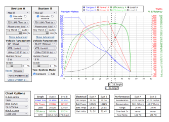

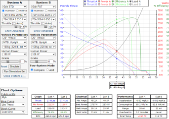

15:1 gearing sounds cool, but realistically... if your geared 750W has 90Nm of wheel torque...
A 12x5 Mxus 3K Turbo has 1.4Nm/A. With powers touching 5kW, and a controller capable of driving high enough phase currents, it could probably out-pull virtually all smaller geared motors, while still remaining usable on the straights, would have much less maintenance and is readily available (and reasonably priced).
It's a bit outside of the specs I mostly spend time looking at, but e.g. Sabvoton ML7260 is spec'd for max 170A of phase currents. If my math is right here, such a setup should theoretically produce ~238Nm at the wheel.
If you can accept a 9.4kg motor in your rear hub, I'd give it a thought.
