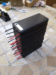

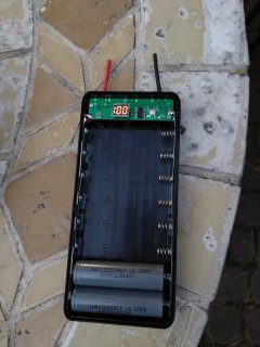

Hi, two weeks ago i was spammed by an ad from Aliexpress and had this sudden idea - build a modular / solderless battery from 18650 power bank boxes. They were sold for less than $3 each, and i thought it might be a good idea to use them just as battery holders at that price - so i ordered 10.

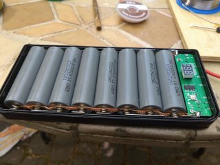

Two days ago they have arrived and i started the build. After inspecting the box I concluded they can still work as power banks, just need to add wires so they can be connected in series.
Each box can hold eight 18650 cells (one more could be added after throwing away the PCB, but it seems like too much hassle with making another pair of contacts for the extra cell. So i stayed with the original design, with the exception of LEDs that were also included - after removing the LEDs i get nice holes for the wires.
After putting the cells in they will still work as power banks, so there's power level indicator working and USB ports can be used for charging (no idea what to do with these yet).

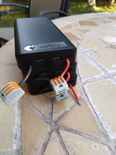

And the plan is to connect everything with WAGO connectors. I'm using 3 way connectors so the third connection can be used for balancing and for the BMS.
The 'bus bars' on the sides seem thick enough for some usable current. I'm worried a bit about the reliability of the spring loaded connections with the cells, but time will tell if they work or not. In case of problems i think these can be improved a little by tinning.
The battery, when finished, will be used to power a lawn mower - there's enough space for 10 boxes, they just need to be fastened somehow to the mower enclosure. I expect the working current to be around 20-25 amps, so it's like 3amp per cell.
The idea behind this build is to have a modular, serviceable battery, where cells can be replaced if any section goes bad. I don't think this would be a good ebike battery, but for the mower it might work.
I'll update you when the thing is ready and put into the mower (some modification on the mower side is needed as well). What do you think, will it work?

There are a lot of solderless batteries out there. It would be wrong to just outright say that all of them won't work. However, you'll always run into the same main 2 issues. First one you pointed out:
3 amps per cell, sure. 3 amps per spring? Not so much. Spring steel is a poor conductor. If you have good calipers, you could measure one section of the spring to find its cross-sectional area, and cross reference it with the carbon steel column in this chart.
If you tin the spring, it'll solidify the spring, which won't be as springy anymore, meaning it won't make as much contact with the cell.
So that's issue #1, finding springs that can also carry decent current. Issue 2 is mechanical reliability of the cells in the enclosure; are they going to pop out mid use? You said lawn mower. That sounds like a lot of bumps and vibrations, and cells falling out of their slots a little.
Having said all that. It's still worth a try, as long as you understand the risks and consequences. Let us know what results you find.

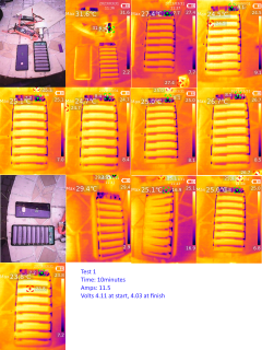

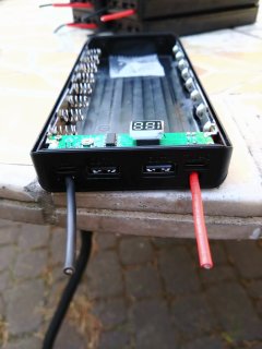

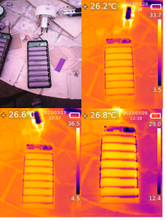

Hi, today i did some experiments with battery under load.
First, i came up with an idea of improving the electric contact at negative terminals - by soldering a copper ribbon (desoldering wick) to the springs and connecting them together. You can see the modification at the first pic.
Unfortunately, i can't really tell if it does anything or not.
Then i ran some load tests by connecting an electric motor. It's a fan from a broken battery vacuum cleaner and for sure it draws above 10 amps - i estimate it's around 15 amp. Can't give you a detailed number because my amp meter has 10A maximum range.
The tests were done in two versions - first with unmodified box (just plain steel springs), second one (thermo2.png) - with the copper strip attached. The motor ran around 2 minutes, and there are 3 thermal pics - first one at start, second - after about 30-40 sec, third - around 90 secs. I was looking for any hot spots on battery connections, but it appears there were none. The warmest part was the motor itself and wires connecting it to the battery.
So i think if the contacts are good for all the cells in the box, it should be able to supply the current i want.
However, one thing worries me a little - the contacts are not that reliable: sometimes a cell loses the connection even if seated firmly in place - then some wiggling around is needed for it to become connected again. Anyway, i will continue and hopefully finish the battery, in the meantime maybe i'll be able to perform some further testing with more current and more detailed measurements.

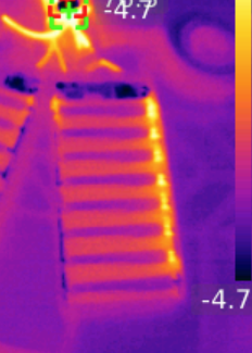

The thermal pictures suggest that in the first test (original springs) the negative terminal contacts were a little warmer than in the second test - so i think the ribbon might make some sense. And more testing, for sure.

My worry is those springs will lose their springiness with heating and cooling cycles.
Just thinking aloud.. could some copper mesh such as a braided sleeve?/solder sucker? or sold as 'stuff-it' soldered to the buss bar and wrapped around/over the springs aid ??..
though loose strands of copper could be a hazard, so perhaps a smear of silicone sealant to fix things in place?? again just thinking aloud so to speak..
yep, this was my idea - you can see copper ribbon soldered to the springs in my second post.
I still need to do some testing of its reliability under heavier load.
And @Guerney, the plan is not to have any heating at springs :)

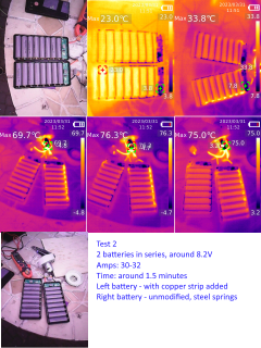

Good day!

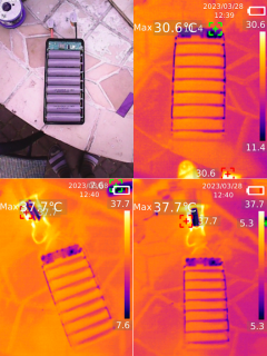

Did two more interesting experiments today, and some conclusions can be made now. As previously, testing with the fan motor from cordless vacuum cleaner.
Test 1: single battery box, ran the motor for about 10 minutes continuously and registered the temperature at 1 minute gaps. The motor drew around 11 - 11.5 amps. No heating was visible on the battery contacts, however some little warming up might be there. I think it can run pretty long with such currents.
And test no. 2 - in this case i connected two batteries in series, which gave around 8.2volts in total. This is twice the voltage motor is rated for - it ran pretty vigorously and the current was about 31 amps. Had to stop the experiment before 2 minutes have passed because the motor started to smoke and disintegrate a little.
One battery box was from the previous test, with the copper strip added at negative terminals. The other was unmodified, with bare steel springs. It can be seen on the thermal pictures that bare springs were heating up pretty fast, while the box with copper braid did not have such hot spots. So for sure there's some benefit in adding the copper strip.
Now i'll add it to every box and hopefully will be able to power the lawn mower. Not planning any other modifications at the moment.

Thanks for the test. My take away:
It seems like you're using the spring not to carry current, but to press copper against the cells. Is this correct? If so, you would only have to watch for vibrations and movement shaking the cells free from their springs.

Did some test today, the mower runs nicely - when idle it consumes around 5-6 amps, but when cutting grass the current goes up to 15-25 amps, depending on how much grass it has taken. On average i think the current is around 12-13 amps. I suppose when bogged down on too much grass it could go above 25amps, but then there's an overcurrent switch in the motor controller that would stop it.
However, the battery is not finished yet - i just connected 10 boxes with Wago connectors, but there's no BMS yet. Looks quite clean so far but have to do something not to turn it into spaghetti when BMS is added (apart from that there doesn't seem to be any space left for the BMS board).
When i have the BMS connected I'll do some more extensive mowing test with temperature measurement. No pictures today but i think everyone has seen a lawn mower with wires.

I bought some copper strip for these kinds of experiments and similar- I'd recommend trying that as a bus bar as opposed to the soldering wick. cheap too. less than five bucks
