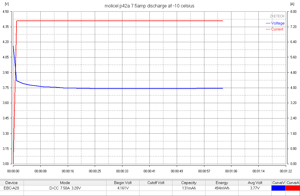

i dont know, im playing with magnets and copper slug tape but the magnets are N42 rated for 80 celsius max working temperature.
the testing im doing is for pack temperatures of 40 celsius with max discharge of 10 amps with plasti dip insulation/waterproofing for marine application
ive had the battery in the freezer fully charged when it went in for 2 days, pulled it out and did a 7.5 amp discharge to 3.2v
heres volt sag
at 3.7v battery temperature was 75f
3.6v was 85f
3.5v was 88f
3.2v was 95f
