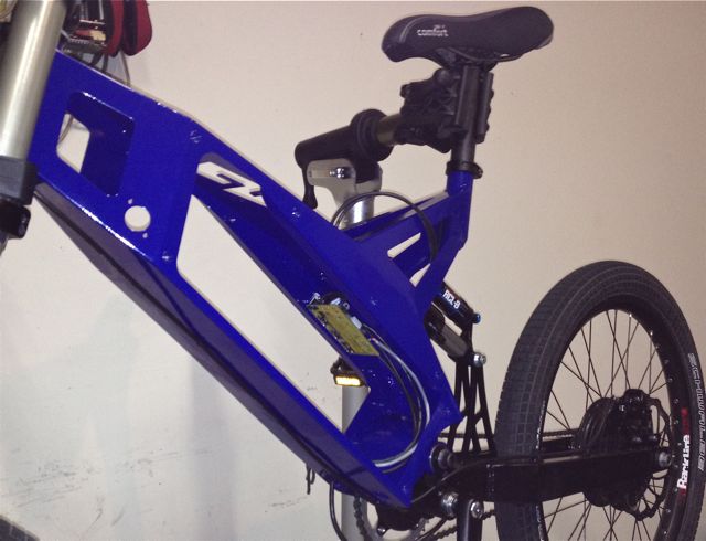

I'm looking at doing a custom frame utilizing the mongoose swing arm with tube for seat, head,Bb shell, suspension bearings and sheet .08inch from here.

Anyway anyone know the sheet thickness I'd need for a fighterish style frame?
I'm thinking .08 inch maby .06 if I can get away with it to save weight. I guess if I did .08 I could shave weight by using lighter side covers. Aluminum or cf 2mm

Go with 2.0mm thick sheets. That will put you around 2.3mm with powder coating. The bulk of my bomber frame is 1.8mm (mic'd number shown with powder coat) with some sections being thicker like the subframe. I think 2.0mm thick would be ideal. The difference between a 1.8mm and 2.0mm thick frame would probably equate to a KG, 2kg tops, with a trellis type design. I am all about over engineering and gladly pay a slight weight penalty for durability and strength.

Good stuff Pend, found out some interesting info, the torques bikes frame is made from 2.3mm thick cromo. It would appear that anything from 2-2.3mm would be strong enough for you home build frame.
Rick
Interesting. Thanks Rick. I was starting to think 1.6mm would be OK. I'll have to consider 2mm I guess. The thing is most bike frames are 1.6mm (I think) and chromo is almost 2 times stronger than steel. Also considering oxy acetelean welding to heat treat as I weld. And don't have to pay someone to TIG.
But yeah I was thinking (and this last crack is verification) that material thickness is less critical than frame design.

Yes, Material thickness is less critical than frame design. Bikes like the Stealth, Phasor, and Torques are what the auto industry would call "unibody" designed. The rigidity of these frames comes from the design, and depend on the side panels being bolted on. Especially true on the narrow by comparison Phasor frame.

Yeah good point. I've been looking at the stealth fighter on Kepler's stealths page. There's a pic where you can see how little frame there is in the middle of the body. 3 bolts on front,3 rear and 3 top are enough to use the side panel for triangulation so there's no parallelogram warping of the frame...
On the stealth design, the middle material that is removed sits along the neutral axis for bending, so material is not needed there for bending, just for torsional stiffness.
The torsional stiffness can be compensated for - put back via internal gussets instead.
Go the thicker Cromo, and make lots of small holes on a flatbed laser. or if you have time for a one off frame, use a drill and diegrinder. This is what Raptor have realised. Pity about the width.
You'll find Mig easier for Cromo.

Thanks for that info. Can you elaberate on what you mean re: torsional stiffness?
I'm thinking the frame can bend at the corners of the battery box area (looking side on). Although the top is triangulated a bit so that can't compress as bad as dead flat sheet.
And bottom will be pulled so flat is OK.
I'm not trying to make a stealth and don't need the volume of frame even of a fighter I believe. I don't want to copy but the stealth frame is a very good example of well thought out engineering and revised from experience design.
I had considered a vertical spine guest thing down the centre of the frame but then that will pass on stress to horizontal sheets and pull on them 90° to their face , so not such great option. 1 side closed and 1 side access panel is appealing.
Also 44mm head tube for 1.5" steer tube headset and bottom bracket on frame with suspension pivot behind it is what I'm thinking. The swing arm is what I'm not sure about. Triangle is strong and easy, single arm is inherently weaker and suspension mount?
Torsional stiffness? Sure. There are two main kinds of loads on the middle battery box.
The first is bending, imagine straddling the bike and pushing forward on the handle bars and back on the seat (or landing a jump). Or vice versa. The top of the box shown in yellow would be lengthened or compressed, and the opposite would happen to the bottom battery box. Along the red line in the middle there would be neither (neutral axis) so you can remove the metal on the side walls with little effect. I've used a square box to simplify.
But for torsional stiffness imagine straddling the bike again and pushing the bars left and the seat right. Or in the pic below imagine twisting one of the red ends clockwise and the other in the opposite direction. Like wringing out a tea towel by twisting it.
Now the missing side panels come into play.
Adding internal gussets such as these rudimentary ones shown in blue can reduce the effect.
A traditional triangular bike frame is actually a really cool thing, it takes a small amount of metal and moves it out from the center of the bike in an efficient package to make a strong structure for the weight. When I designed the top tank in the aluminium bike in my sig, I wanted a bike with 555 or 666 watt hours on board, smaller than a stealth. I blame Kepler for letting me ride his 2Kw bafang fighter :twisted:
And I wanted to harness the good design of existing bikes with a large open triangle. And make it rain/tamper proof from the top.
Putting the battery box into a single inline package like stealth's does simplify the design and fabrication, and can be made big in size because of the number of watt hours being held inside. But if you are going for a smaller battery capacity it can pay to consider a triangular frame again.
Kepler is also a Mech Eng - he can help you with these thoughts about tradeoffs.
There are some good wikipedia entries on load/failure mechanisms and things like thin wall buckling. Worth a cursory glance - easier to handle when you know there isn't an exam at the end. :D
If you use a thinner gauge, one way to prevent thin wall buckling is to use a heavier gauge, find the spots that aren't stressed much under any loading type, and drill the heck out of them. Or use your removable battery covers as stressed members - you'll need good fasteners.
