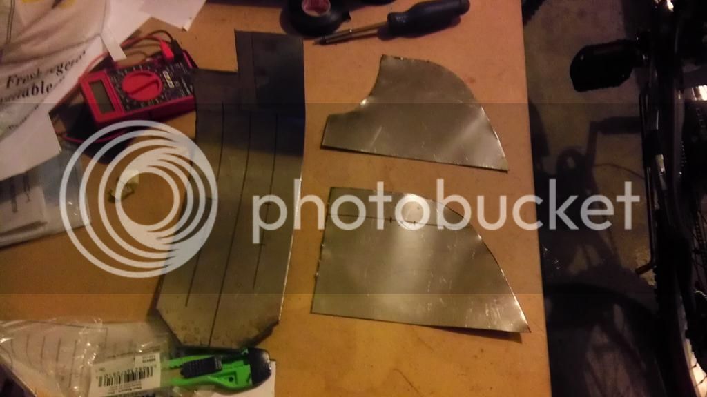

Test pieces for an additional skid plate.
Test fit.
Rear wheel chain tensioners are a must. Because 2 chains are being used the torque applied to each is difference and will cause the axle to move unless a chain tensionaer is used. Also, for the drive chain I used a left threaded freewheel to allow me to freewheel or pedal while the motor is on/off.
